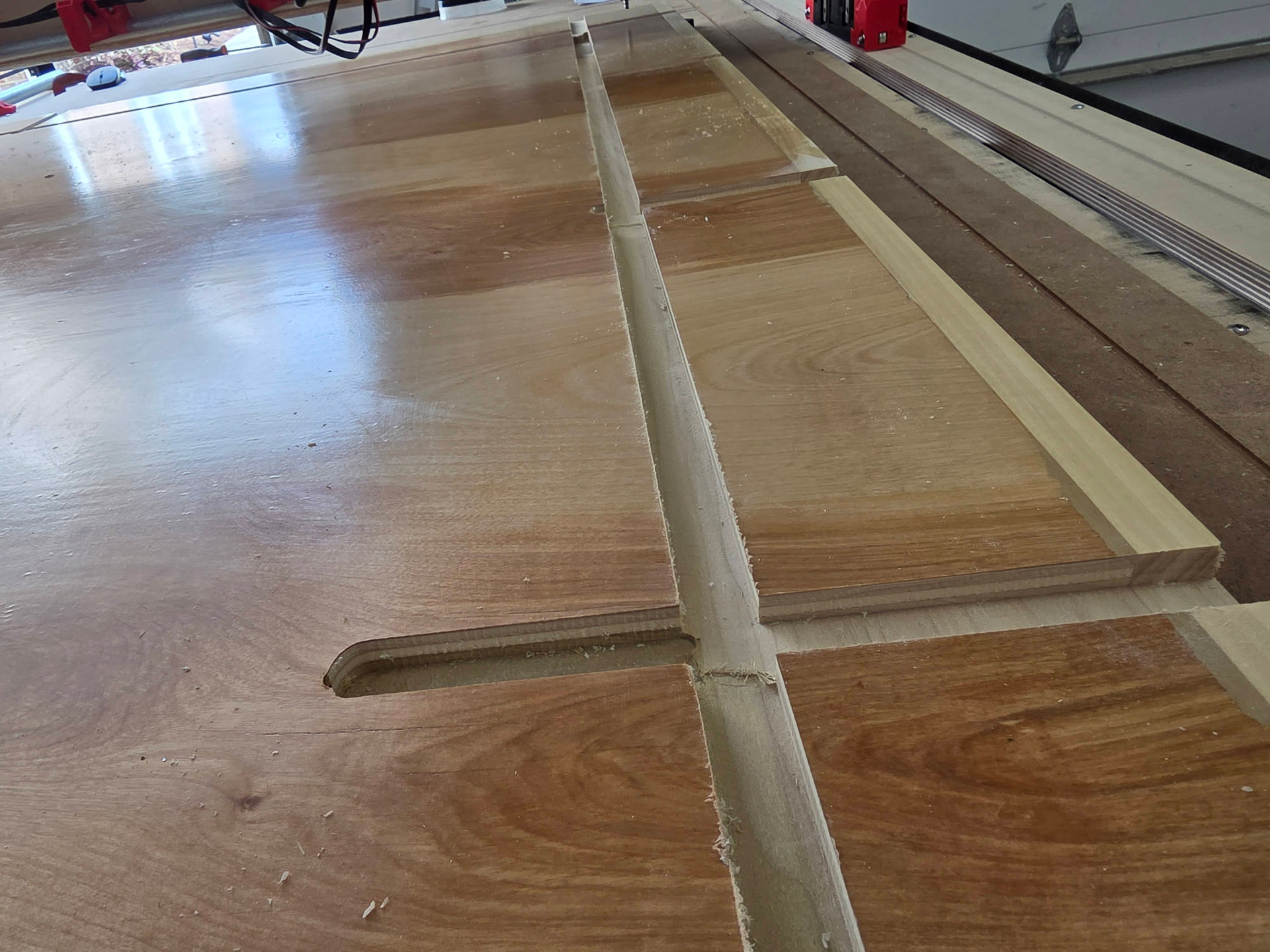

Hey all, back on the forums after a 7 year break with a troubling problem.
I recently bought an LR4 from Northwoods (shout out to @Jonathjon for the great shipping and assembly!) and have fully aligned the machine and done manual jog test cuts to confirm everything is within spec (0.3mm over 4ft).
I just started on my first real cut and have had to stop it 6 times now because at different points in the cut, the z-axis seems to be disabling itself. From my perspective, it looks like zmotor0 is powering down when the gantry is near x0 and this causes the spindle to drop.
But then its trucking right along at that new depth pretty consistently instead of just bombing out…
Not really sure what’s going on, any help is appreciated!
Here’s a list of all the things I’ve checked so far and attached pics, config files:
  • Confirmed Z rail parallel to work surface (modified the motor pull-offs to dial it in, which I assume is the way?)
  • Confirmed tool is not slipping out of chuck
  • Confirmed router is not slipping out of holder
  • Confirmed gcode is not issuing dive commands

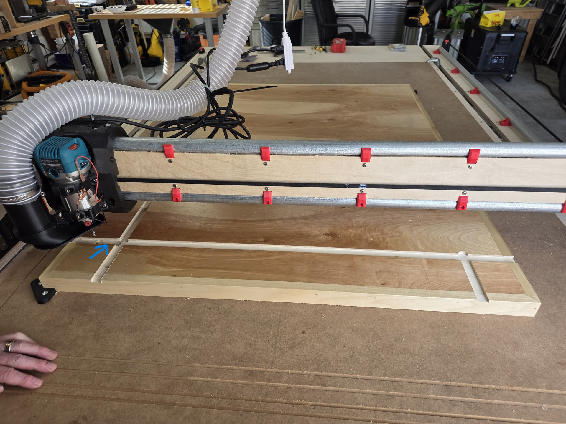

This is a simple two pass adaptive clearing cut @ 5mm each (2000mm/min). Where the blue arrow is, you can see it took a much bigger bite and then seemed to continue to roll with that depth. Feedback still showed it at WposZ: -0.5
I’ve attempted this cut about a dozen times, trying various things (listed above), this attempt (7?), it made it a but further into the program down the side of the board before randomly dropping depth again.

It sounds like the Z stepper motors are skipping steps. Did you lube the lead screws?
I would check and make sure there are no loose connections. Z0 has no extension cable one it, but be sure its didnt come a little loose in shipping at the board. This will be the first one to have that issue so I am very curious to see what it might be.
Thanks for the ideas guys! I’ll doublecheck all the connections just to be safe and make sure the lead screws are moving well. Hopefully that’ll do it. I’m surprised skipping steps was a first thought, is 2000mm/min @ 5mm DOC a bit too aggressive? This is a new bit going into plywood
5mm DOC is possible, but you might want to ease up on it a little. With a 6mm endmill, 3mm is okay as well. :slight_smile: DOC adds the most “stress” on the endmill, going faster doesn’t do that much.

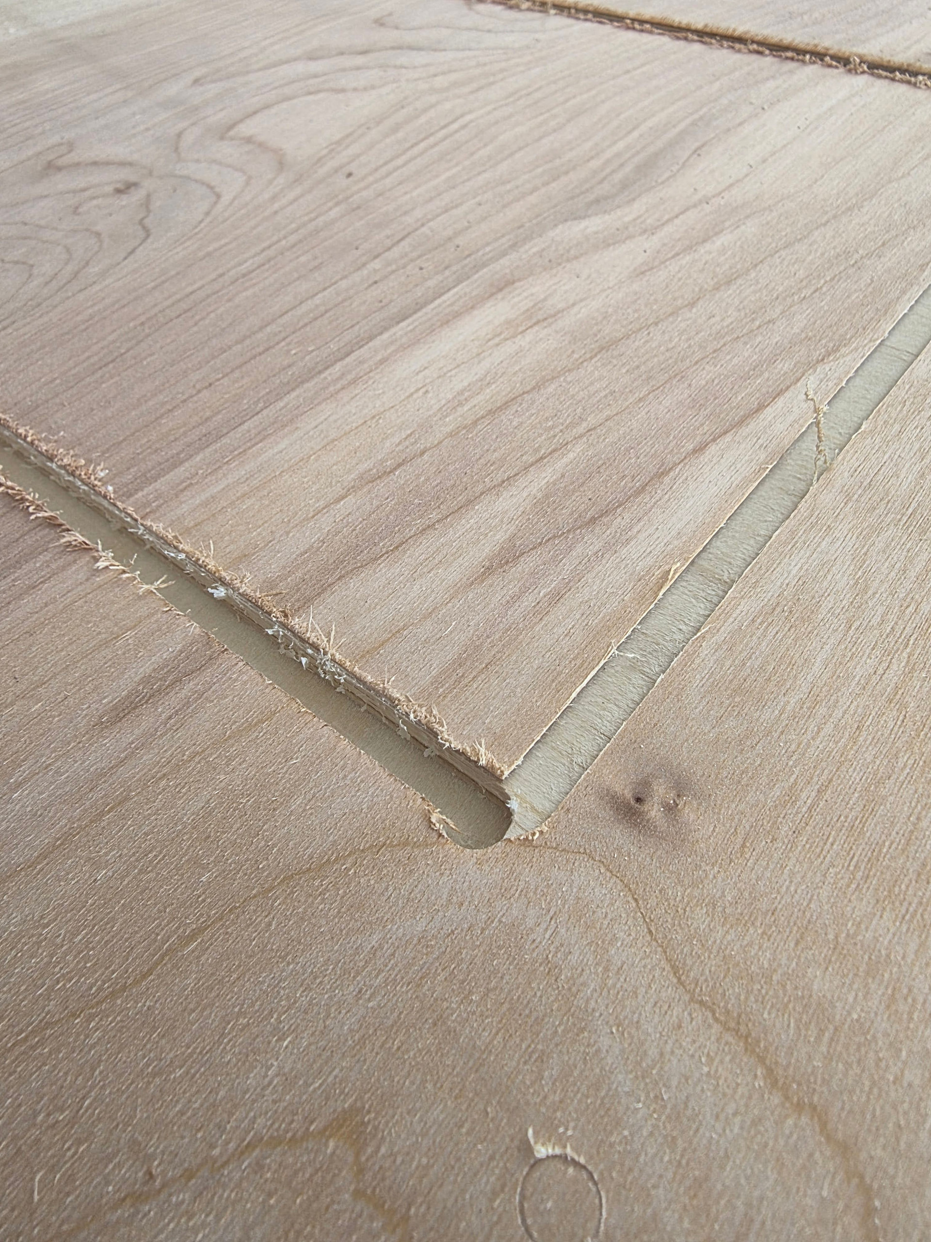

Okay so I just got a chance to try all the feedback:
  • Lubricated Z lead screws
  • Checked wire connections (no issues)
  • Ran with a ~1mm DOC to be safe

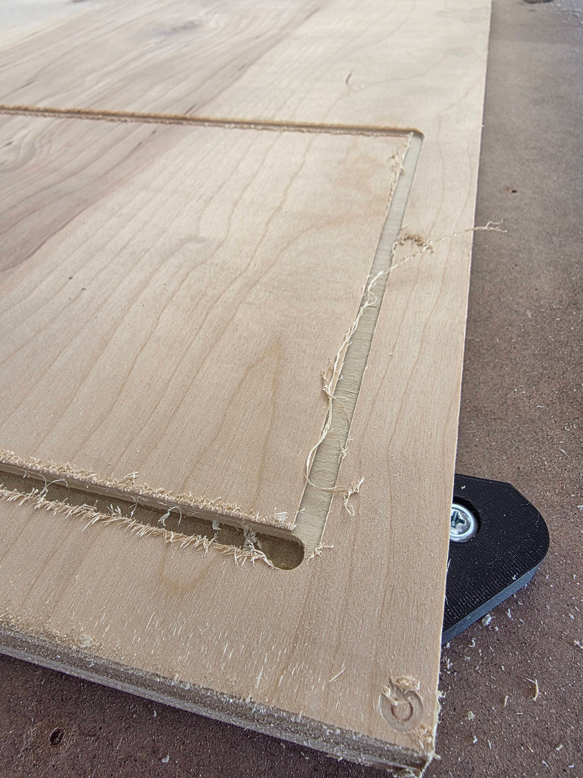

It is still plunging but I can now see that it is very consistent. I ran two cuts and it took a massive dive on the second pass both times in the same spot and to the same depth. So now I’m pretty confident it’s a config issue or I’m not doing something software related on my end that I should be.
  • This is the first attempt. It correctly cut a 1mm perimeter, then plunged to a 6mm depth
  • This is the second attempt. Flipped the board over and got basically identical results which leads me to believe this is a software problem.
I’ve checked the gcode and it looks fine.

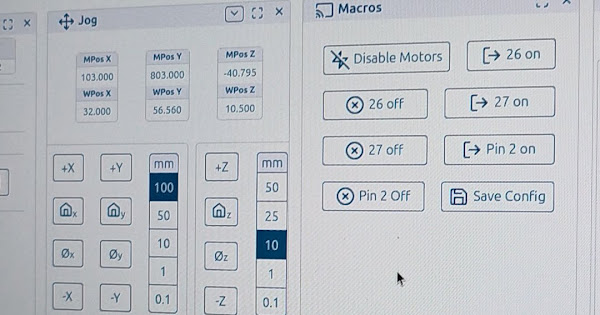

I also checked the WposZ and it again showed correct (~[-2mm]) as it was barreling in at -6.
An odd thing though, when I stopped it and moved back to my zeros, the Z was serveral mm lower than where I originally started it.

If your Z was off at the end, three things come to mind….
  1. Loose grub screw.
  2. loosing steps.
  3. End mill moving in collet. I have had this happen before. I had a 3mm end mill in a 1/8 collet. The cutting force pulled the end mill down resulting in deeper cut.
