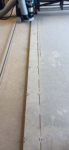

recently completed my full sheet build, and have run into a problem while trying to cut the strut plates
I’m using a makita trim router, wondering if the power cord for the router could be interfering with the x stepper motor signal wires?

the reason i’m thinking it’s interference is because it only seems to happen with the router running.
in the attached photo, the middle cut path should have actually been where the right hand cut path is
What are your CAM settings and what speed are you running the Makita router at?
12mm/s feed, 3mm/s plunge, 3mm doc, 30000rpm spindle speed

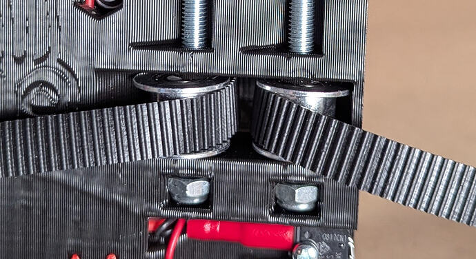

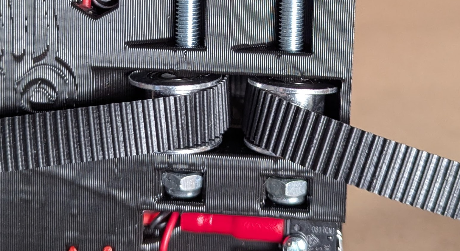

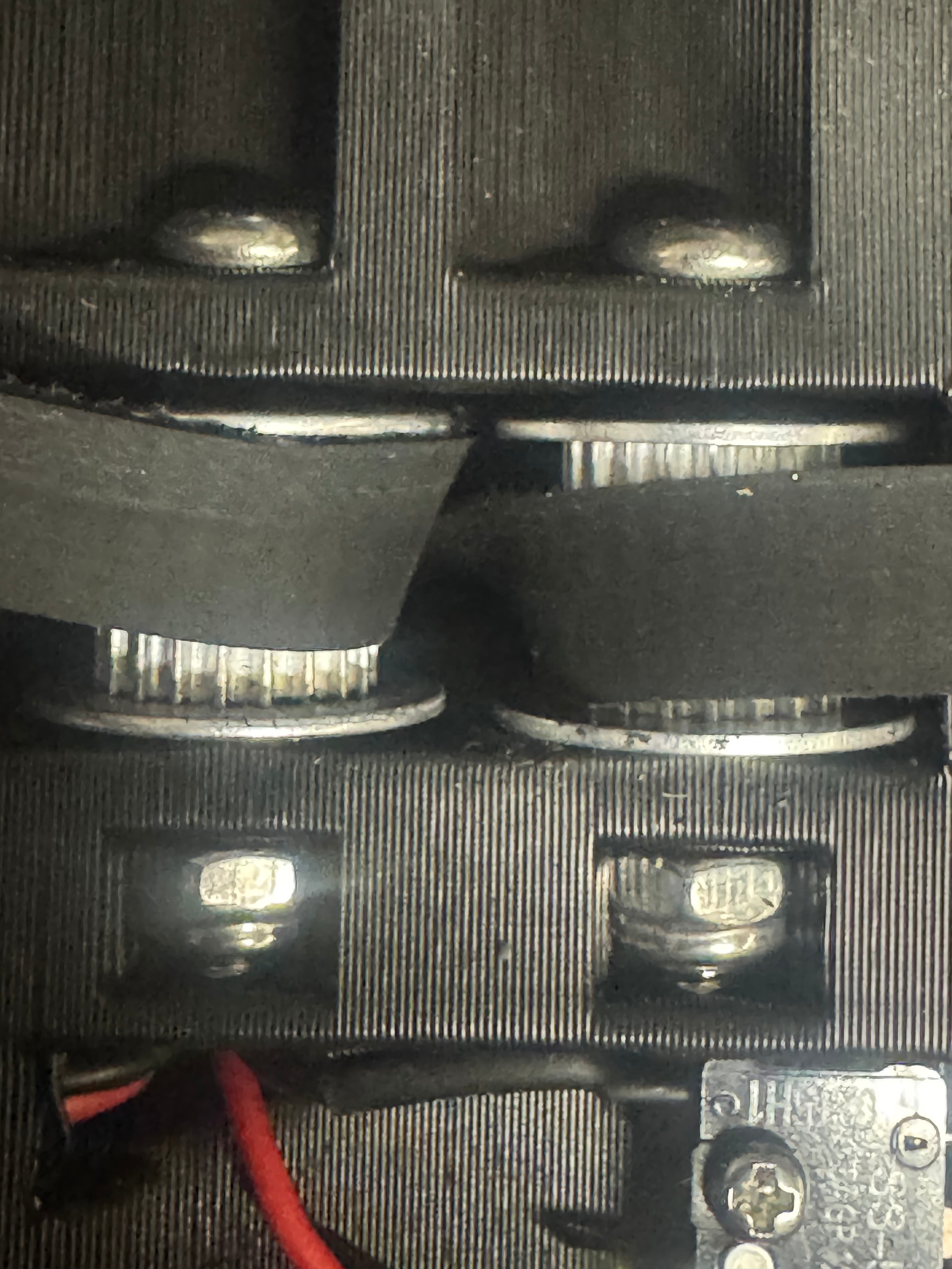

my x axis was still skipping steps so I pulled the core off. turns out the belt was crossing back over itself in between the stepper motor and pulleys!
Did you happen to take a picture? I’m having trouble visualizing what that looked like…
This was the best I could get. I also had to reverse the x stepper wiring to get it moving in the correct direction because I effectively reversed the belt when I rectified it.
In plan view, think of the belt going up and over a hill. Mine was doing a loop de loop.
Should be smooth idlers on the Core, and, belt should be flipped other way around so stepper teethed pulley gear engages the belt.
Pic below is from LR4 assembly doc section https://docs.v1e.com/lowrider/#core-assembly, specifically this pic https://docs.v1e.com/img/lr4/cv.jpg
The new kits have toothed idlers, no smooth ones. But the smooth side of the belt should be riding against the teeth on the idler

As the others have said, the idler- whether smooth or toothed- make contact with the smooth side of the GT2 belts.
I think it’s as described- the supplier made a bunch of kits that way.
There’s no significant performance penalty for using toothed pulleys as idlers in this application. Probably a small bit of additional wearing of the belt and maybe a tiny fraction of a mm or motion jitter.
maybe a little bit of belt squeak too? but happy to report that it travelling beautifully now.
