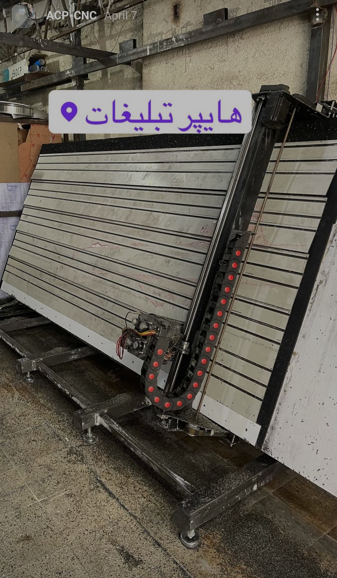

I use a 1.5kw vfd and spindle, i do more so to control the rpm to correctly get my chips cutting acm, i dont think im using 1/2 of the available power in my use case. But its nice to have a water-cooled spindle when your vacuum is inside a silencer box
I have no issue with people using whatever as long as it is common knowledge that is is extreme overkill. If they made a good 500-800watt watercooled spindle you would actually be able to use much faster rapids & accelerations, sacrifice no cutting speed and save a ton of actual machine time.

Can’t speak for cutting woods, rarely i do some mdf but my shop cuts extruded pvc and acm the majority of the time
Rapidchange… :drooling_face:
Its in my to do list but a beefier cnc its on my top 5 things to do first.
Dual spindle and vertical. (Easier to handle 5m long sheets.
