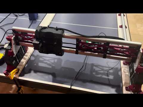

Before installing the box to the gantry, I first tested everything to make sure all the steppers are moving in the right direction, and all switches are working. Getting FluidNC working was pretty straightforward. The most difficult thing was figuring out how to connect to my home network. I didn’t realize I had to use AP->STA mode at first, and ended up with Station mode, and then lost connection via my network. I had to access through the FluidNC Web Installer (via USB cable), which meant I had to add USB-serial driver to my A3 silicon Mac. In case anyone else needs this, there is a driver which must be installed from the App store and then Reboot the Mac.
Finally got everything working. IT MOVES!

I was finally able to get back to this today. The LR4 is mounted to the table tennis table. Rail side is mounted on 4x1 MDF which is fastened to the table using masking-tape-and-super-glue fixture method. Its rock solid. The other side is just clamped for now. I had to reverse the Y direction to home correctly, which I did in the config file. Since I have a Mac, EstlCAM doesn’t work without emulation, so I made a test using the free version of Easel instead just to get things moving.
I don’t have the router or a pen mounted yet, but very happy to see that I can run gcode! There is a bit of squeaking / vibration from the z-axis when close to top of travel. Hoping that will go away after I level the z-axis.
First & second test pattern with a pen. Leveling the z-axis was a bit tricky and I crashed the z-axis a few times. I still need to set the soft limits for all axis. Greasing the Z lead screw helped with the squeaking and vibration.
