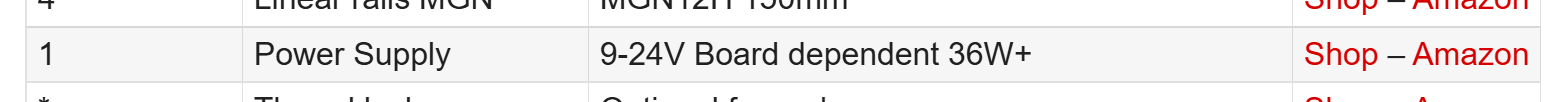

According to the Docs, anything 36W or higher will be good.

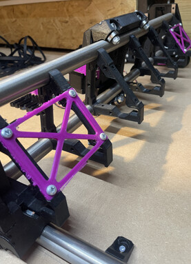

An update as too where I am currently at :slight_smile:

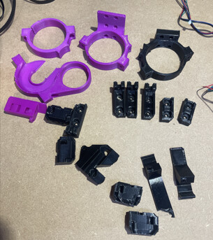

Got some parts here that I can’t figure out where they go ?

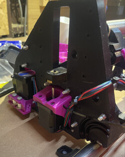

These are the steppers that came with it.

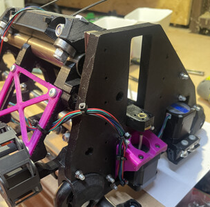

Some of this side was printed so I got to work on building it.
It was missing 3 Strut braces from in between the two purpley pink bits
I Have temporary routed the stepper cables to figure out some positions & stuff.

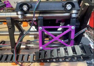

Now I’m working on a power chain for the ‘X’ axis, just not sure how I’m going to mount it to the carriage yet.

The purple ones look like parts for @DougJoseph’s floating dust shoe attachment and/or kinematic tool holder. They replace the stock dust shoe, upper, and lower tool mounts.
Not sure about the black parts.
These are the temporary struts. You only need them on the end sections, but you should have them on all three faces of those sections (if I recall correctly).
Use the temporary struts to cut permanent ones with your LR3.
Here’s a link to the YouTube playlist about that floating Z dust shoe.
Oh yes I like that design. How did it work out in the end ?
Floating Z design definitely works and I used it extensively on my LR3, however, the LR4 approach of putting printed TPU bristles on the bottom of the fixed shoe, and having two sets of them with two different lengths of bristles, such as what Ryan designed for the LowRider v4, is a very capable solution that is easier and simpler to produce and works so well that it makes a floating shoe approach not needed. I think prior to my design with the floating Z shoe that involves the track/groove on the bottom for bristles, Ryan and others were just taping bristles to the sides of existing shoes. So I’m not sure if I gave him some inspiration for his very clever track/groove based bristles on the v4 or not, but (long story short), I used the floating Z dust shoe on my LR3, but not on my LR4.
