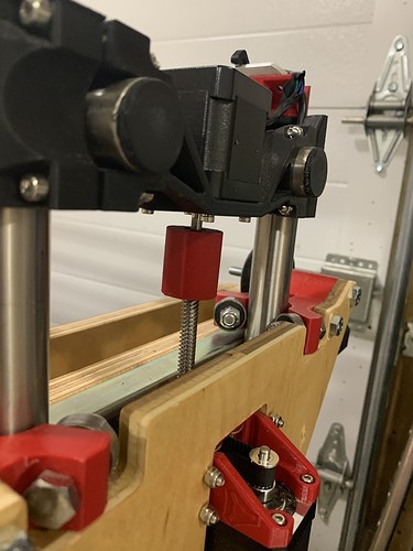

Michael, as I understand it, senseless homing works by detecting resistance in the steppers. It seems to me that the Z direction would be difficult to detect. Do you home Z up or down? Down would seem to stretch the couplers with less force than needed to lift the carriage.
I home up but have one of the doodads on my coupler that I found here on the forums.
It keeps the coupler from over stretching.
Here’s the part:
From @anttix
Oh I forgot one piece
There is a bumper on the bottom of z tube that makes contact.
I guess you could also put it on the bottom of the z screw if you wanted.
