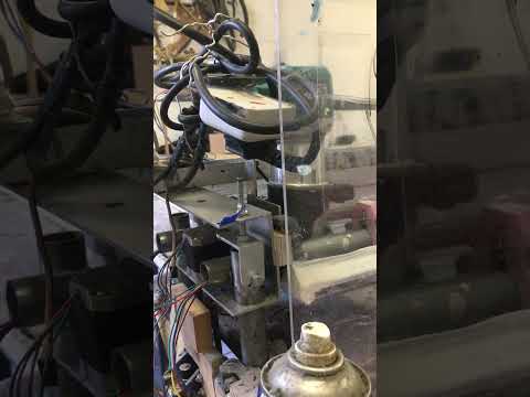

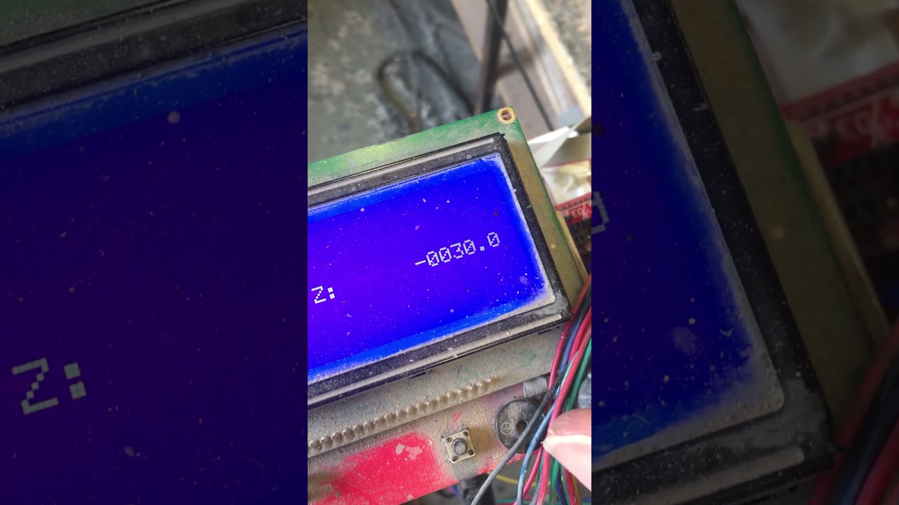

The first video here shows me moving the z axis on the controller. At first it moves, then powers off, then powers back on and continues to move. The motors do not sound healthy, I do not recall them making that noise previously.
The second video is me raising the z 30mm through repetier host. As you can see it moves then powers off, then powers on, then off, on and continues to do this after I finished recording……

That looks like the drivers are overheating. When they turn off and on for several seconds, it is heat.

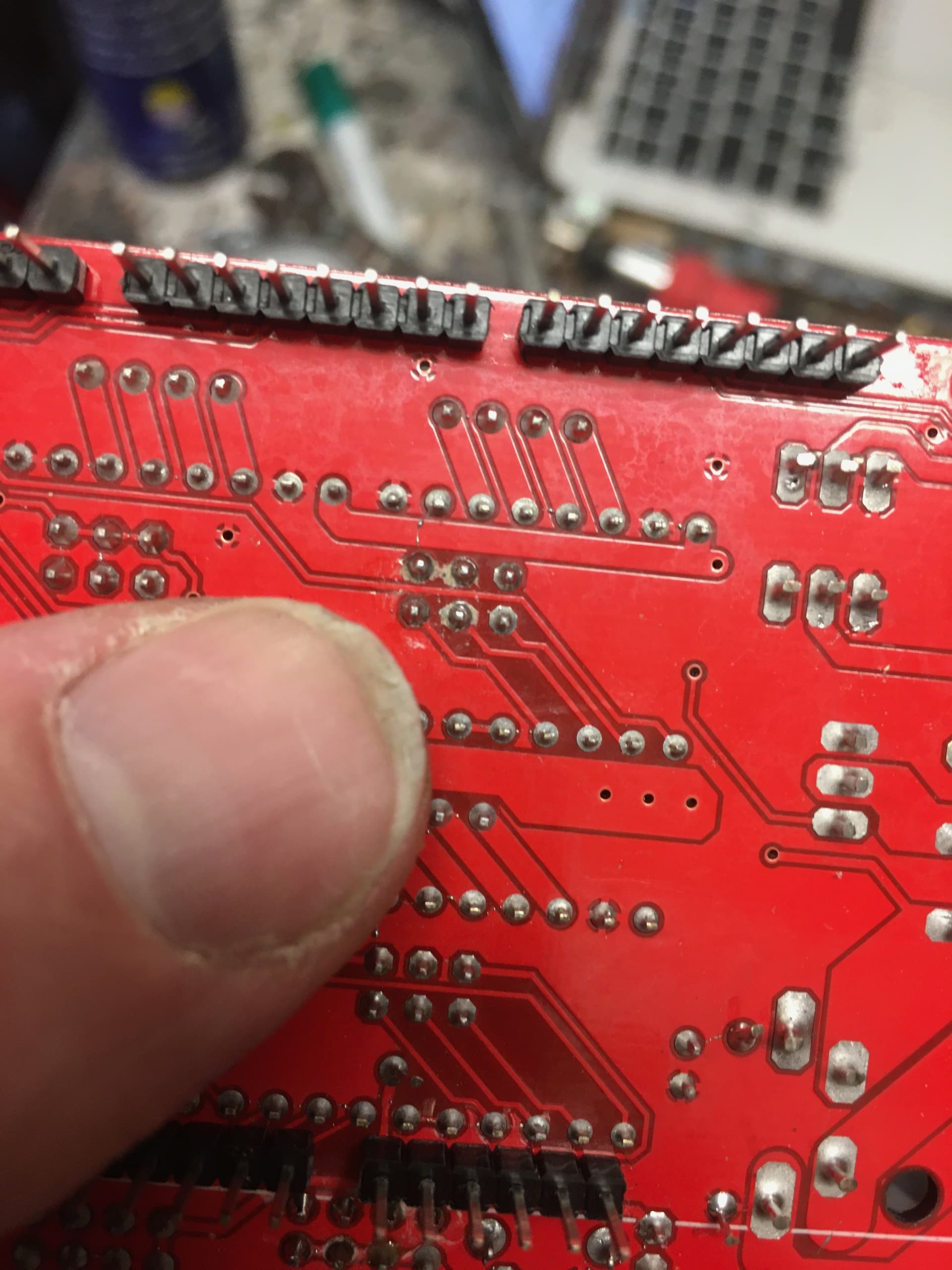

I checked all my grub screws, but they were fine. The z was definitely rising as i’d checked it with calipers before and after the print. The z axis driver I replaced did have some scorch marks on its underside. I’d been milling wax and i think some wax has got in behind it. Could this have been the cause?

Sure could. Care to share pictures of it?
I said driver, but it was the Arduino directly below the driver. Here is a pic, I’d already scraped off the burnt wax. It was machine wax, so wax mixed with plastic, so had a melting point of about 150degreeC.
It’s plausible that there was some conductivity in the wax, making for who knows what kind of pull-up/pull down path and it could absolutely have caused bizarre stepper driver behavior.
