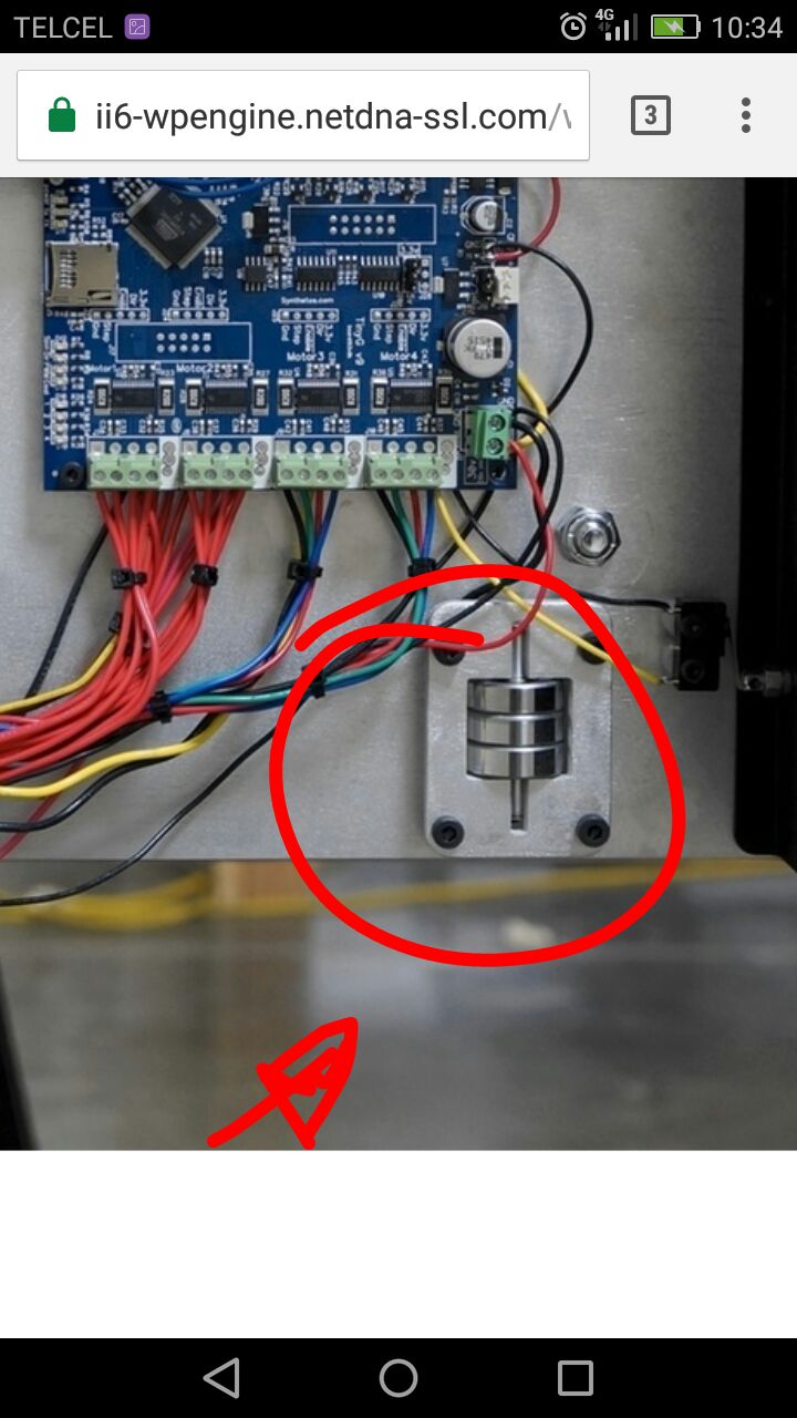

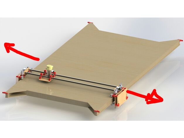

How do you evict that the mechanism move itself in the way that the image shows with the arrows?
I append the image of the piece in a red circle who evicted the movement of the PrintrBot Crawlbot but I can not see which piece do the same work in the LowRider CNC
Maybe this will make it more clear.

But it is only the friction of the wheels what prevents it from moving and stop with the base?
Oh, I see what he’s asking. What’s keeping the side assembly’s from moving side to side along the X axis during cuts?
Hmmm, well I think it is a two fold answer.
Hopefully the grip from the 4/8 wheels is doing that. Just in case the z rails can actually be set to slide along the table. Make sense?

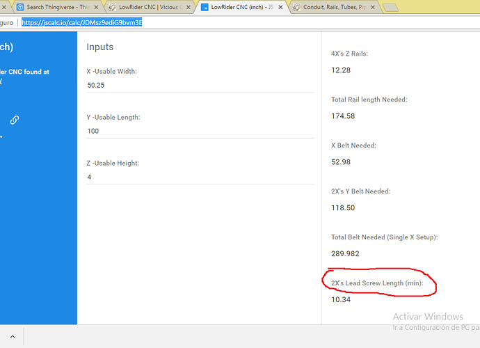

I was watching the page https://jscalc.io/calc/JDMsz9ediG9bvm3E “inch calculator”
but I think that it has an error in the next image I rounded with red color
it says “2X’s Lead Screw Length (min)” but I think that is 2Y’s Lead Screw Lenght (min) because they are for Z axis
am I right?
In this case you can think of the "2X’ as ‘two times’. In other words you need two of the lead screws. It doesn’t actually tell you where the lead screws are used. Another instance of English being imprecise.
