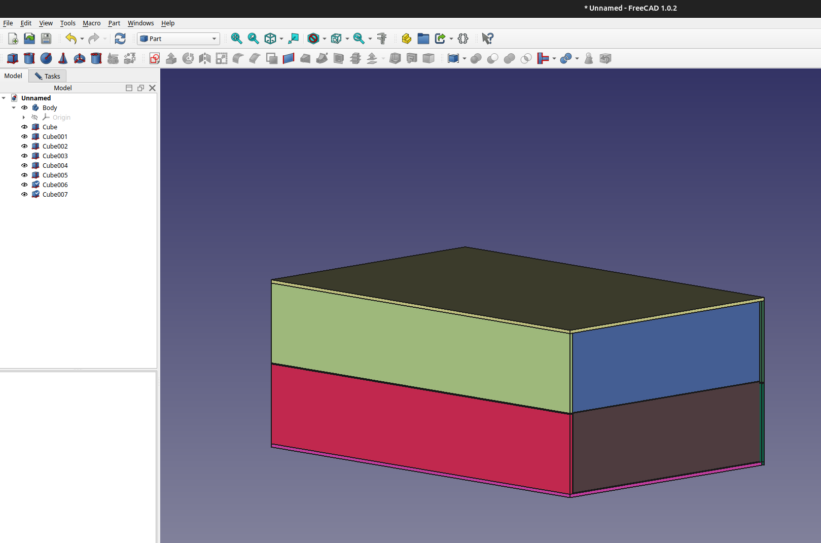

I was playing with this trying to wrap my head around FreeCAD (epic fail on the FreeCAD front)
Imagine this box on the left side had a piano hinge and on the right side had Tom’s road case latches.
No accomodation here for handles or wheels, but this thing could fold open and be its’ own table.

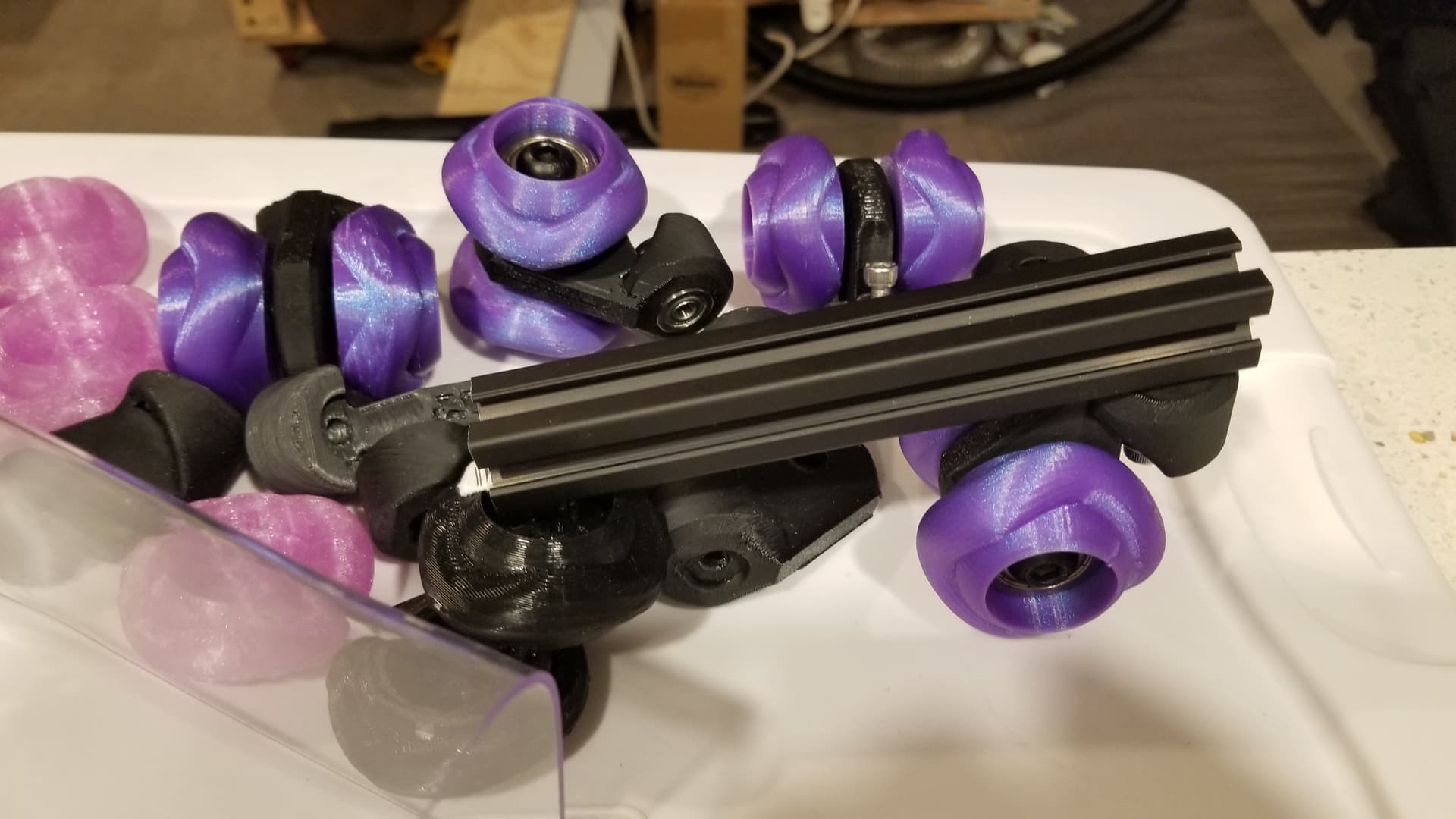

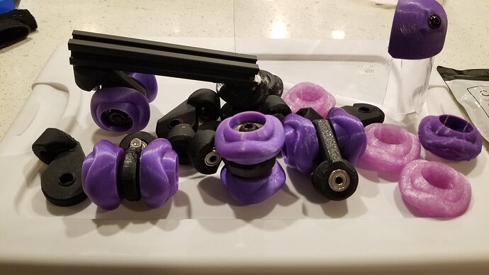

Noticed you’re evaluating/investigating wheel/caster options. Here’s how far I got with those before some other shiny projects came along…
Original plan was to try designing cheap no bearing solution, but I didn’t like the friction of the earlier prototypes. So, given the time already sunk into this project, I ended up adding a bunch of bearings per wheel. There’s definitely more elegant efficient designs than this, I’m hoping someone will tell me/us. Haven’t load/stress tested the wheels, yet.
If these might work for your project, or could be useful for you to remix, I can dig out the model files, they’re probably backed up onto one of my many unshared incomplete project GitHub repos.
I really liked those, the idea of a set of casters I made myself is appealing for a portable maker travel case. Maybe milled aluminum bent over a form for the caster body along with the usual suite of bearings and other vitamins.

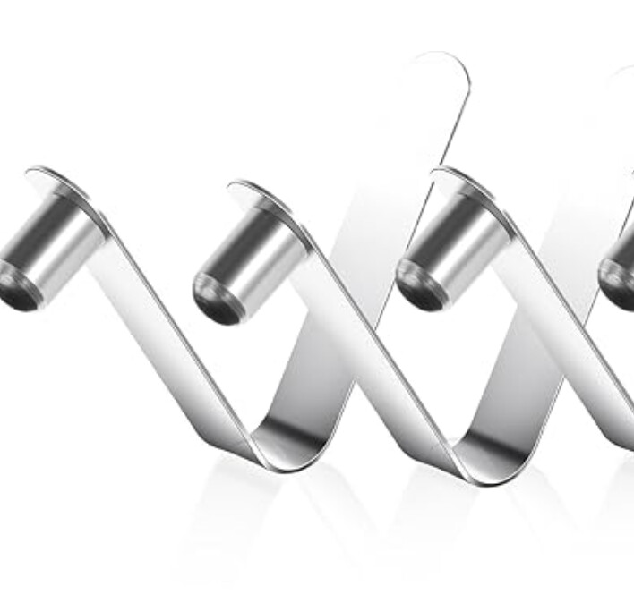

I’m thinking I can have legs using nested EMT tubing and these:

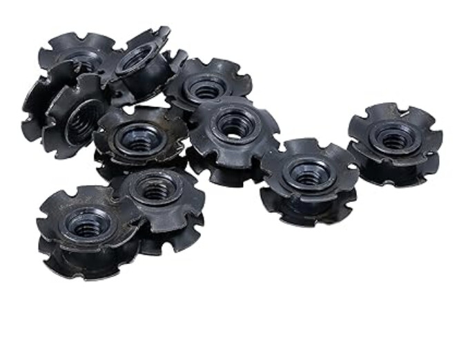

I also just discovered tap-in inserts for EMT:
https://www.amazon.com/Double-Flanged-Threaded-Insert-Threads/dp/B0CKLXQJ4S/132-6599159-9176757?pd_rd_w=0ieLl&content-id=amzn1.sym.2cd14f8d-eb5c-4042-b934-4a05eafd2874&pf_rd_p=2cd14f8d-eb5c-4042-b934-4a05eafd2874&pf_rd_r=VPP1118CXHWM7M5G5549&pd_rd_wg=pYk9A&pd_rd_r=0707e508-e458-4cf6-8b2a-445344c4dd00&pd_rd_i=B0CKLXQJ4S&th=1
