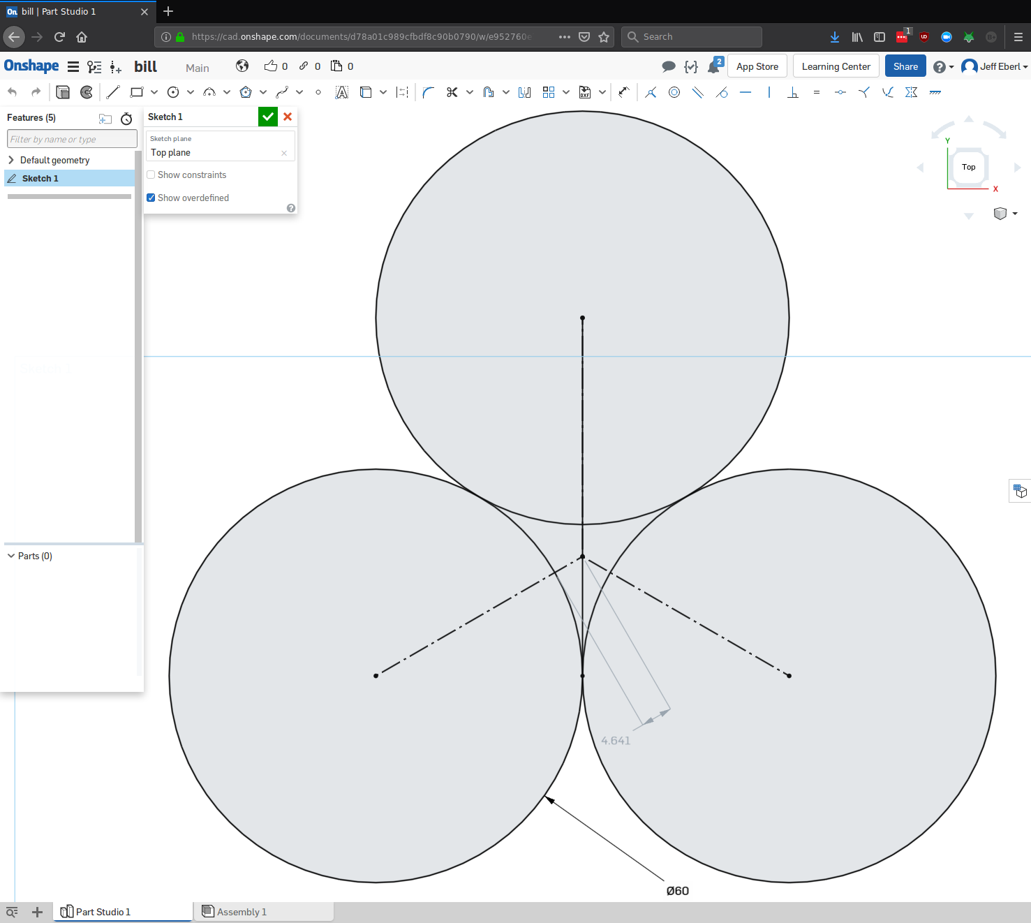

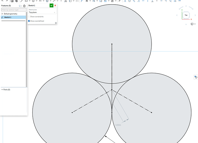

Well… I didn’t read all the responses before I went to onshape…
[attachment file=“screenshot-2019-01-28-1548714836.png”]
Wow, Onshape got the same answer I did, probably a lot faster too, though it wouldn’t have been for me. I’d have had to Google for 45 minutes or so to figure out how to draw the first circle. :slight_smile:
Yeah except…
7mm != 4.64mm*2… So close!
Just over 9mm, which meets our spec. :slight_smile:

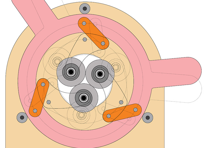

I have what I believe to be all the hardware and a friend has been working on the drawings for me. He uses Corel Draw though, so it’s not quite CAD worthy. He’s also trying to change the design on me in several places and I have to argue to get them back to my design. ;(
[attachment file=96225]
Note that in this ‘final’ design he has the petals opening backwards, trying to push the wheels open while the lathe is spinning counter-clockwise. The positioning of the arms also forces the maximum size to be smaller, but at least that’s wide enough for my needs. One suggestion we came up with that works is the order of the layers. I had said outer, arm, petal, inner and what actually should work better is outer, petal and inner, arm. That should have a bunch less slop when assembled. With the inner circle flush against the outer we could add some bearings to act as rollers around the outside. Note that when I say ‘flush’ I really mean ‘a thrust bearing depth apart’. :slight_smile:
