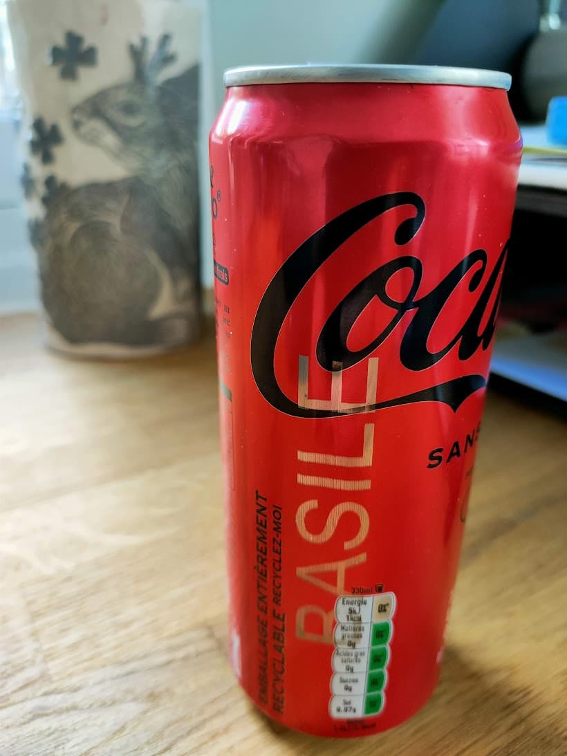

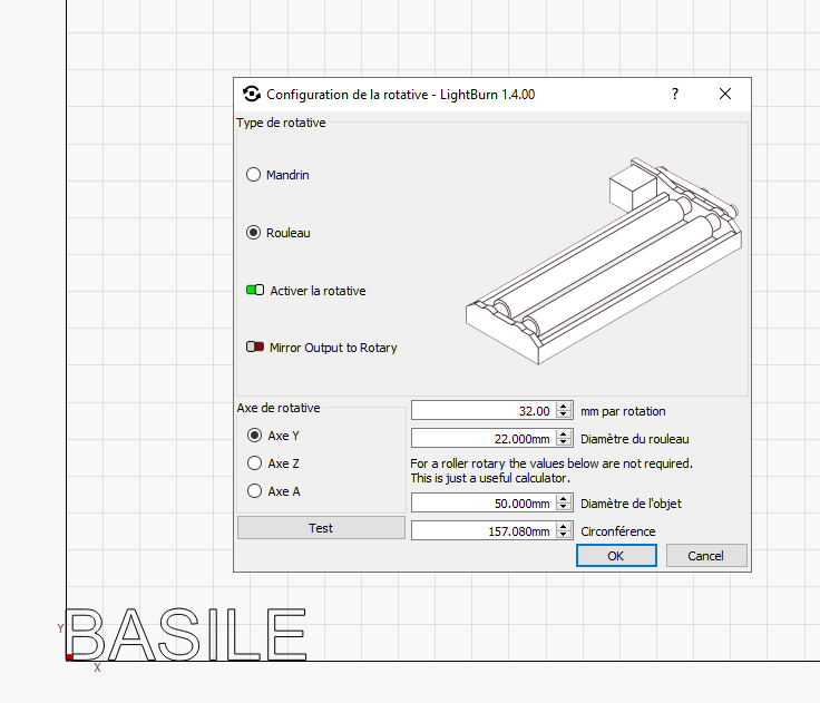

Setting up the rotary axis in LightBurn is pretty simple, you just need to measure the distance in mm a whole turn of the motor represents on your machine (32mm in my case for the LR3)
After switching both Y plugs to the new motors, I setup everything roughly perpendicular and straight, and here’s the first test :slight_smile:
Now I need some cool design and a few tests before engraving the real thing :slight_smile:

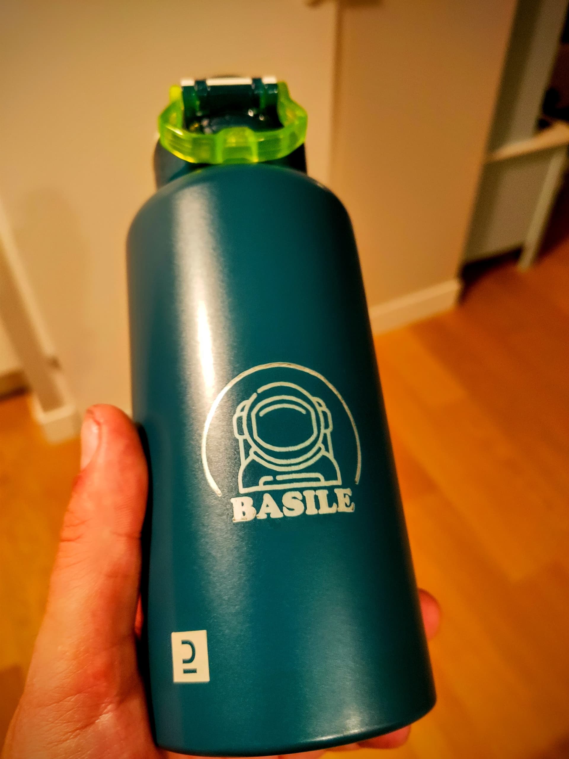

Committed to engraving the real thing
After cleaning with IPA, this turned out pretty well.
It looks gorgeous with the slight shine of the aluminium
It just ended up much narrower than expected so it’s not quite centered as I would have liked but that’s ok

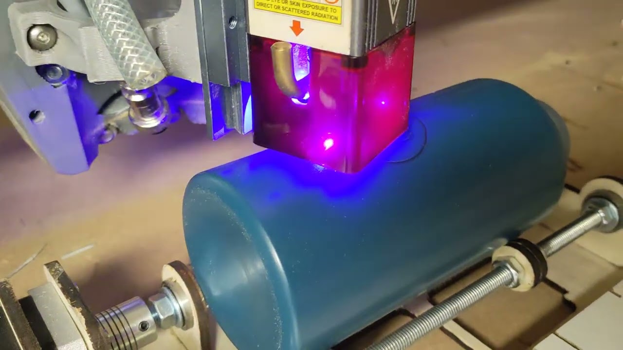

Not tested yet, but this support is a bit wonky and there’s a ton of play/slip
I tried to make a second pass in the second test, the laser did not return to the initial point, several degrees of difference …
I’d say if you need a wrapping pattern , either avoid it, or maybe use a chuck rather than the rollers design type

I’ve been mucking around with my filament dryer, and have ended up putting a sleeve of silicone tubing (12mm ID 16mm OD) on the axles to stop slip - might work there too - I had to buy a metre though.
I am keeping my eye out for that. If it’s half as good as the laser package at the same price it will be a killer!
Yeah, or maybe print some rollers out of tpu
I slapped this together pretty quickly just to get this engraving done before monday, but I Guess it can be improved with more time
This is exactly what I was thinking when you said it was slipping. And was planning to use that as an excuse to get my hands dirty with TPU finally lol
@Fabien what size did you end up making the rollers so it matched up with the correct steps per mm? I’m hoping to print the rollers in TPU today.
They are 21mm in diameter
