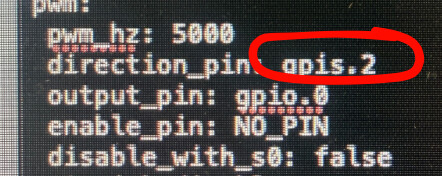

Using Jackpot3 and lightburn, laser does not turn off between layers (G0 moves). Does anyone have experience with resolving this? I have tried changing a few things in the config file, but no success. I also cannot change $32 to “1” in lightburn.

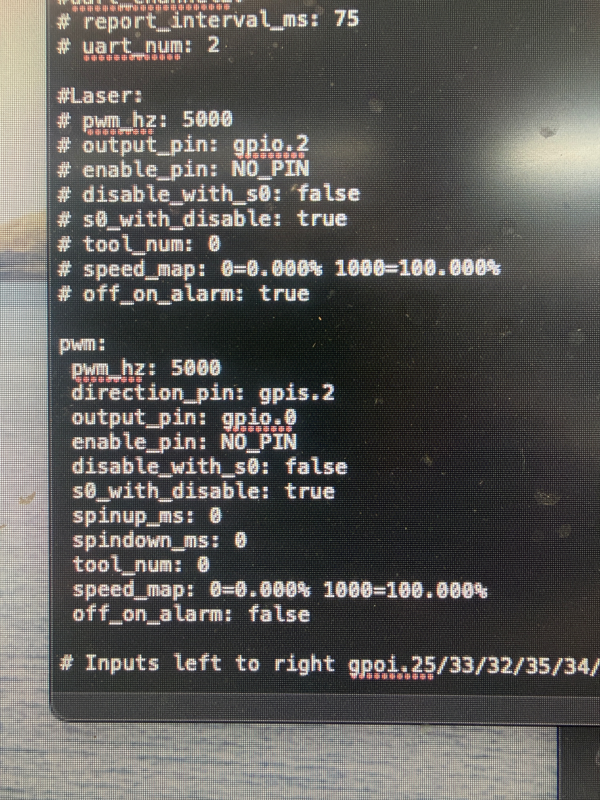

are you actually in laser mode in fluid nc ? how your spindle is configured
Sorry, that photo isn’t accurate, I have the # removed from the laser section.
your laser is commented out., remove the #
Sorry, the photo isn’t the most recent, the # is removed from the laser section.
Repeat your $$ with current settings.

you also dont need $32 for fluidnc, it will switch automatically to laser mode when the laser tool is selected

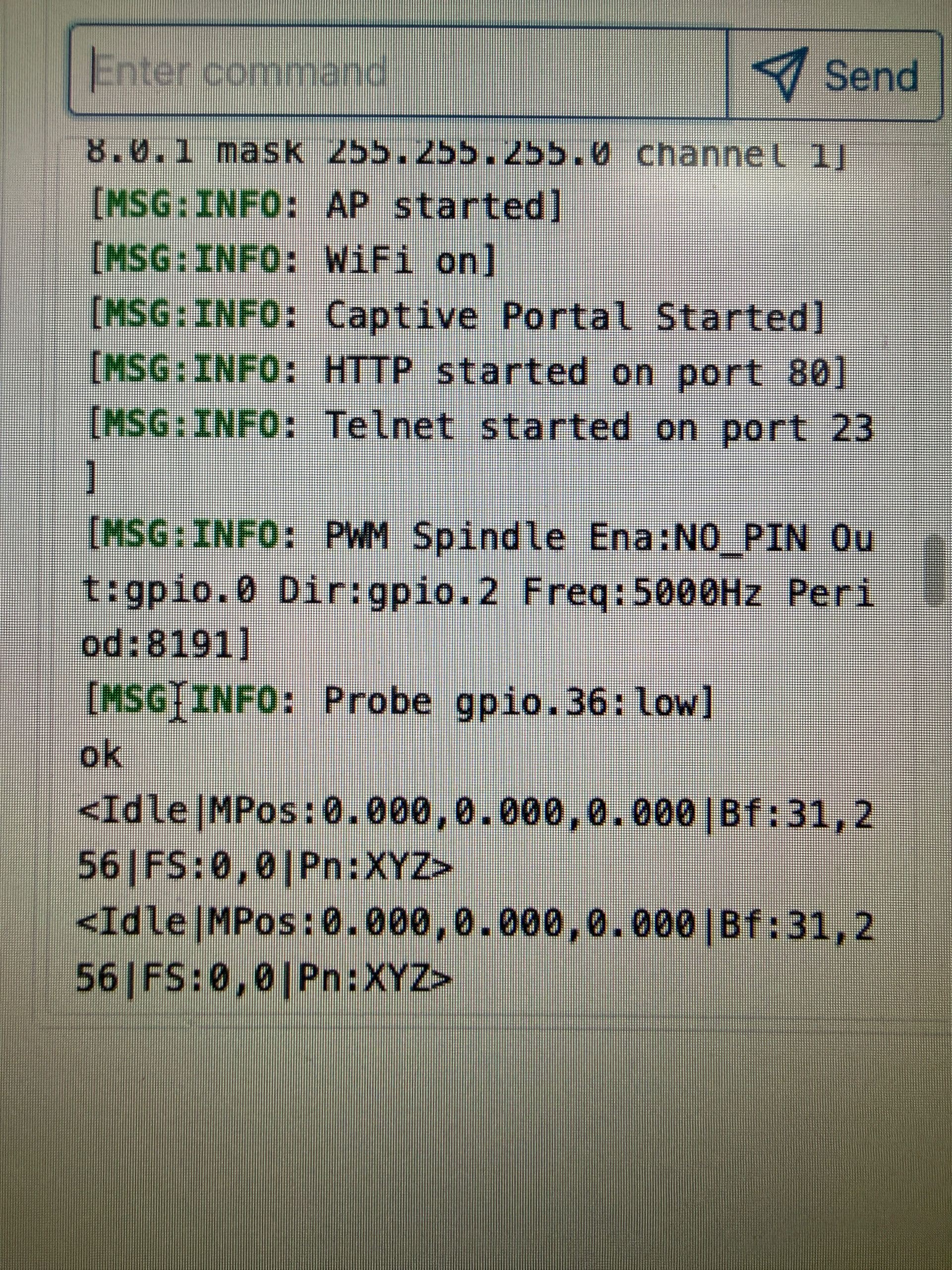

post the gcode here as well. are you using M3 or M4 mode ?
Here is the current photo, the pwm works great, I tried commenting it out and using the laser, and it will only fire at 100%. So I’m using the pwm. As far as the m code goes, in the device settings menu for grbl it does not show the m codes for the laser. When I look in the console neither m3 or m4 are used.
Looks like a typo, retype gpio.2
Here is my config.yaml, I use a different GPIO pin and use a 60W Lasertree but maybe you can gleam a few things.
Laser:
  pwm_hz: 5000
  output_pin: gpio.26
  enable_pin: NO_PIN
  disable_with_s0: false
  s0_with_disable: true
  tool_num: 10
  speed_map: 0=0.000% 100=13.000% 1000=100.000%
  off_on_alarm: true
  m6_macro:
EDIT: the speed mapping was custom to me, but that was the right curve to ensure I didn’t have burnt edges where the laser slows down for right edges, etc.

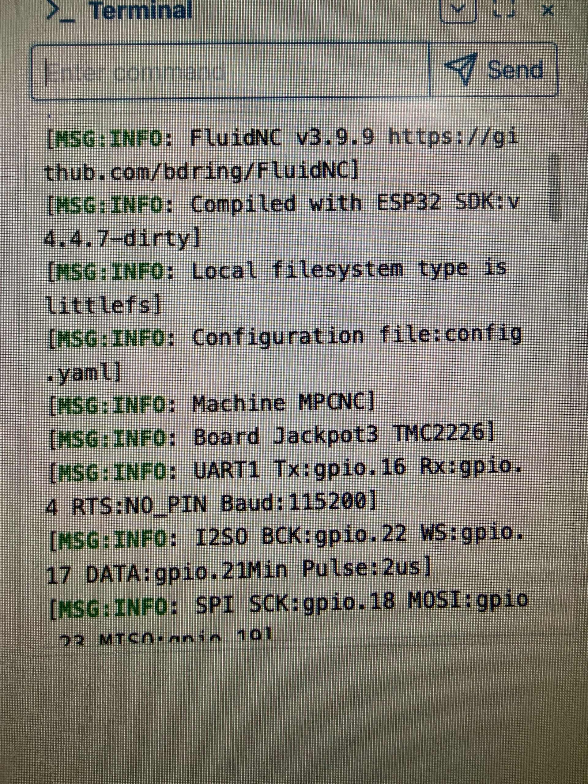

You should first run $SS to see if your config is valid.
I’ve checked in the webui and my configuration is set for a Mpcnc, pmw is enabled in the config file.
But that provides detail if the config is valid. If not, trying anything is futile. Do you have an MPCNC or a Lowrider?
I have a Mpcnc
you need to be in laser mode to auto turn off the laser

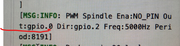

if you can control the laser power in pwm spindle mode that means that the wiring is correct
what issues do you have when you try to use laser spindle ?
which gpio is the laser wired to ?
gpio.0 does not makes sense to me
