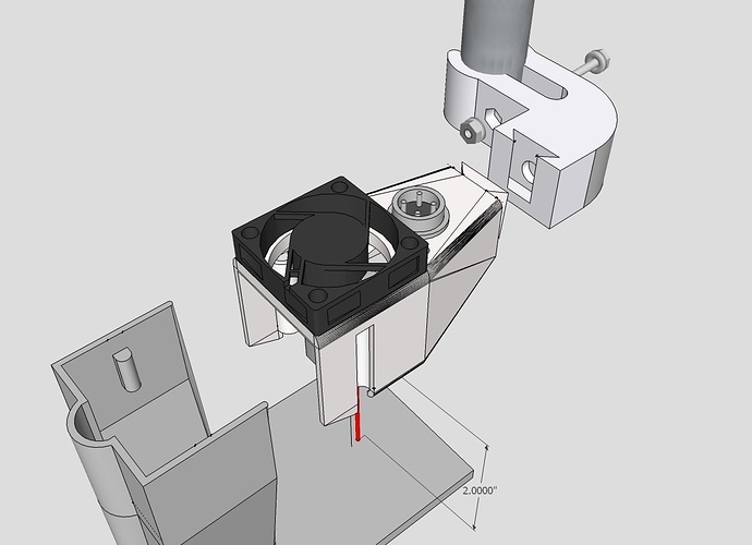

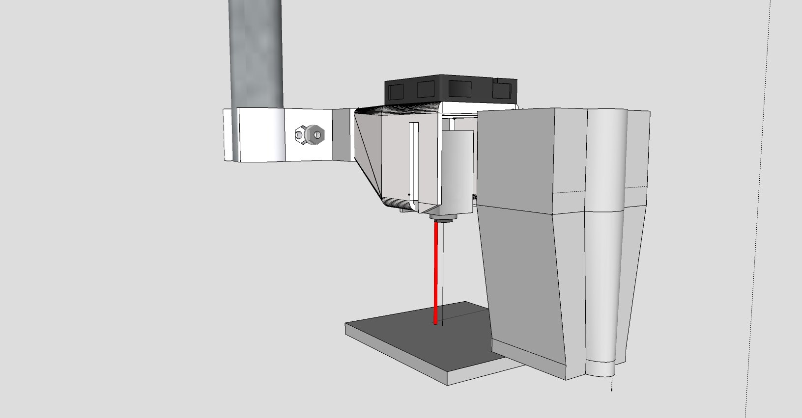

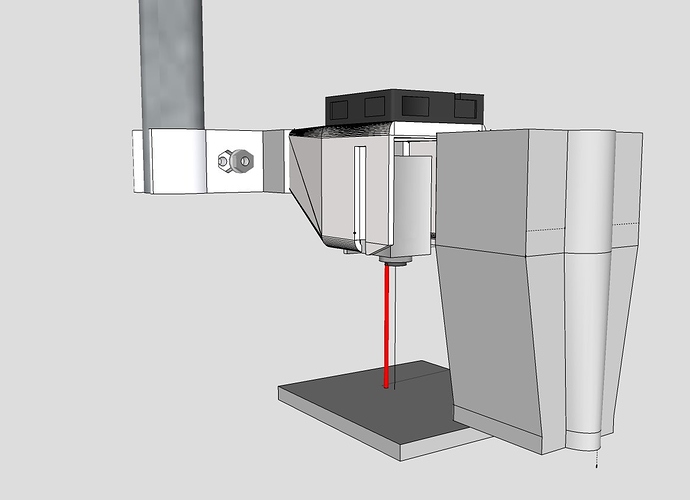

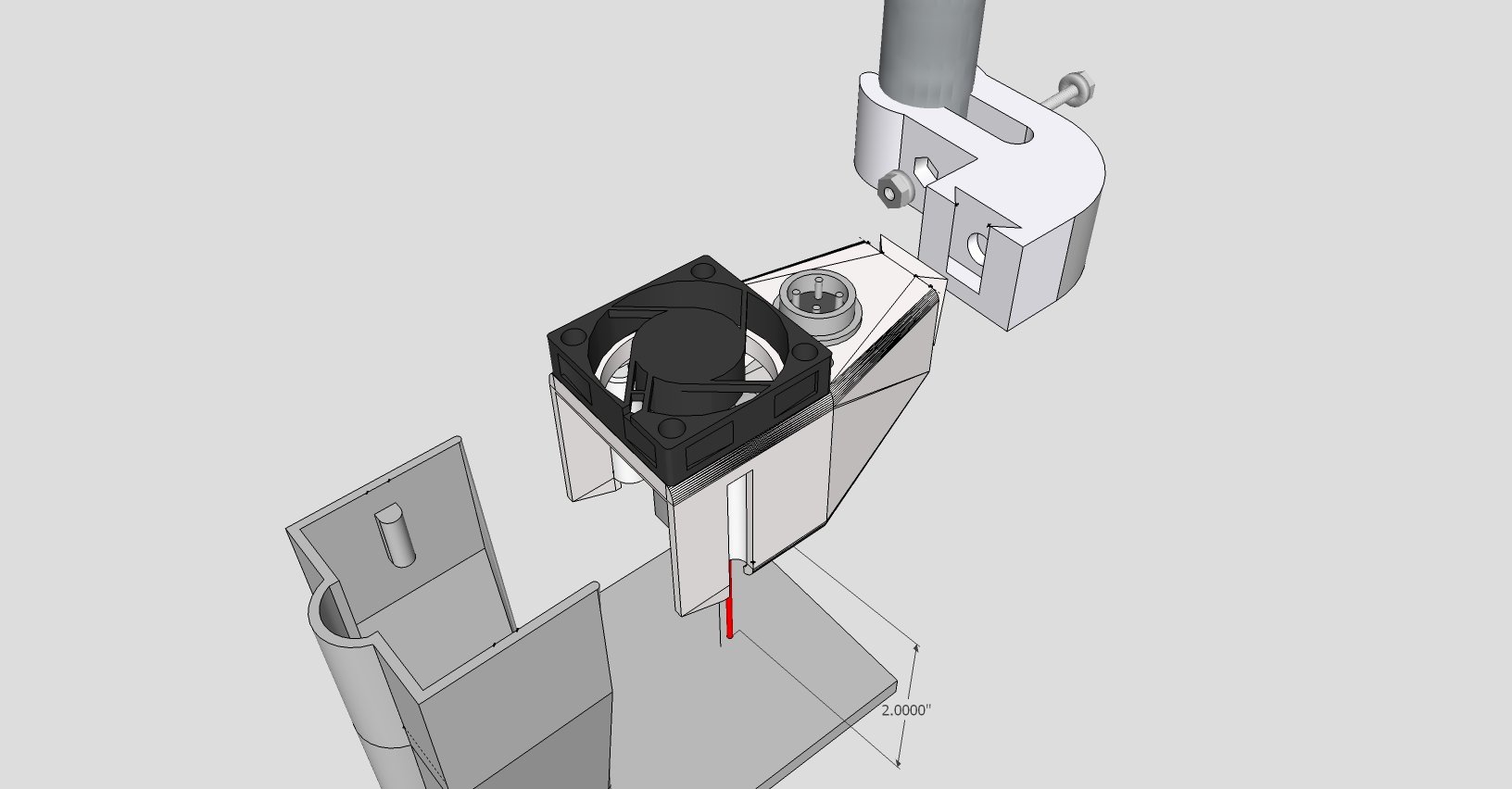

@Karl, Do the line lasers on your mount really help that much? I think they look really cool but I probably wouldn’t use them much when I can just turn the beam on at really low power for a more precise aiming spot right? I’m just asking because I’m designing my laser mount for my MPCNC and trying to decide what’s most important as far as design intent goes. I think I want an easily removable shroud because my gear is in the garage and there’s lot of unpredictable traffic there so I don’t want anyone being exposed to the laser reflection unexpectedly. I also think I’m shying away from the interchangeable mounts because I have dust collection hooked up and it seems like too much trouble. I might attach to the Z-Axis pipe and have a quick-release mount there so I won’t have to touch my router at all to add/remove the laser. Any thoughts anyone?
Funny you should ask that, Leo. I was actually thinking about removing the line lasers for just that reason - you can get perfect aiming by turning the laser on low. I also think it looks cool, but it’s certainly less wiring and stuff to worry about.
Hanging the laser and other tools off of the router and leaving the router in place is certainly a viable solution. It was what I was considering along with the universal, but when this one came out I decided to give it a try. I haven’t tried actually using my router with it yet. I have dust collection too, but I’ve already incorporated it into my universal setup.

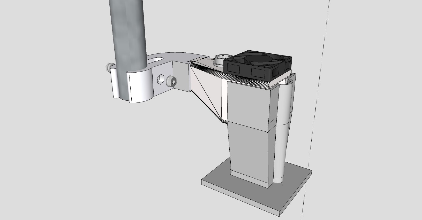

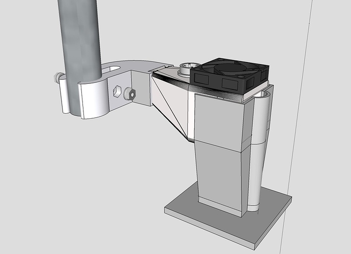

This is kinda where I’m at now. My requirements…hopefully will be fulfilled .
  1. Dusty environment so needs to be completely and quickly removable for safe storage.
  2. Light shroud to protect surprise visitors to high traffic area.
  3. Doesn’t take away from X/Y/Z/ axis travel.
  4. Electrical connections need to be clean, secure, and easily undone.

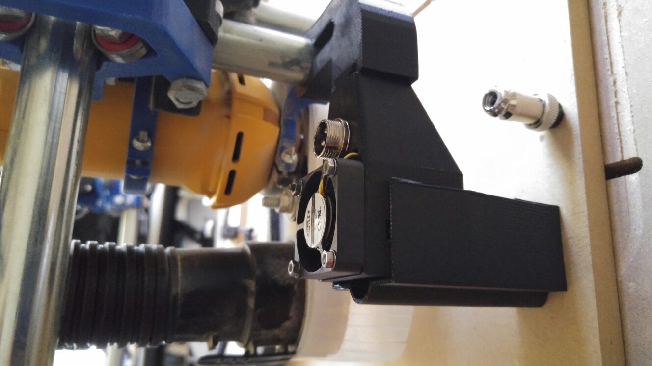

I’m gonna print it now and see how it looks and fits. There is very little weight to support and practically zero lateral forces so I’m hoping the tapered dovetail and embedded magnets will be enough to secure it without screws but I really don’t know. The clamp will remain permanently attached to the very end of the Z axis conduit and the laser should sit right next to my router. I’ll let you know after I get it all hooked up and tested but I’m now realizing my USB motion controller/Mach3 setup only has 10V adc output for a VFD spindle setup so I need to see if a simple voltage divider circuit will get it working for me.
I like the way you integrated the connector into the mount. What kind of connector are you using?
I bought some of the laser shield acrylic from JTP and I’m in the process of fashioning a shield to protect eyes without needing the goggles. Mine is not as sophisticated a design as yours. Yours is quite impressive, but I like to be able to see where the laser is hitting when it’s running. My laser shield will probably mount using a binder clip - for now, anyway.
@Karl: I’d really like to put a little viewing window in too.How thick is the material from JTP? I’m afraid it’ll add too much weight to the shroud which I need to be as light as possible to float on the material. I may just buy a cheap pair of ebay laser goggles ,which work very well for me, and butcher them for the window material:)
The connector is a 4 pin chassis mount xlr connector, very common in the DIY CNC community.My printed parts came out pretty good and the tapered dovetail provides a nice fight fit. Hopefully I’ll have time to connect and test later.
As much as I’ve seen the little laser-shield type things, I’m still leery of my kids coming in while the laser is on.
I’m just building a box with 2 cutouts for my 2 sheets of safety material.
Leo, the JTP material is 3mm. A small piece wouldn’t weight very much, but it only comes in 12x12 inch sheets or larger. For a little window, butchering a pair of goggles would probably work fine.
I didn’t realize you had designed the shroud to float. I had thought about a design like that, but was worried about catching on the work surface.
