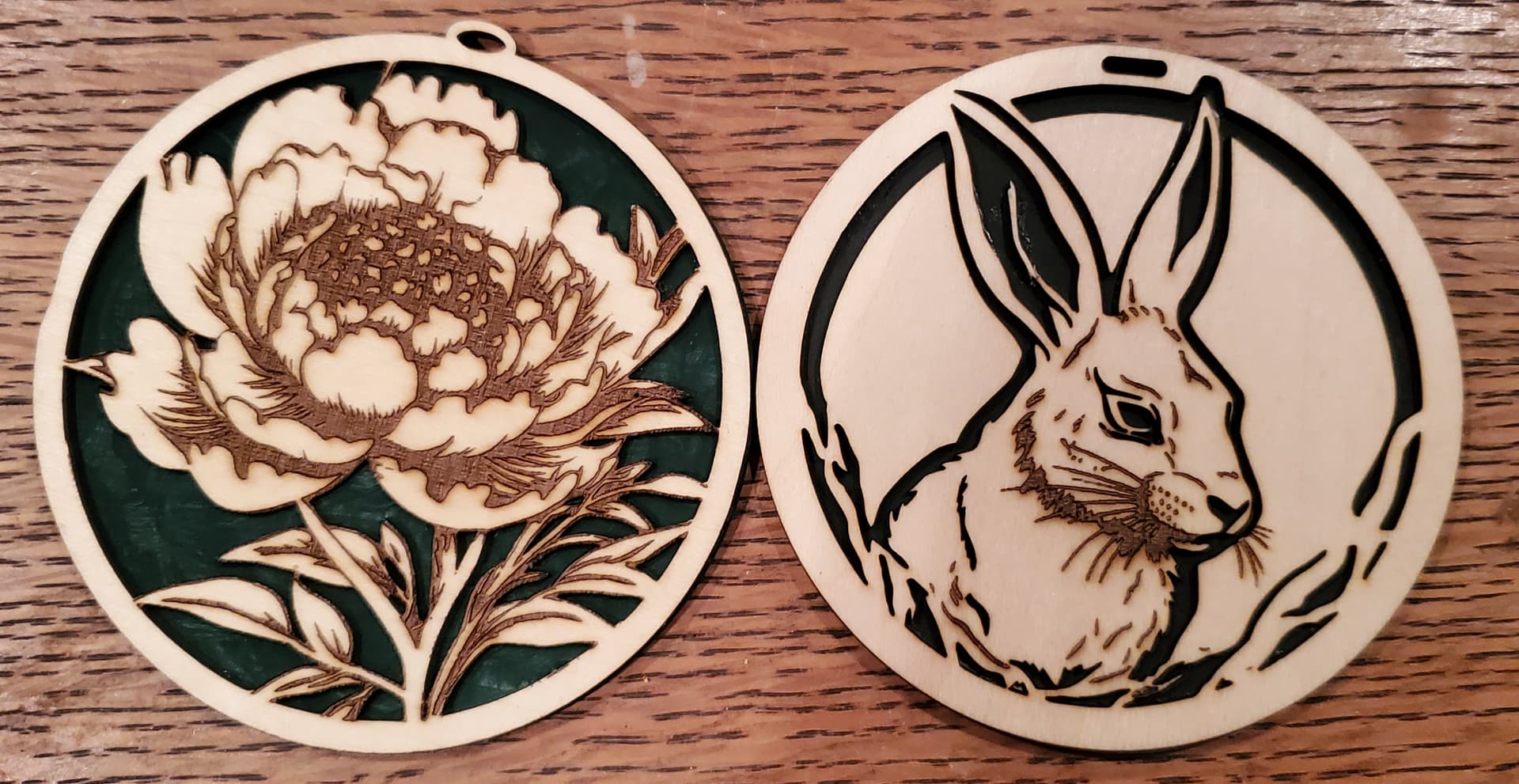

Laser cut gift tags

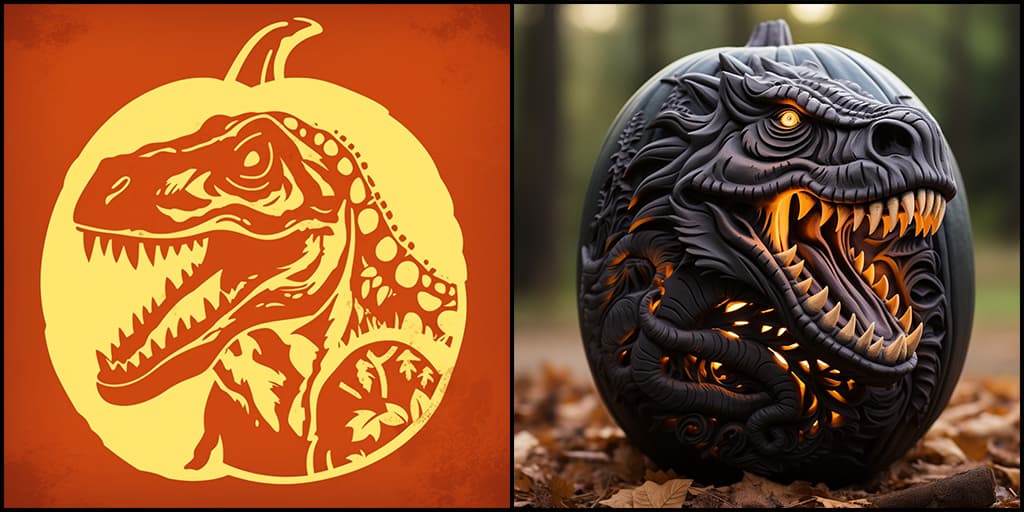

Different Midjourney engines/versions produce different results. When I started using Midjourney, they were using engine 3. They are now up to engine 5.2, plus they have several specialized engines. In general, each successive engine has produced better results for laser work. Engine 3 images were almost always just references where the vectors needed to be hand drawn with the image in the background. With engine 5, I can almost always (often after a bit of image manipulation) use trace image to “automatically” draw the vectors. In my opinion, engine 5.0 is the one to be used for laser cutting art. Note that I found engine 5.2 useless for laser cut art. For example, these two images use the same prompt (stencil_of_a_dinosaur_for_pumpkin_carving) with the 5.0 version on the left and the 5.2 version on the right:
The engine 5.2 version is cool, but totally useless for laser cutting.

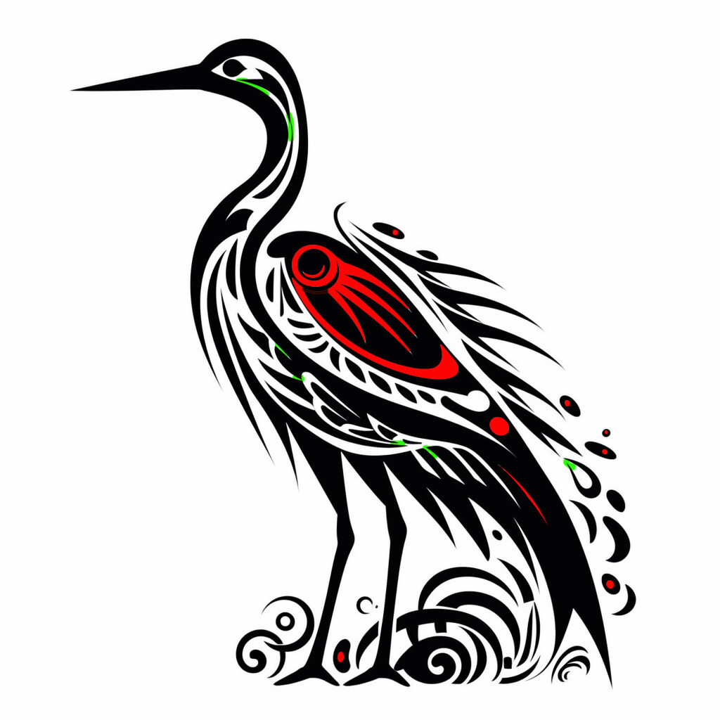

As mentioned above, on average, I need to spend about 45 minutes with an image to go from raw Midjourney to something that is easily traced in Lightburn. Beyond just separating out the object from the background to make it easier to trace, I need to deal with thin areas and islands. For example, in this image I would preserve the white, discard the black, and place the result against a dark background.
The areas I’ve marked in red are “islands” and a decision needs to be made on how to address them. I can connect the islands, discard them, live with them and glue up the multiple pieces, do a combined laser cut and laser engrave, or add another layer to encapsulate them. The areas marked in green are thin, and, if the laser cut object is small, may need to be bulked up to avoid being cut through by the kerf. I find connecting islands is easiest in Photoshop, but bulking things up is easier with the traced vector graphics in Lightburn. Here are a couple of examples of where I’ve combined laser cutting and laser engraving: If I’d done cutting only, the pieces would have fallen apart.

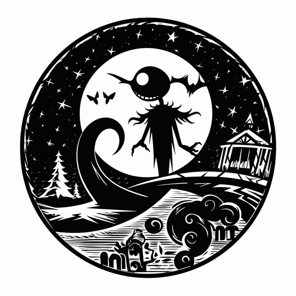

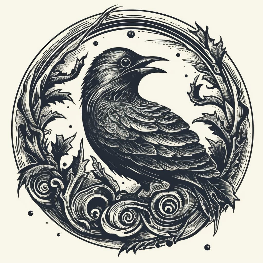

I spent my last month of Standard-plan-Midjourney time with variations of the same, simple prompts. The basis of that prompt is “Logo, stencil, silhouette <subject(s)>.” This base prompt tends to produce flat results, but there can be some grunge or complexity in the resulting image. Here is an example of an image generated with that prompt.

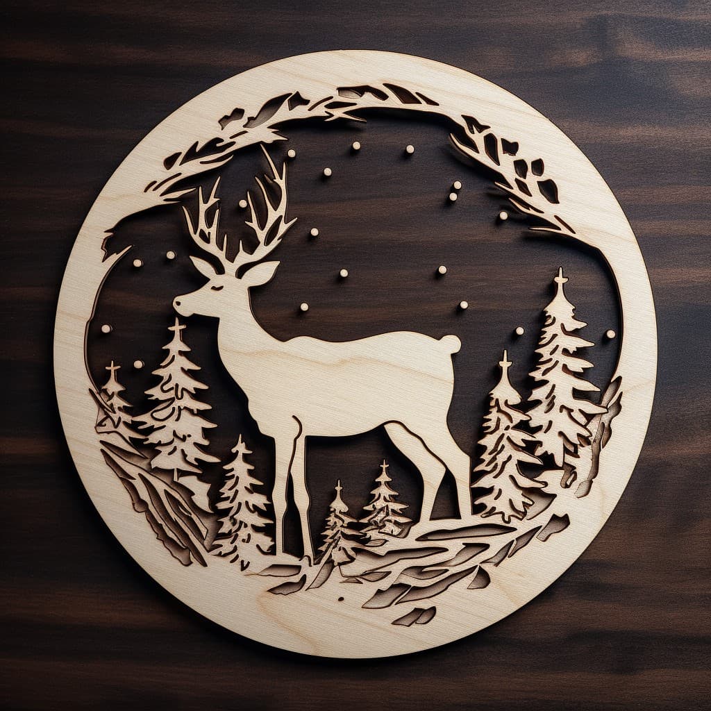

I often add “laser cut wood” to my prompts. The results are easier to visualize in terms of whether I want to make it irl, and they tend to more realistic to make (less islands), but they can require a lot more image prep in order to trace them. Here is an example.

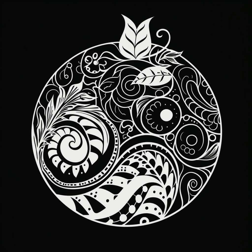

The complexity and style will vary greatly by the selection of the artist in a “In the style of ” addition. For example the following image uses the prompt, “Logo, stencil, silhouette, sticker, in the style of zentangle, simple, Christmas.”

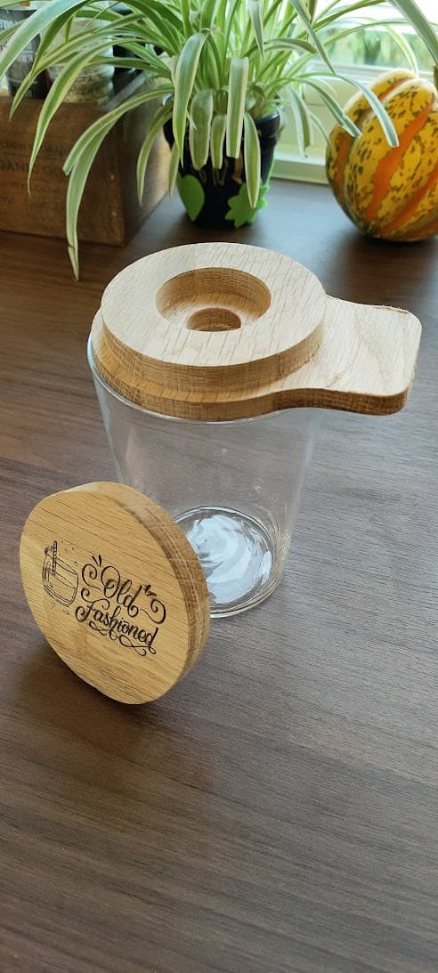

I needed a custom engraving for the top cover of a whiskey/cocktail smoker
First prototype with an off-the-shelf vector from freepik
Generated image with dall-e
