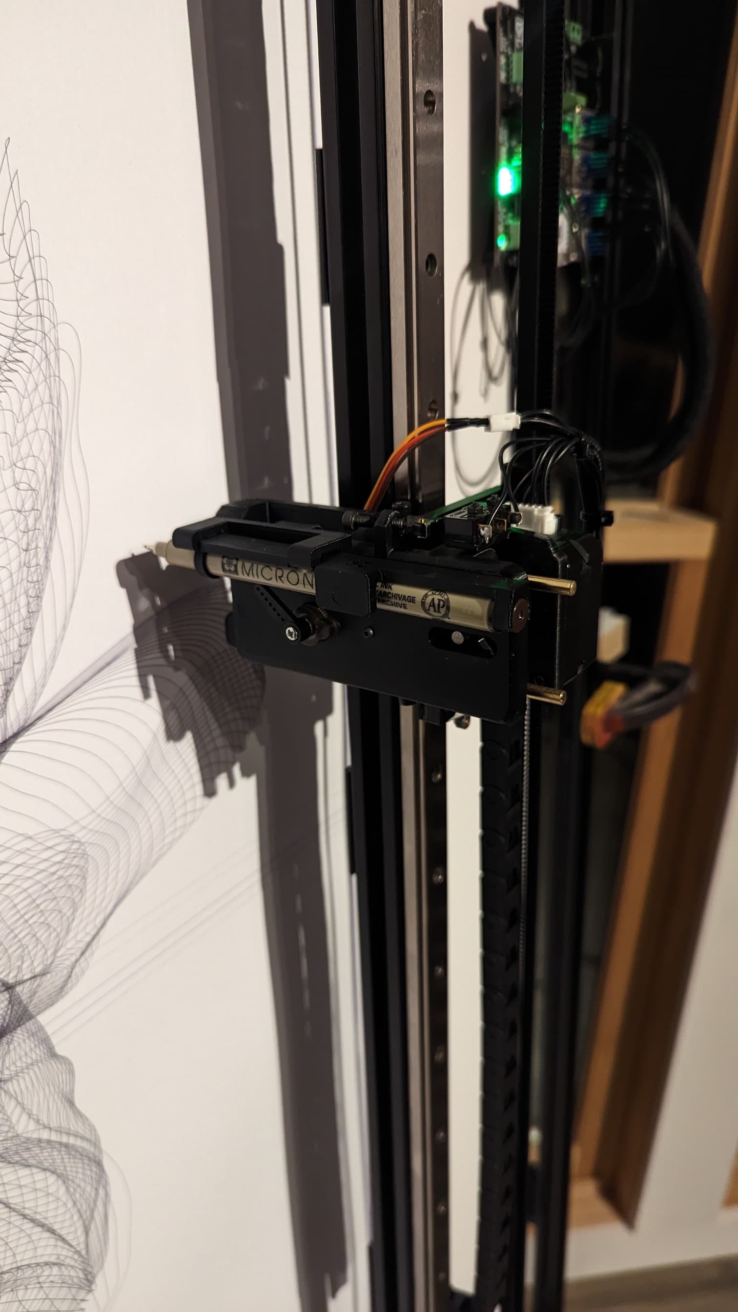

Now that you have a basic idea on the design, you need to contemplate to go with a corexy or a simple cartesian setup. You will achieve greater speed with the corexy because it allows you to eliminate a motor on the gantry. No motor means less weight which means less momentum which allows for greater speed. The drawback is that the design increases in complexity as there are a lot more belts and pulleys involved (more parts to design and build/print). My wall plotter is a simple cartesian that uses 2 motors to move the gantry in the horizontal direction and a third motor that sits on the top part of the gantry that moves the tool head in the vertical. It is much simpler than a corexy but that third motor has to move with the gantry. In my case, the weight of the motor is rather insignificant compared to the weight of the gantry itself, so its no big deal, but its a small motor because all I am moving around is a pen. Your motor will likely be significantly larger, so it might be a factor. Just something to consider before you get too far down one path.
I went with a small stepper to control the pen height. I do use a spring to keep the pen on the drawing surface, but I was thinking I might eventually get into brushes (brush pens actually), in which case the spring alone wouldn’t work so well. My design can accommodate different pens and brushes if I get that far. When I find a new pen I want to use, I design a caddy for it, so all the different style pens can sit in the same tool bin. I’ll take a few pics to better explain…
I don’t think these pics do much to explain the mechanism, but here they are. One with a pen and one without. The pen holder rides up and down on two brass rods (on four bearings). The pen is lowered to the paper by the Z stepper but not forced to a specific height. Like an old turntable lowering a stylus to a record. Except, it can’t use gravity, so there is a spring involved.
Edit: In the case of a brush, it can be lowered to a specific height. So, best of both worlds.

I like that pen holder. I saw where a servo might serve better as a pen Z-axis as they re-zero? What’s your opinion on that? Plus I can imagine this machine is going to be very noisy. Are servos a no go, complexity wise?

Yes, technically you could accomplish the same functionality in my pen holder with a servo instead of a stepper. And once calibrated, a servo remembers where home is, whereas a stepper needs to re-home whenever power is lost. Servos are significantly louder. There isn’t really a right or wrong. Personally, I like the grace of a stepper if you can accommodate the size and weight. To me, a stepper is like Matthew McConaughey and a servo is Bobcat Goldthwait. You can tell them where to be and when, and they’ll both get there, but Matthew is going to make a smoother entrance, every time. OK, maybe a bad analogy, but it’s 8pm and I’ve had a few.
:rofl: :rofl: We are focusing on keeping the weight down and now you throw that C-axis back into the mix. As long as it doesn’t have to move very fast, I think you can find a place for it. This is why GRBL has a speed setting.
You need to put that mat cutter back on the shelf and save it for another project. Not only is it way too big and heavy and would be comparable to using a sledge hammer to hang a picture on the wall, it looks like it has a rotary encoder on it. Way too complicated if all you want to do is spin a brush. Making a brush holder that can be controlled by a C-axis servo wouldn’t be that difficult and would weigh very little. If you needed more than 180 degrees of rotation, a servo probably wouldn’t do it. In that case maybe use a stepper like they use as extruder motors on direct drive 3d printers. Very lightweight and easy to interface with the rest of the machine controls.
