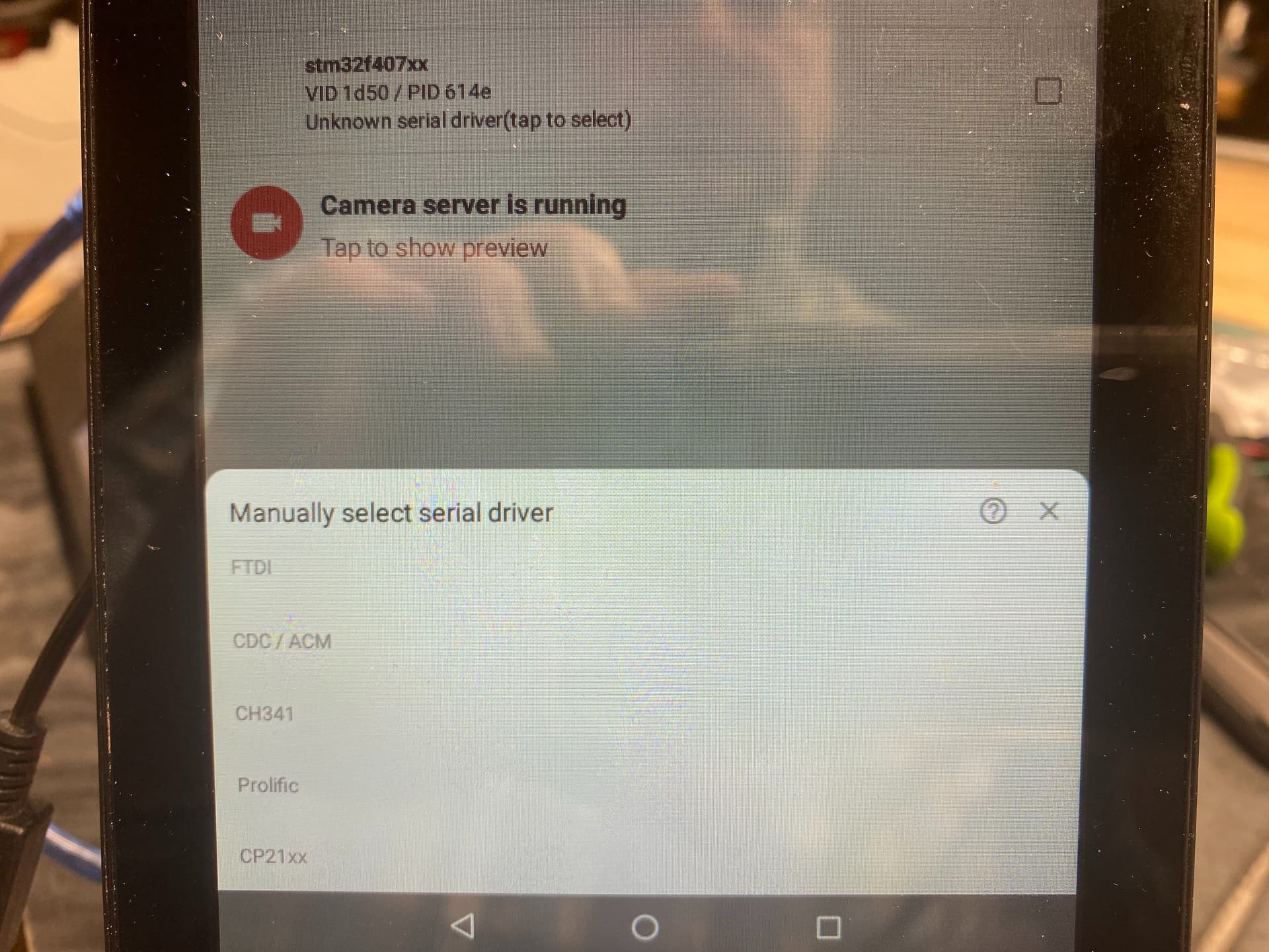

I’m so close. I’m trying to sort out the serial driver and baud rate for BIQU B1 printer with an SKR 2 main board.
Of the two issues in this image, the first is solved, re. Octoprint now starts like it should. But the second issue “unknown serial driver(tap to select)” and tapping does nothing, is still happening:
STM32F407xx
VID 1d50 / PID 614e
Unknown serial driver(tap to select)
The chip on my SKR2 board is definitely STM32F407. I carefully checked. It seems that Octoprint currently thinks that’s an “Unknown serial driver” situation.
PS: I built the firmware.bin file using a Raspberry Pi. I tried to run “make menuconfig” on the Amazon Fire7 tablet, and it seems the OpenSSH in the Octo4a install does not know what to do with that.
So I completely misunderstood “(tap to select)” — I thought it was saying to tap the empty check mark box.
But by tapping the serial driver name area, it brings up a list of choices:
Now I just need to figure out which of those choices goes with STM32F407.
Third one or last one
Try cp21. The ch341 is the ftdi knockoff and if we got this stuff from China it isn’t ftdi.
