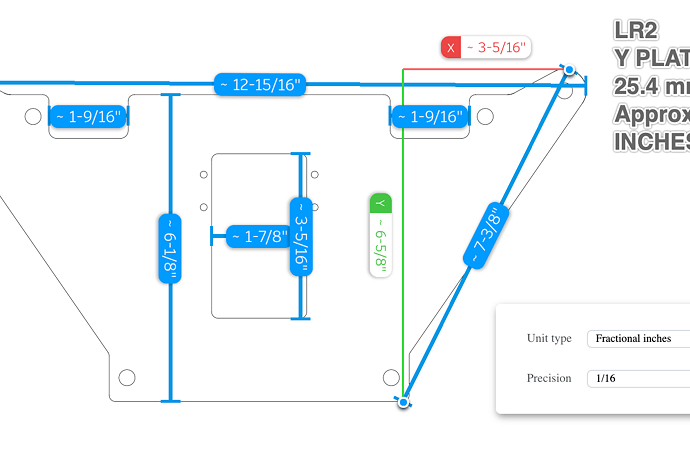

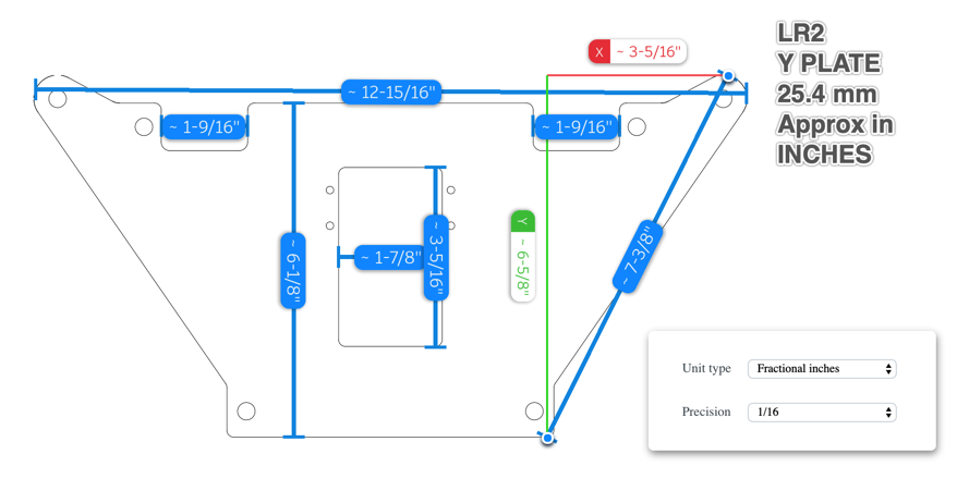

I also did some measuring from the original DXF file. I’ll attach that PNG file to this post. I had to manually pull the lines when measuring so I won’t vouch for 100% accuracy. Measure for yourself, but this will give you an idea. I do not know the size of the holes or drill bits needed at this point, but I’m sure there on the website somewhere.
Thanks for all the help, especially Jeff, Ryan and Barry. I’m sure I’ll have many more questions the further I go.
Someone look at my measurements and see if they look correct please.
Steve
That looks correct. I forget the size of the holes but can check. I just put my calipers to them to get a measurement and then picked the correct sized drill bit. The diameters of the holes aren’t as important as the spacing in-between the centers of the holes (center to center need to line up so the plastic printed parts will fit correctly. The hole sizes themselves are big enough for the bolts to go through.
