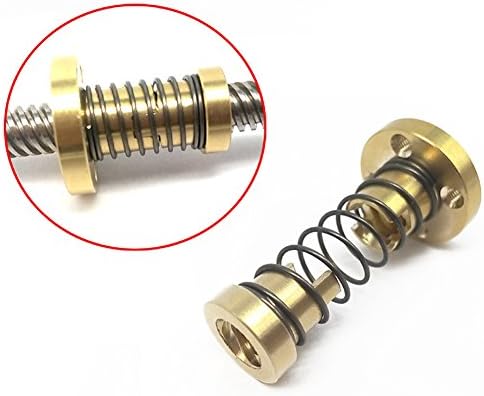

This is a tough one for a rigid coupler because of the high chance of one side lowering before the other. Damage is sure to happen. This needs some ability to bend, so either a flex/hinge mount at the nut or trap the spring coupler a little better with two bearings. I am not sure.
Or the new anti backlash nuts for these rods might add enough friction to help hold it up by itself then we can switch to rigid couplers.

Interesting nuts.
