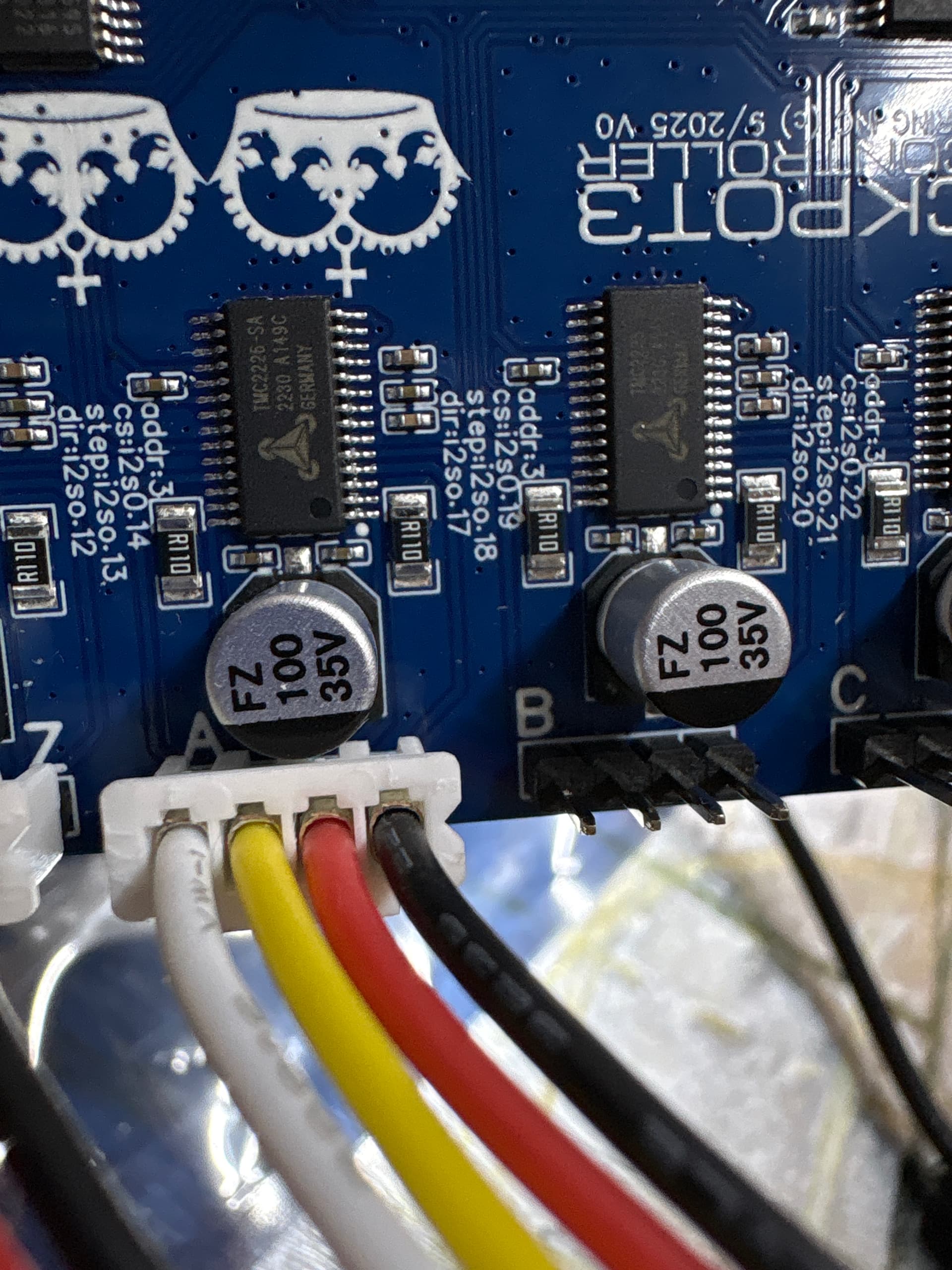

Hey all I’m trying to get my jackpot3 working but the y axis only works when plugged into z slot and y2 output doesn’t work at all. Anyone have the pinout of this board? Also the addresses for the last 3 drivers are all the same on the board mask? Is that right?
Yes. Chip select outputs (which are different outputs) allow for multiplexing the drivers.
Ok that’s cool, but still the web interface only moves one of the y axis drivers using the y button when its plugged into the z driver slot
Use the jackpot v3 config.yaml not V1or v2
And post the results of $SS from the terminal
$SS

This is config.yaml from the board as well:

Anyone see anything?
No, everything looks normal. Try one known good stepper and test each Port making sure to power down completely before you switch it.
Make sure all your end stops are plugged in and functional.
The z stepper port works as a y axis connection. Doesn’t matter which stepper I plug into it. I’m wondering if maybe I should just reinstall fresh fluidnc 3.9.9 and rebuild the config from the config yaml that way
When I plug the second y in, the first y goes slowly. I don’t understand what’s happening
That does not look like a stock Jackpot V3 config file. What exactly have you changed?
For example, this is different in stock VS yours:
motor0:
      limit_neg_pin: gpio.25:high
Note the :high suffix.
I didn’t touch that
But I AM an idiot, so lemme go reflash the firmware and config and reupload the config
ok reinstalled 3.9.9 fresh install, uploaded the JP3_LR config.yaml from here, ill let you know what happens
changed for my steppers, 50steps → 80steps
position x and y 3mm → 0mm
nothing else changed,

      limit_pos_pin: gpio.32
      limit_all_pin: NO_PIN
      hard_limits: false
      pulloff_mm: 4
      tmc_2209:
        uart_num: 1
        addr: 2
        cs_pin: NO_PIN
        r_sense_ohms: 0.11
        run_amps: 0.8
        homing_amps: 0.8
        hold_amps: 0.7
        microsteps: 8
        stallguard: 0
        stallguard_debug: false
        toff_disable: 0
        toff_stealthchop: 5
        toff_coolstep: 3
        run_mode: StealthChop
        homing_mode: StealthChop
        use_enable: false
        step_pin: I2SO.10
        direction_pin: I2SO.9
        disable_pin: I2SO.8
    motor1:
      limit_neg_pin: NO_PIN
      limit_pos_pin: gpio.34
      hard_limits: false
      pulloff_mm: 4
      tmc_2209:
        uart_num: 1
        addr: 3
        cs_pin: i2so.19
        r_sense_ohms: 0.11
        run_amps: 0.8
        homing_amps: 0.8
        hold_amps: 0.7
        microsteps: 8
        stallguard: 0
        toff_disable: 0
        toff_stealthchop: 5
        toff_coolstep: 3
        use_enable: false
        step_pin: I2SO.18
        direction_pin: I2SO.17
        disable_pin: I2SO.16
i2so:
  bck_pin: gpio.22
  data_pin: gpio.21
  ws_pin: gpio.17
spi:
  miso_pin: gpio.19
  mosi_pin: gpio.23
  sck_pin: gpio.18
sdcard:
  cs_pin: gpio.5
  card_detect_pin: NO_PIN
  frequency_hz: 20000000
probe:
  pin: gpio.36:low
  toolsetter_pin: NO_PIN
  check_mode_start: true
start:
  must_home: false
coolant:
  flood_pin: NO_PIN
  mist_pin: NO_PIN
  delay_ms: 0
control:
  safety_door_pin: NO_PIN
  reset_pin: NO_PIN
  feed_hold_pin: NO_PIN
  cycle_start_pin: NO_PIN
  macro0_pin: NO_PIN
  macro1_pin: NO_PIN
  macro2_pin: NO_PIN
  macro3_pin: NO_PIN
macros: {}
user_outputs:
  analog0_pin: NO_PIN
  analog1_pin: NO_PIN
  analog2_pin: NO_PIN
  analog3_pin: NO_PIN
  analog0_hz: 5000
  analog1_hz: 5000
  analog2_hz: 5000
  analog3_hz: 5000
  digital0_pin: gpio.26
  digital1_pin: gpio.27
  digital2_pin: gpio.0
  digital3_pin: gpio.2
OK, we need another pair of eyes here. I just now downloaded Ryan’s latest config file.
Excerpt from his:
axes:
  x:
    steps_per_mm: 50.000
    max_rate_mm_per_min: 9000.000
    acceleration_mm_per_sec2: 200.000
    max_travel_mm: 1220
    soft_limits: false
    homing:
      cycle: 2
      positive_direction: false
      mpos_mm: 3
      feed_mm_per_min: 300.000
      seek_mm_per_min: 1500.000
      settle_ms: 500
      seek_scaler: 1.100
      feed_scaler: 1.100
    #X
    motor0:
      limit_pos_pin: NO_PIN
Same Excerpt from yours (Note differences including the same GPIO difference I spotted above with respect to X motor 0)
axes:
  x:
    steps_per_mm: 80
    max_travel_mm: 1778
    soft_limits: false
    homing:
      cycle: 2
      mpos_mm: 0
      settle_ms: 500
      seek_scaler: 1.1
      feed_scaler: 1.1
    motor0:
So the one that I uploaded from the releases page works. I’m going to use this. Also, do I need to alter anything to run the laser? I’m using gpio.27
You should verify those settings work for your laser/laser CAM (e.g. the spindle map).
You’re using the better GPIO option already…
From the docs:
Input / Output / Module notes
  • gpio.26 can have a quick pulse when starting. If you are using a 5V pin for your laser gpio.27 is the better option for your enable pin.
EDIT: You don’t have a laser section in the default, when you add it you need to remove the GPIO.27 entry from the user_outputs section.
Edit 2: the laser section of your earlier post looks OK to me:
user_outputs:
  analog0_pin: NO_PIN
  analog1_pin: NO_PIN
  analog2_pin: NO_PIN
  analog3_pin: NO_PIN
  analog0_hz: 5000
  analog1_hz: 5000
  analog2_hz: 5000
  analog3_hz: 5000
  digital1_pin: NO_PIN
Laser:
  pwm_hz: 5000
  output_pin: gpio.27
  enable_pin: NO_PIN
  disable_with_s0: false
  s0_with_disable: true
  tool_num: 0
  speed_map: 0=0.000% 1000=100.000%
  off_on_alarm: true
ok added laser code to config. test passed from the webui so i think im all good! thanks all!
Problem solved by loading official release, i also am powering the board and the laser from separate leads directly from the same 24v power supply, so they still share same ground and all that.
Solution:
  1. Use config from here: Releases · V1EngineeringInc/FluidNC_Configs · GitHub
  2. Don’t be an idiot. Follow the directions from the documentation.
