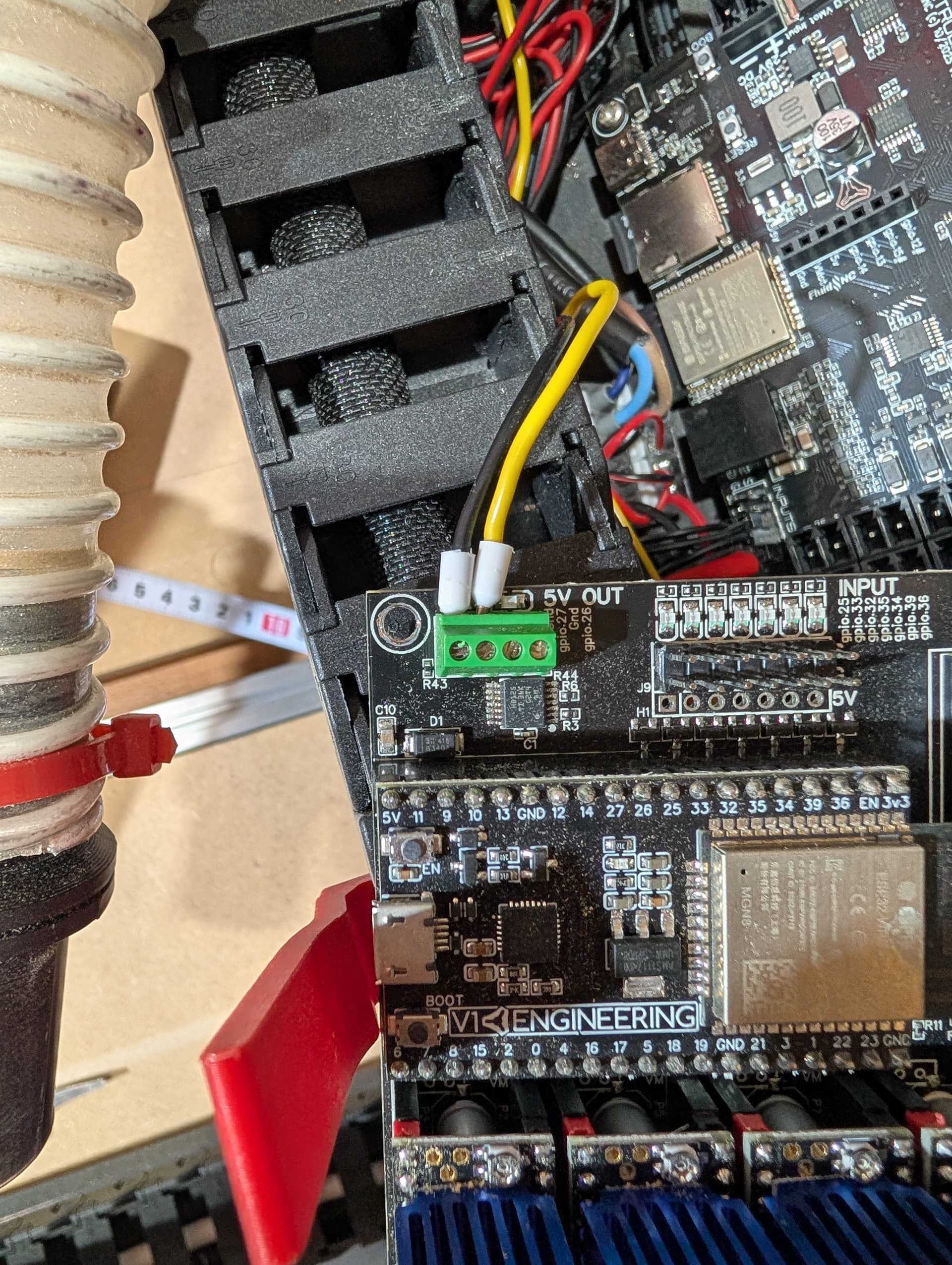

On the Jackpot I used to have my laser wired as below on gpio 27:

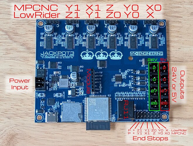

Where on the jackpot3 should the black and yellow wire go? On the image below I see where the gpio27 is. Should it go on the 5V row with yellow on + and black on -?
Thanks in advance
Red port #2, #27, or #26, edit the yaml with your pin choice.
zero gets a slight momentary blip on boot, adding this to the docs
Based on the Jackpot wiring, yellow on + and black on -?
yes.
