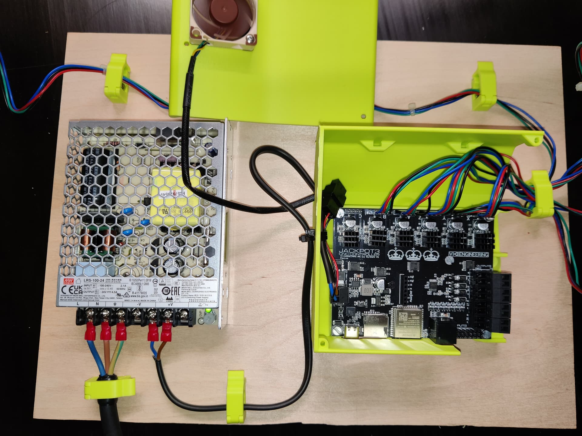

Today i wanted to make the first movement tests so I wired everything up und plugged in the power (24V to the Jackpot3 power input), but nothing happened and I could not connect to the Jackpot3 via browser, like I could, when I was flashing it. Then I noticed, that the 5V LED on the board wasn’t light up (like it was when flashing the ESP via USB-C port). So I additionally connected my laptop to the usb port and the 5V LED now lighted up and I could connect to FluidNC via my browser.
While/after flashing the ESP with FluidNC, there was the initial error because of no external power to the drivers. This error did now disappear, so I thought everything is fine now and I tried to move the steppers. But sadly there was no reaction or movement when I tried. The axis position indicators in FluidNC did show the new position but there was no real movement.

You should not have to supply USB power to the board. Can you post a pic of your board wired up please?
In the terminal in the webui use the $SS command to show us the output please?
Do you have a multimeter to test your power supply?
The board has a 5V regulator downstream from the 24V input, the USB port inputs its own 5V and they are separated by a diode.

Here is the picture of the wiring (sorry since I’m new to the forum, I can’t post a picture directly nor the link to the upload - so here is the link (without https) to the picture uploaded on imgbb com for copy&paste :sweat_smile:):
ibb.co/dsfkR1Xt
I just wired it temporarily to check if everything is working correct, before doing the final wiring at the MPCNC, since I want to build an enclosure around it. Every stepper is directly connected to the Dupont Plugs on the Jackpot3, the 24V power supply is connected to the power input of the board and to a 24V case fan. Power is on while I took the picture. The onboard 5V LED is off and only lights up if I connect 5v power to the usb port.

The main thing I wanted to check was that your power supply wasn’t backwards. And it appears that it is correct. So its not that. Can you take a multimeter and verify your power supply is putting out 24v?
Edit.. @MakerJim beat me to it with the pic
Also, how did you do the termination of wires into the connector for the Jackpot?
Preferred would be to take the two very different AWG wires of fan and power supply and crimp them into a ferrule before landing them in the jackpot connector. Ferrules always being preferred even on single stranded wire runs into screw compression clamps.
Right now both, the fan with very thin standard cable (maybe awg 22 / 24) and power supply with awg 20 are directly put clamped into the screw terminals for first test right now. I think you are right and I should crimp them in a ferrule when doing the final wiring. Contact with these cables to the screw terminal should be fine for now, since I measured the voltage at the screws of the screw terminal and the fan is running without any problems.
The measured voltage there is 24.04V.

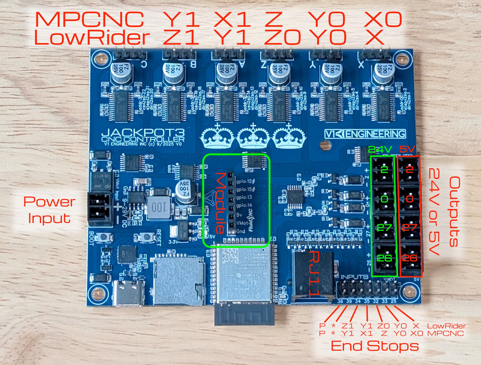

If you have fine tip DMM leads, we can walk the supply voltages around. The easiest way to do that would be to put the (-) lead on the USB-C connector shell, then probe the expansion header VMOT and 5V power locations.
They’re as shown below on the expansion module header just above the ESP-32:

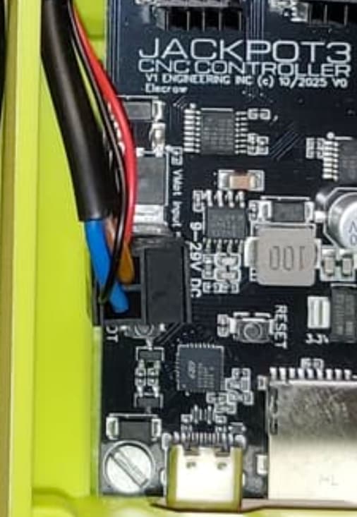

Make sure this connector is seated all the way down…
I am wiring one up right now. Plugged this in and thought it had, but felt it wiggle just a touch when I let go. Turns out it wasn’t all the way in. So make sure it is seated all the way to the bottom of the connector. I really think it was just the angle and my fat fingers that hindered me but when it happened I figured I would mention it here.
Solved it! And feeling really dumb right now!
The plug was seated well to the bottom of the connector, but you made me check the connections again and crimping ferules to the wires. Plugged back in and it is working now.
