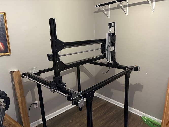

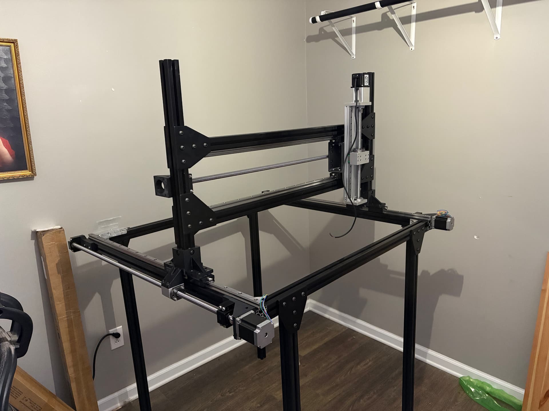

Oh, I have a completely novel machine but I like the boards.
Ball screws everywhere, linear bearing blocks, built for the hyuangsang 2.2kw er20 spindle. Using the jackpot2 currently but will switch to jackpot 1 for the enable, step and dir outputs from the board for external drivers and closed loop stepper

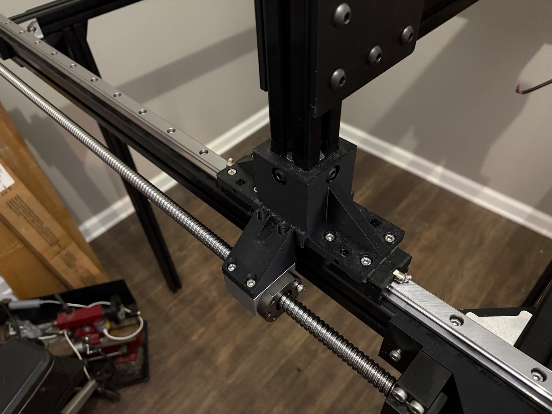

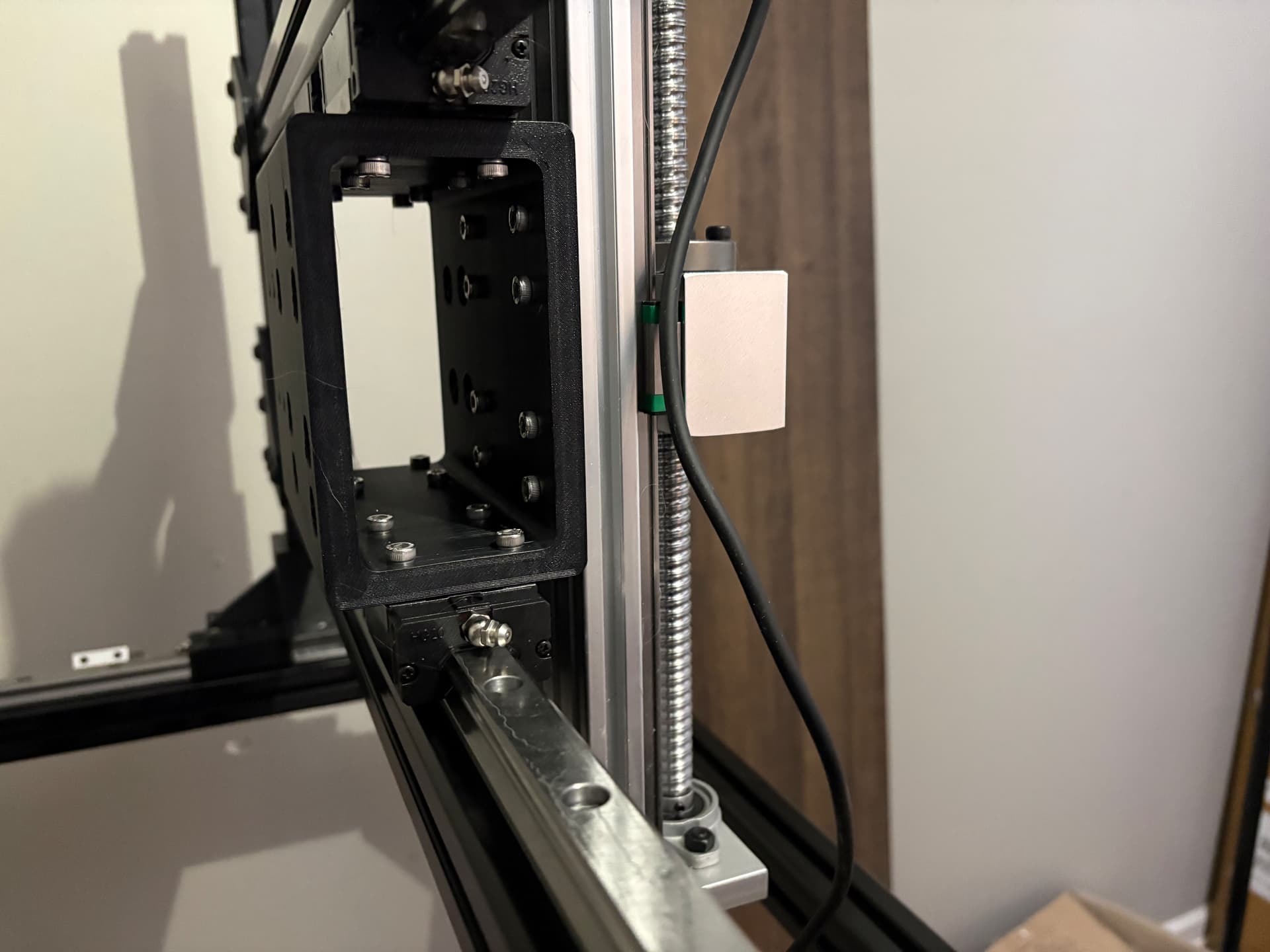

Interesting. Definitely needs some side plates or it is going to be really flimsy with just the aluminium profiles joined with the 3D printed bracket. Keep us in the loop, you can surely get some great input here. :slightly_smiling_face:
I’m going to use it to make aluminum brackets and replace all the 3d printed stuff.
