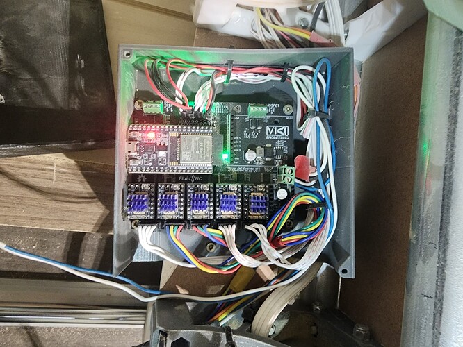

Jackpot overheating issue
I’m facing a problem that I believe it’s due to drivers overheating usually one of the motors will stop working and if I reset and continue everything stops while the the board still powered on, alot of time I loose wifi connection after running for a while, any solution please or should I switch back to Marlin.

You haven’t really provided any details to help us help you. Here’s some things you can provide:
  • What kind of machine do you have?
  • Can you post pictures of your machine, and in particular the as-wired/as-installed jackpot?

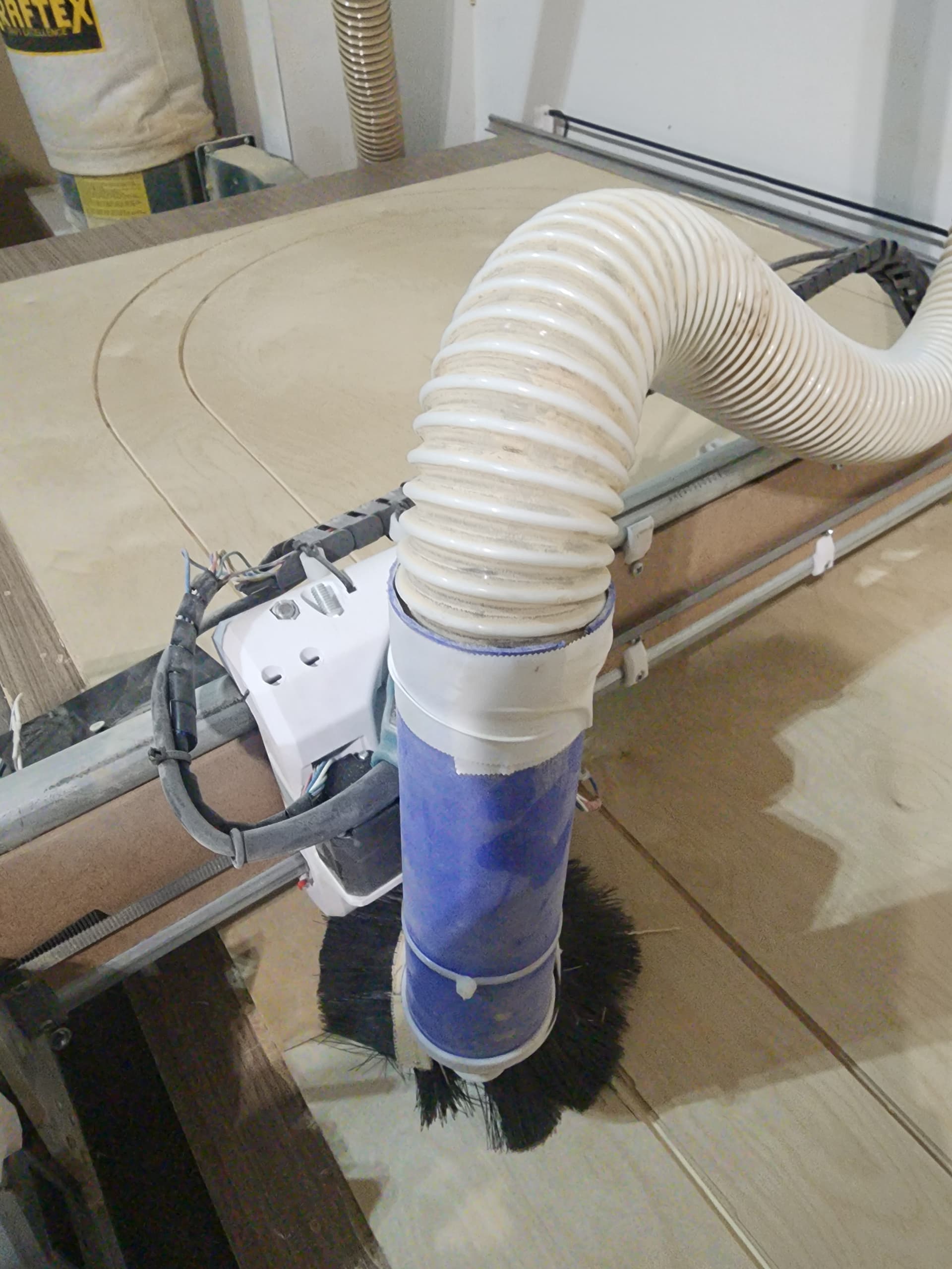

  • Do you have dust collection on your machine? If so, is it grounded, and if it is grounded, how?
  • Is your board configured in AP mode or STA mode?
  • What version of FluidNC and WebUI are you running?
Do you have dust collection on your machine? If so, is it grounded, and if it is grounded, how? I can admit my ground is not the best I’m wrapping naked wire around the hose connected to ground point

Blow the dust off your board.
Is your fan pulling air through the case or pushing it into it? It should be pulling, that should reduce dust build up.

I regularly do clean the board and the fan is pulling the air
Best not to use a vacuum for that. The static electricity buildup can be brutal.
A soft brush, anti-static vacuum or canned “dust-off” are better choices.

Do the steppers get warm, or hot? To be honest, we do not work the drivers or the steppers very hard. I didn’t use a fan on the drivers for most of my jackpot1’s life and I turned up the drivers for speed tests.
I am really not sure how to diagnose this.
There’s still the usuals:
  • connect FluidTerm and run the job, show the output from the job.
  • Explore how the job is being run. From sender, from starting a job from WebUI?
  • Pull the dust collection hoses and grounds, chase the router with a blower to remove chips while troubleshooting. Does it still stall?
  • (For the AP)- what kind of client computer, what signal strengths being reported? What channels are in use? Do you have access to a WiFi signal strength app on a device [phone or tablet]?
  • To rule in/out overheating, use an IR pyrometer or IR camera to show temps. IR pyrometers are like $25 at the import tool companies and very much worht having in the tool box. Temps we care about are the temps on the heat sinks, and the temp of the ESP-32 processor.

I belive i tyied cutting before without vacum hose as i just don’t remaber the results i got but i can try again.
laptop and signal are good as im close to the maching the issue i loose connection compltly after a while of runing for some instance the machine cotinue runing with no issues just no wifi connection and somtimes i loose both the wifi and the movment.
I will try to capture with iR pyrometer
