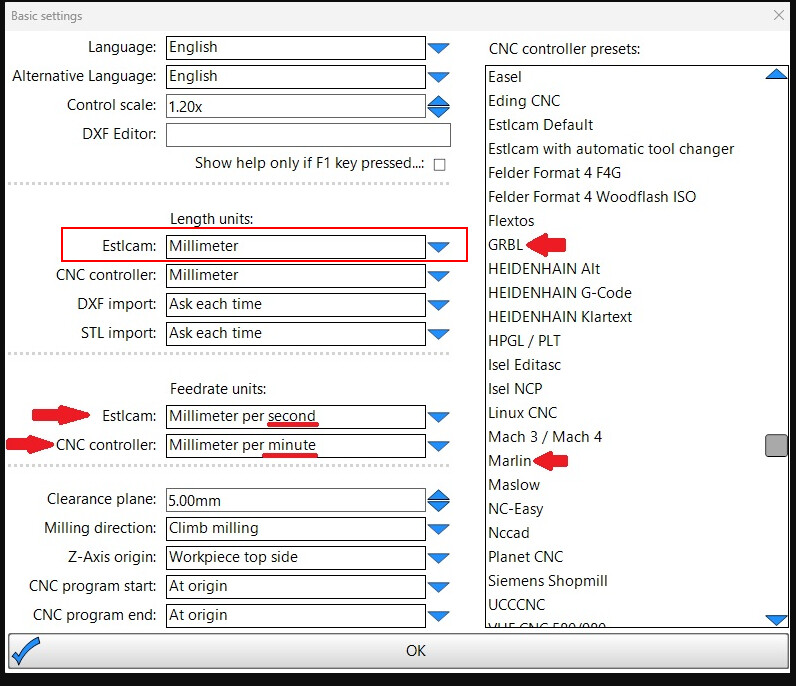

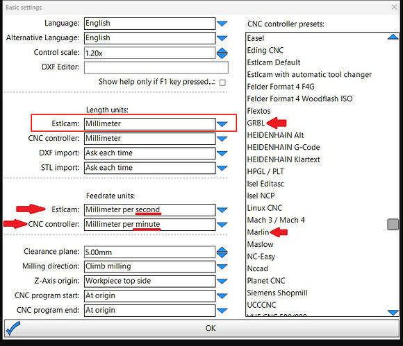

I would verify again that EstlCAM is set correctly, then output the file again and make sure the start GCode looks right

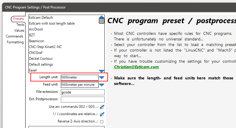

oh wait… Those first 3 lines are added there, probably from your settings in EstlCAM, not the start GCode.
Make sure your length unit is millimeters in the settings
EstlCAM 12:
EstlCAM 11:
Thank you! I’ll go back over everything and make sure it’s all correct before saving again.
That was it! I had changed the Feedrate units but I forgot to switch over the length units.
