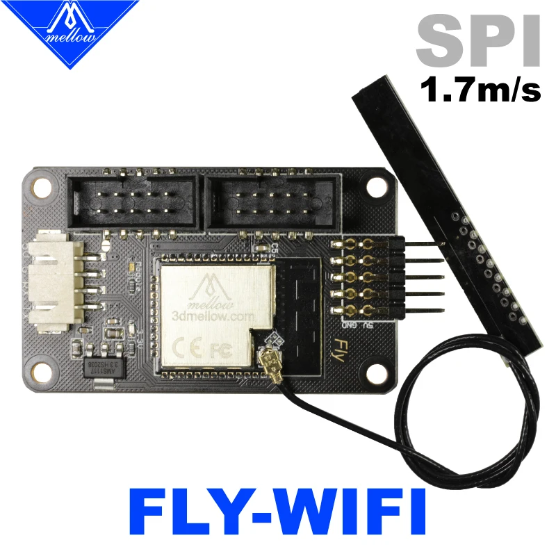

Chinese manufacfurer Mellowfly has a port of DWC that runs on an ESP, and is available as an add-on.
Hmmm. I thought this was an ESP8266, but the description says it’s an ESP32. It has a serial UART connection and seems to use the 10 pin LCD connectors as well for the SKR Pro. Of course it’s developed for RRF firmware, I wonder if the DWC could be developed for FluidNC/GRBL. (It’s a really nice interface.)
