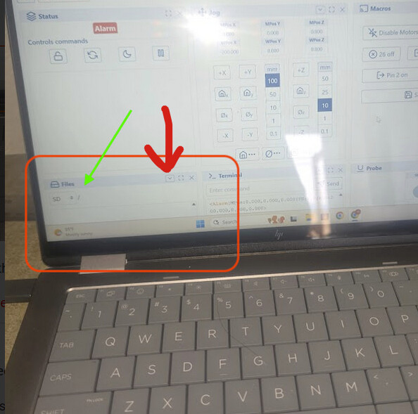

ok it doesnt give me an option to upload. so cant i just delete existing files and start over with the ones i downloaded? and by reboot you mean restart right?

The red arrow here should give you a drop-down with more options including upload if you can’t drag and drop.
In this picture the green arrow is where you need to click and change to the flash section, not the SD section,

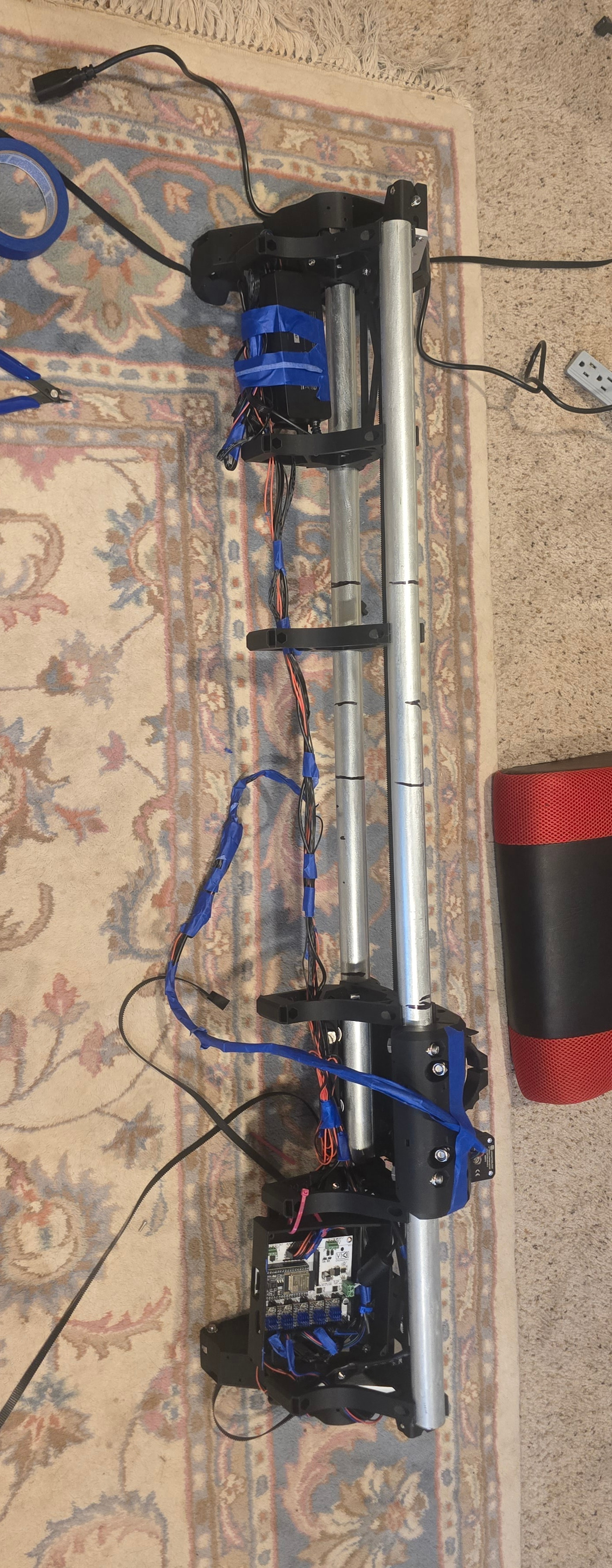

i uploaded the files.. idk that control must be shot. so now i have the original jackpot and its programmed for mpcnc.. i uploaded the lowrider stuff and it kinda works. yo/zo side is moving faster than y1/z1 side. lol. just bought the jackpot 3 again agian. all the wiring is cleaned up and unless i can use j1 for lowrider 4 i think it’ll work when the j3 gets here

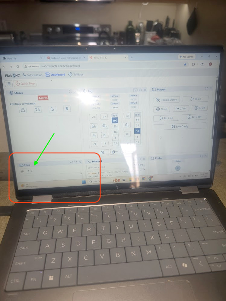

What files exactly? Can you show a screenshot of your “flash” section and the files that are in it.

ok all the files i tried uploading previously are the ones that were on it. now with the jackpot 1 i only uploaded the lowrider config that i got from jackpot 3. what files should i upload?? uploading files to the jkpt3 did not work at all. uploading files to jackpot 1 worked to change it from mpcnc to lrcnc but the motors y1 and z1 seem to move maybe a tenth as fast as the y0 z0. I definitely shorted the first jkpt3 with metal and the second i unplugged ports while it was powered on
If you are using a jackpot 1 only use those jackpot one files. If you have a jackpot 3 only use those files.

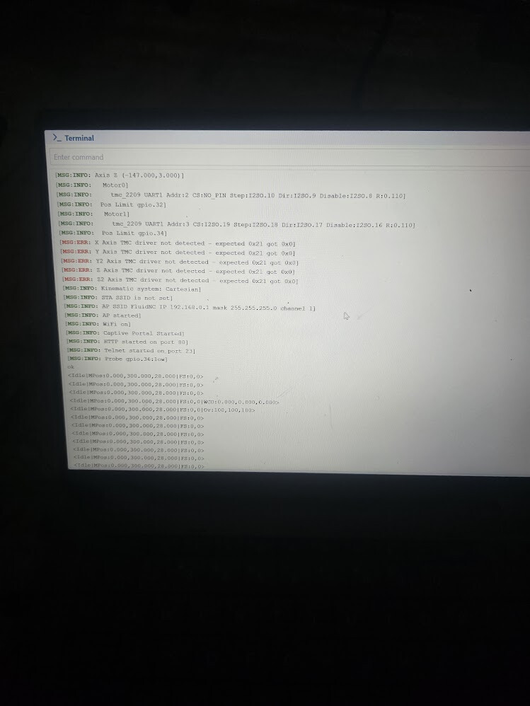

This is a little confusing. If you have both boards lets just troubleshoot one at a time. Which one do you think works best?
In this picture the config looks normal, the errors are showing up becuase the board is not powered on.

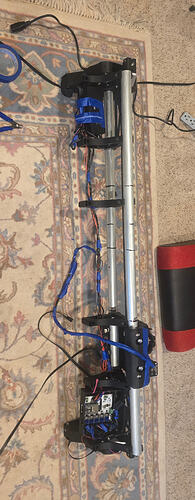

this is jackpot 1. its definitely powered on. i can take a video. y1 and z1 are working at a fraction of the y0 z0 motors.
how do i configure jackpot 1 for lowrider 4? it came ready for mpcnc
