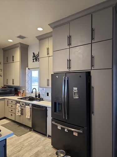

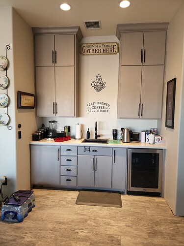

The doors in the pic are one piece, with a decorative cut on the front.
Actual rail and style doors are how you make doors out of hardwood. They are stable and they use less wood (the panels are thinner). In modern manufacturing, standard sizes of doors are churned out by factories and they use that style to same a lot of material. That isn’t an american thing, is it? To me, depending on the design choices, it can invoke either “high class” or “hard working country” style. That usually comes down to a clear finish vs paint.
After you have chosen the door, the hinges are a separate decision. The european style hinges are hidden, and can do soft close. Those style of hinges are the norm for cabinets.
In this piece, this is going to be a hard working, form and function cabinet. The hinges are high on function. The doors are stable, durable, painted. The decorative element adds something to look at. It makes it more obvious there was some thought put into it, and it (to me) invokes a bit of a country style.
Seems totally reasonable. I don’t know why anyone would question it. But I am American. I wonder what is different about the rest of the world. I assumed it was common. Mostly because Ikea uses the combination a lot:

I don’t think we’re talking at crossed purposes here - I cannot remember the last time I’ve seen a face-frame - or a cabinet that didn’t have “Euro” style hinges. I am talking utilitarian cabinets here not fancy high end stand-alone joinery pieces. The frame is redundant as the hinges can either finish with the door flush with the face of the cabinet ends or sitting proud of it.

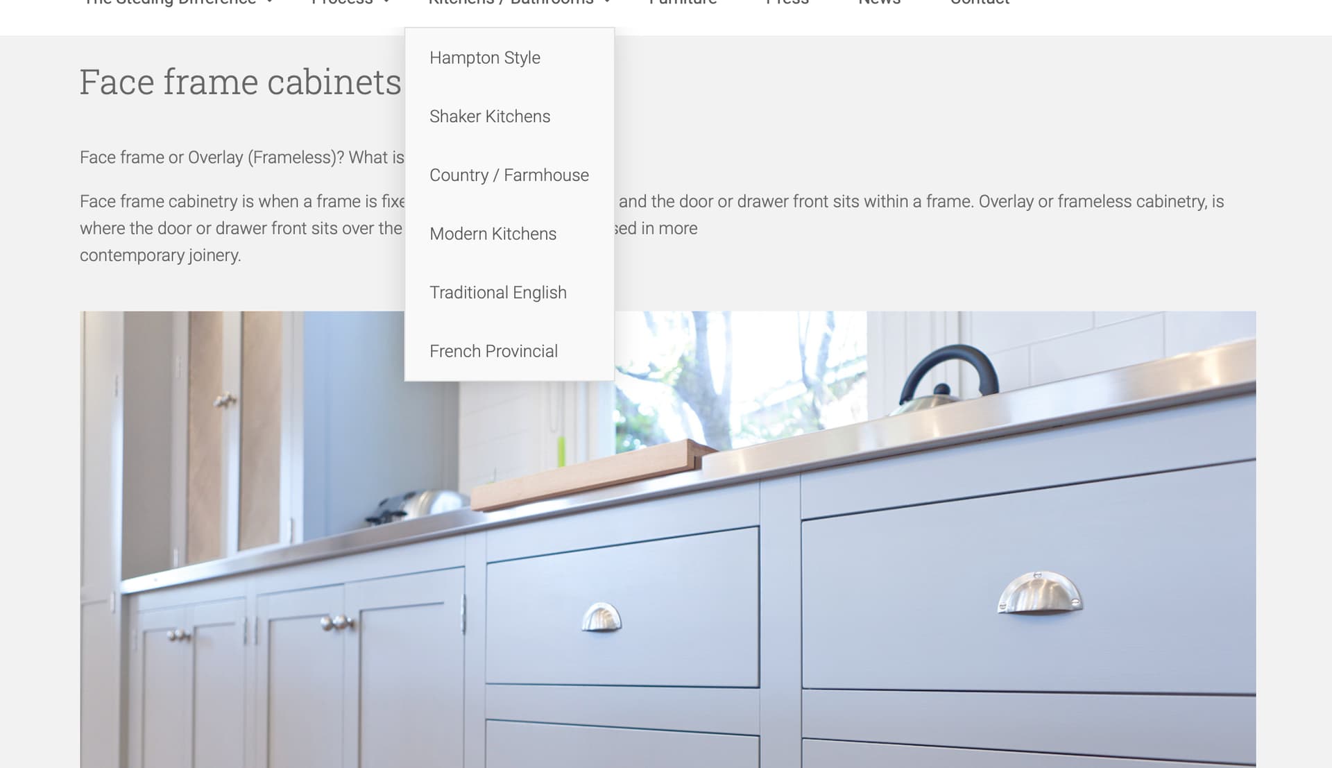

The circle has turned now - with housing values at stupidly high rates and people apparently falling about looking for ways to spend money - this from a quick search - kitchen cabinets at TEN times the price of standard manufacture! I understand that for those of you in North America this is not unusual - but here it’s extraordinary!
For all of the above, I missed the point! :smiley: Note the styles in the shot above from a “high end” Australian manufacturer - “Hampton”, “Shaker”, “Country Farmhouse” are unmistakably American - and ironically the “French Provincial” and “Traditional English” styles are too, and in this context are marketing terms! :wink:

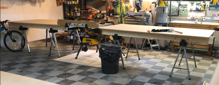

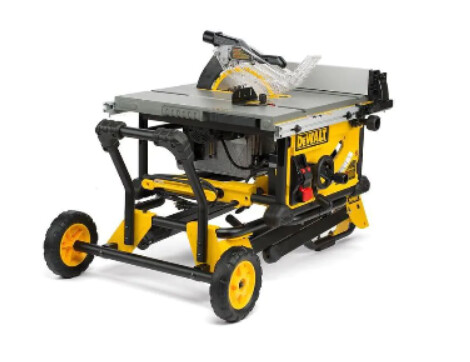

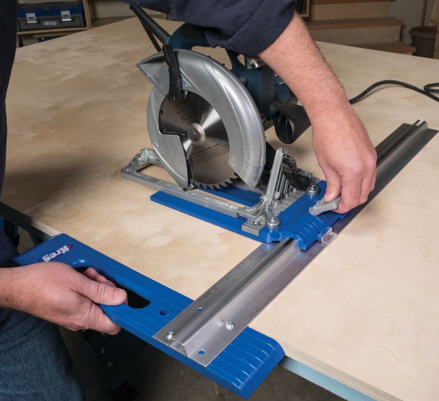

Late to the party but I wouldn’t recommend a CNC for straight cuts on sheet goods unless you are doing more complicated cuts at the same time. dewalt makes an excellent contractor’s table saw with legs that fold up tiny enough to tuck into a pretty small space. I’m really happy with mine. Some 2x4s you can setup temporary feed tables and tackle just about anything. This all packs down small enough to go under a workbench (or low rider table) easy. They’ve been out for awhile so I’ve seen them used cheap. Also, instead of a table saw for cutting stock Kreg makes a really good circular saw attachments I use mine all the time for very long cuts with a piece of foam on the floor it’s more convenient and accurate (a couple hundredths of an inch).
Let’s say I’m buying prefinished 3/4" baltic birch.
Making some cabinet doors.
I cannot fine-tune a dewalt saw enough, i cannot spend enough on blades, i cannot alter my technique enough to avoid chipping on the bottom side without sacrificial boards.
You say no to cnc for straight cuts? I say you can’t cut melamine on your dewalt, let alone veneer.
I use a similar saw. They are very adjustable but not easily so and cut very accurately once calibrated and stabilized.
You need a special blade to cut melamine without a sacrificial board or tape. Technique won’t cover for the wrong cutter.
Not when your comparing it to a machine designed specifically to make straight cuts.
Clearly not true. A calibrated saw, a clean sharp blade, and resisting the urge over-feed will have those panels cut before the CNC is even programmed.

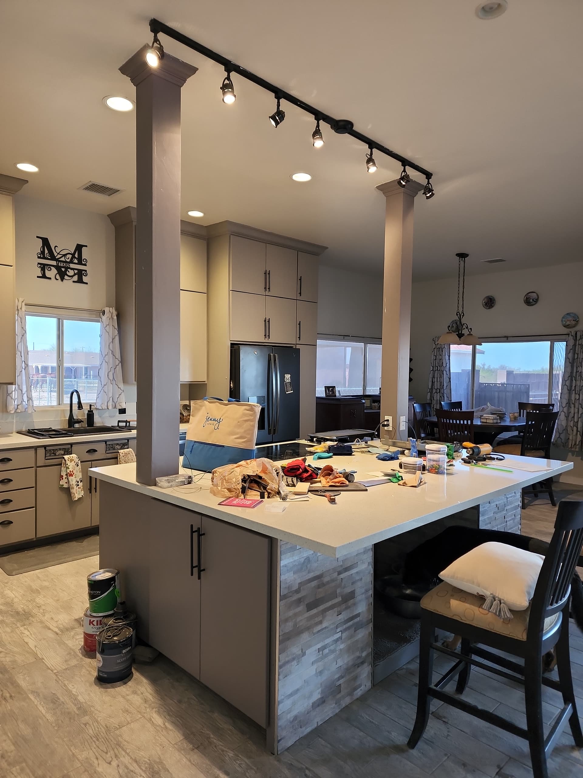

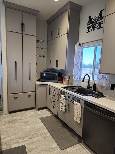

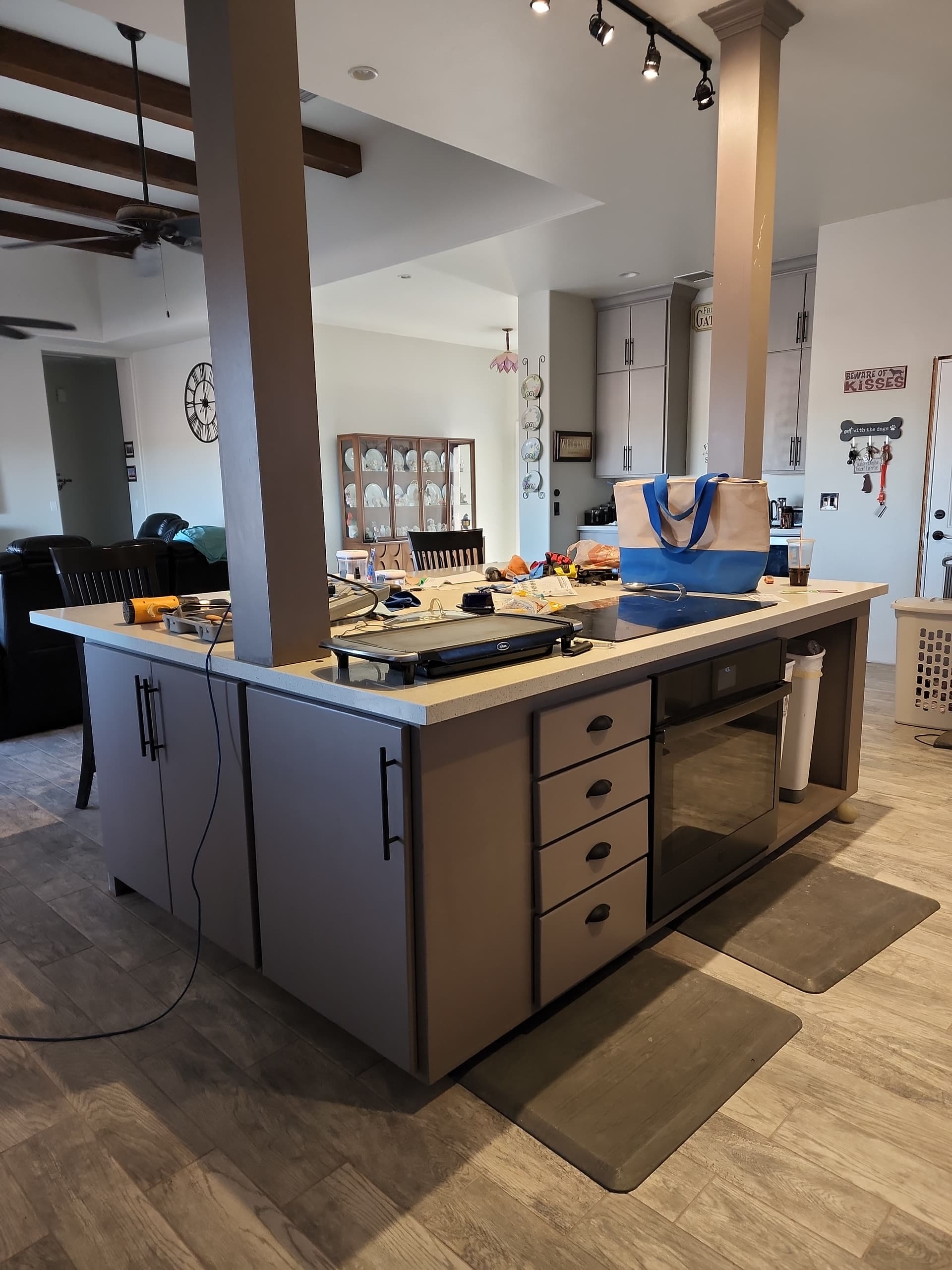

A full sheet Lowrider is capable of milling quality cabinets. Except for the popular face frames, my cabinets were milled from 3/4 Birch plywood on my Lowrider.
Glad to see you popped in. And folks, I’ve seen this kitchen in person. It’s an absolute testament!
wow very nice!
Very nice beautifully done :heavy_check_mark: are they individual boxes?
Tom, that is beautiful work.
