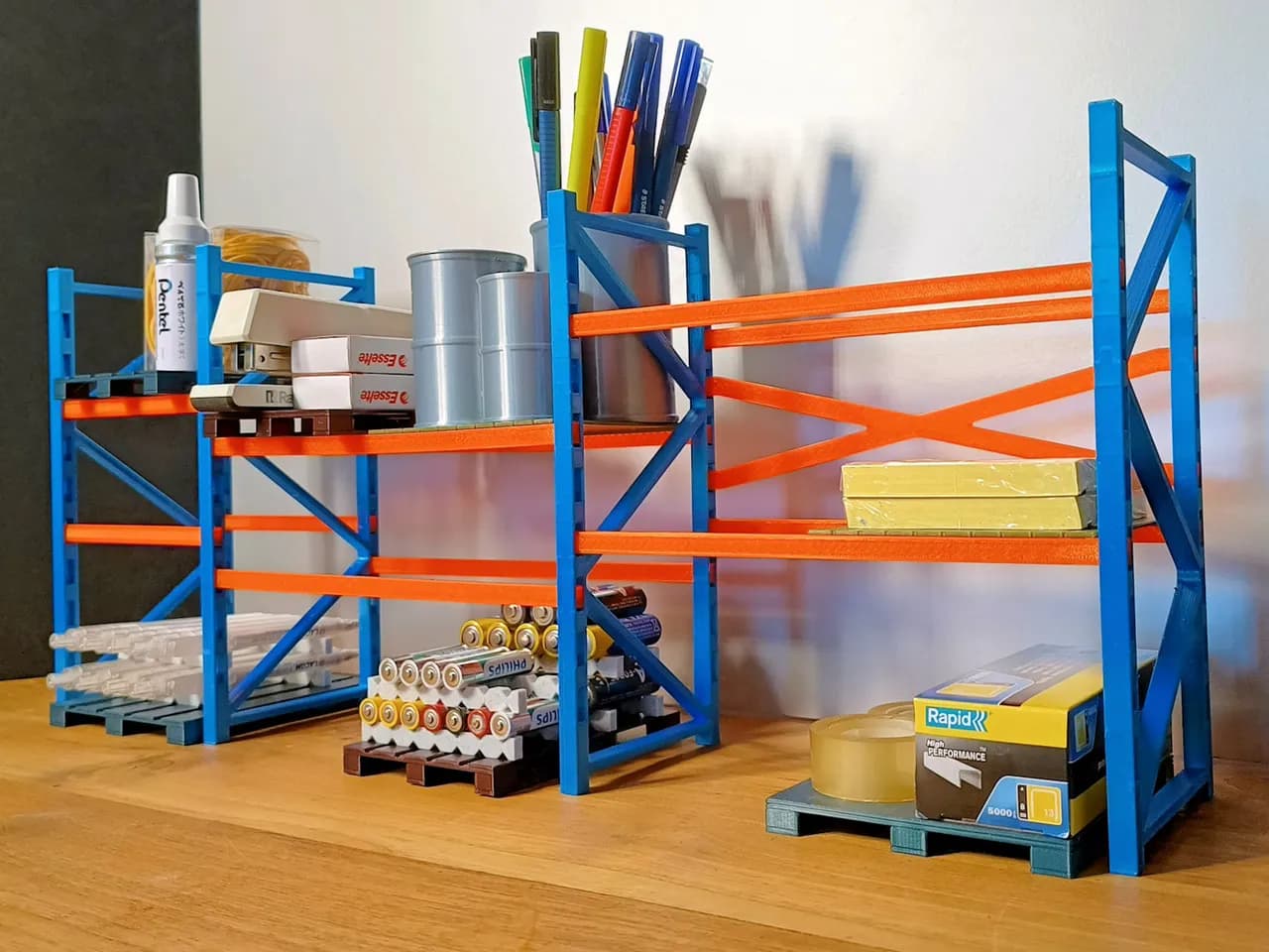

I added an organizer for SD cards & one for a combination SD & Micro SD cards. You can turn them upside down & they shouldn’t fall out.
https://www.printables.com/model/561782-mini-warehouse
Ha. That’s awesome
Please tell me you have a lil forklift to move those pallets around. Don’t want you to break your back

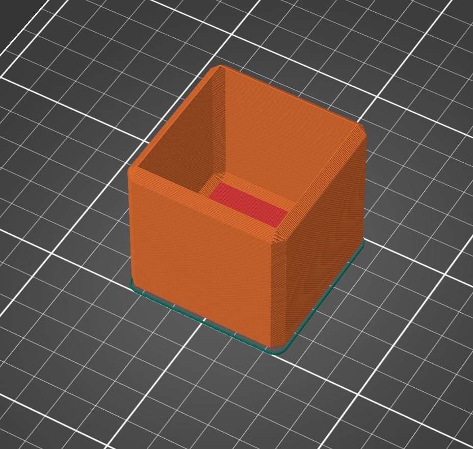

I really like this variation & it came out quite solid. This one is 27mm high which took about 1.5 hours at .24mm height. I’m going to try a 70mm high one next which will take over 2.5 hours at .28mm height.

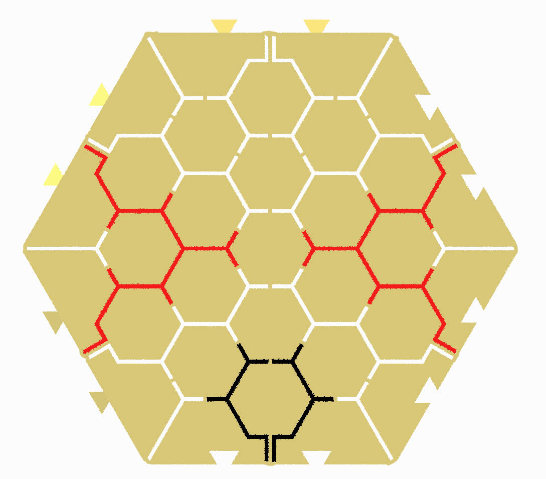

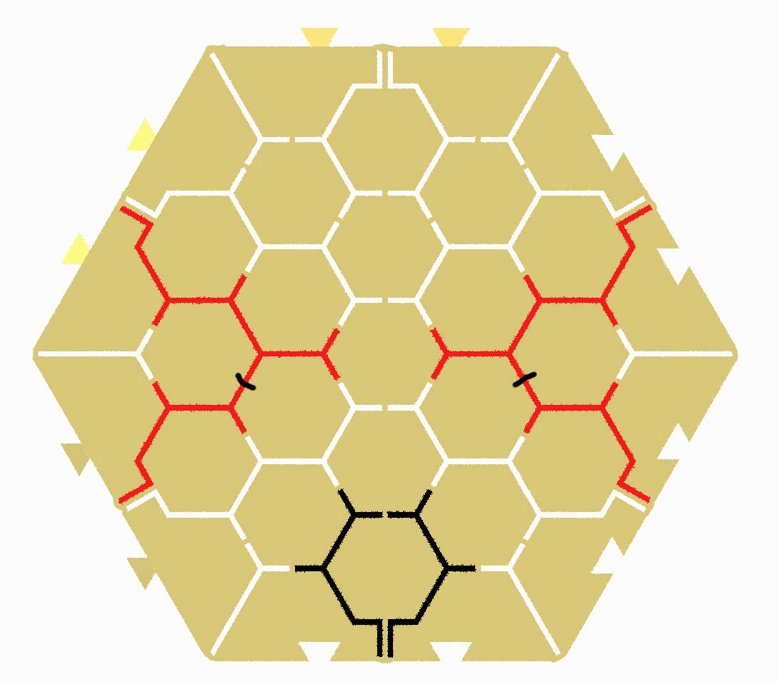

For these internal hexagon shaped areas, I originally hard coded the line breaks in an AutoCAD clone with polylines & converted them to linear_extrude commands. I have a couple of programs to automate that, but it was a bit of hassle drawing all those polylines & I would have had to redraw them to adjust any of the dimensions. I rewrote the openscad code to do all the calculations for the breaks for internal hex shapes so I could vary the size of the breaks & hex sizes a little bit. I was cutting these at a little different places than the 1st method & ran into a problem of them not slicing correctly. It is difficult to follow the continuous path of the spiral by just looking at it. I would make some changes & import the STL file into PrusaSlicer & see how it looked. I got almost there this way by visually seeing where it was missing. I then came up with the idea to take a screen capture of the top view with the breaks cut all the way thru. I opened this image file in photoshop & painted over the outer openings in same color as main body so I could flood fill each area with a different color. I knew the area of where it was failing, so I filled those areas with red. Voila, I could then see that it was going in & coming out at a different place. I just had to add a few more lines of code to break those 2 areas in two. Here are a couple images to give a better idea of what I am talking about as this explanation is probably not clear until you see the pictures. You can see where the black infill goes out the same way it came in, but the red does not.
Adding a break in these two places as shown with a black squiggle fixed it & I got rid of all that obscure looking linear extrudes in the code.
I am using 0.8mm gaps, but after running some different sizes, looks like 0.46mm is the minimum I could go & still get the spiral to slice correctly with a 0.4mm nozzle in PrusaSlicer.
