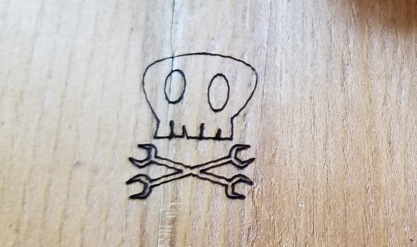

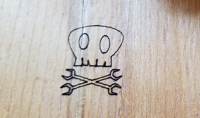

This post pushed my Laser Build (and upgrade to SKR from Archim over the finish line. I have some small changes from what’s above due to changes in Marlin. I’ll write it up once I get a few things polished.
Here’s my cut result:
Here’s the Gcode for any who need a test:

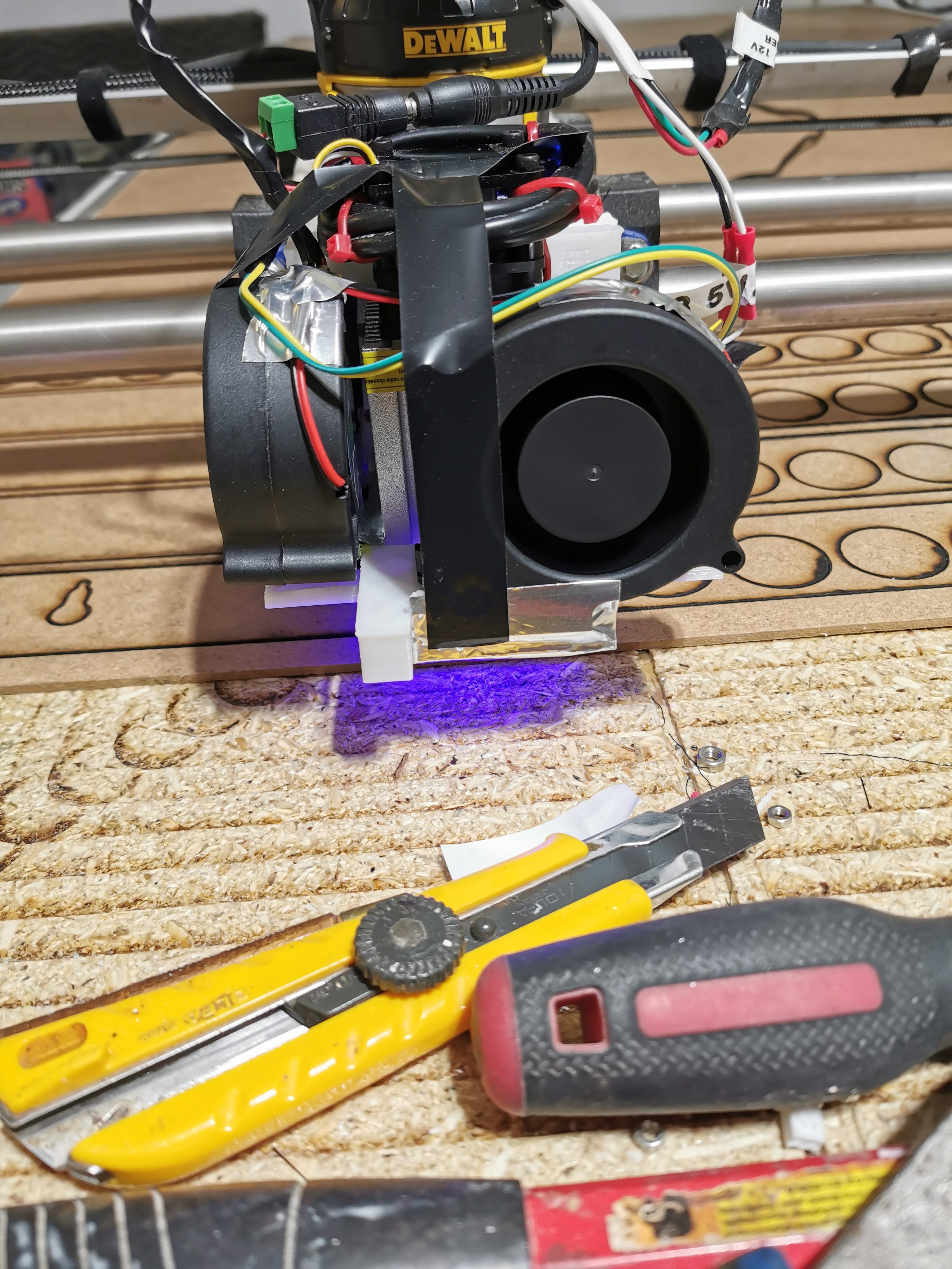

i look to the screen and it say 255 on the laser icon because i am using the M3 command i am using the laser Amazon.ca

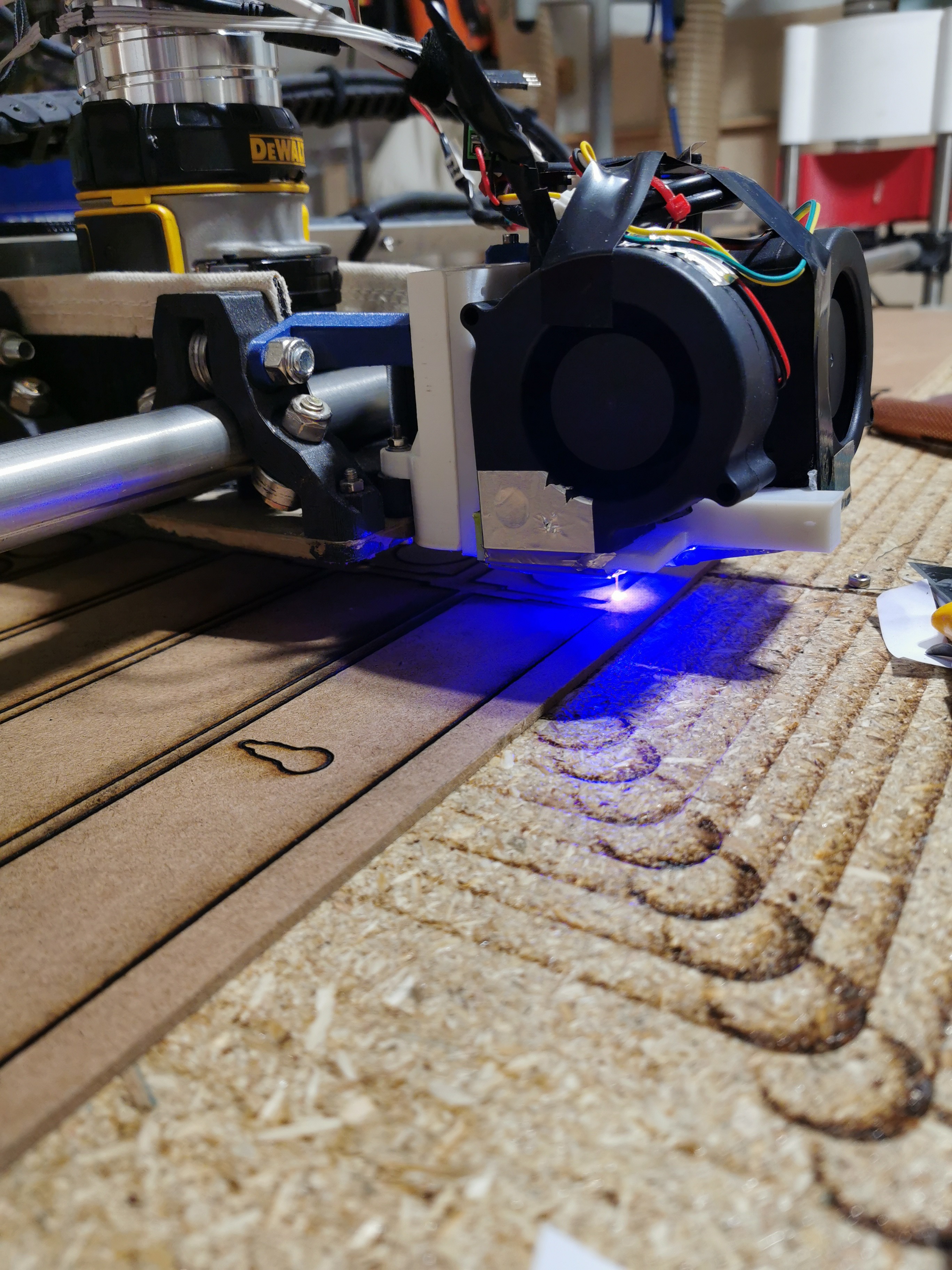

i already post them the question becauce it is supposed to be a 40w laser and waiting for them to answer i dont now if it is deffective it is working good for engraving but it does not cut MDF 3MM at full power 255 at 10MM/S i will try unplug the TTL and putt the switch to on to see if it make difference , i just make the test and nothing change the laser must be defect or is not really a 40W laser !
This is definitely NOT a 40 watt output laser. There are two common power ratings for these lasers, 1) input power and 2) optical power. Typically optical power is 1/3 to 1/5 of the input power. Without proof, I suspect this is a 10 watt optical power laser at best. I’m no expert, and I’ve not seen any reviews, but the best diode lasers in the open market that I’m aware of achieve 13 watts to 15 watts of optical power, and use two laser diodes focused using a mirror to accomplish the task. Here is one example. Not all MDF is the same, but for this NEJE example laser, 3mm MDF would probably be two passes at 4mm/s, or maybe one pass at 2.5mm per second, both with air assist.

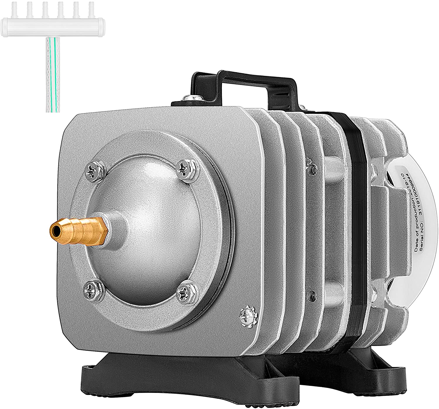

what is air assist means exactly ?
if i putt Laser air assist for dual fans by Spacegrey - Thingiverse
whit twoo fan is it ok ?
The one at the new link you provided is 6W optical. I’ll bet it is weaker than the one you already have…probably substantially weaker. I would not buy from Amazon. Buy directly from the manufacturer if you can, and buy a laser that is popular where you can watch YouTube videos and compare your cutting numbers to the ones in the videos. The scams and hype around these diode lasers is appalling, and it is very difficult to figure out what you are getting.
thanks
With laser cutters/engravers, air assist is blowing a constant stream of clean air into the cut. This clears smoke and other waste products of the cutting process out of the beam. This improves cutting efficiency (cut deeper at same power settings) and helps to prevent flameups during the cut. Some industrial laser processes benefit from using specific assist gasses, but for the home/makerspace/small business environment, a small airbrush compressor or large aquarium pump is often used to supply regular room air.

i think the laser is no good i send an email to the seller i tryed 2.5mms full power 2 pass whit lightburn setup and it cut only .4mm it is definitivelly a defect laser or a crap one !
In my (admittedly limited) experience, to be effective, the air assist needs to be targeted on the laser’s focal point on the material. The goal is to blow clean air into the beam area to prevent scattering of the beam by smoke, etc. and to “blow out” flame ups before they get started. I’m using a small aquarium air pump on my K40, but the pump is located outside of the enclosure so the air is clear, and it runs through vinyl tubing to the laser head. I’ve used a variety of nozzles, from 3D printed attachments to .035" welding tips to get a focused jet of air that can be directed to the cutting point. I can definitely tell the difference when air assist is aimed right, and when it isn’t doing the job.
From the photos, I’d expect those fans are just circulating already smoky air back into the cutting area. I would expect that would waste more power lasing the smoke and scattering the beam, rather than improving your cuts.

I see a lot of people online are using those. I spent $12 at my local pet store for a much smaller pump. It was several years ago, but I think it was sized for 15-20 gallon tanks. Not the smallest they had, but it didn’t make sense to me to spend big bucks on an air pump.
