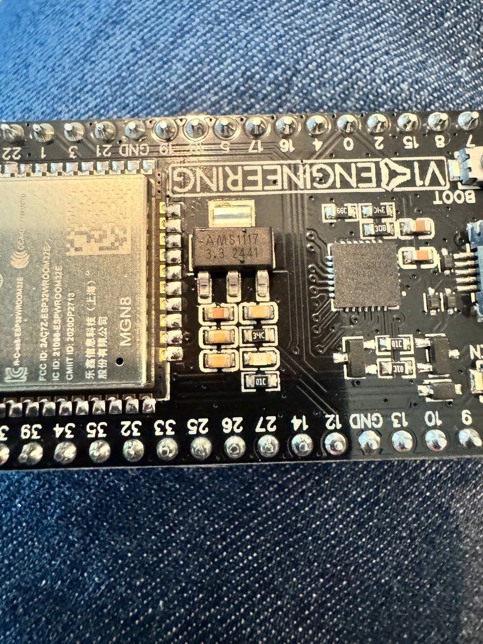

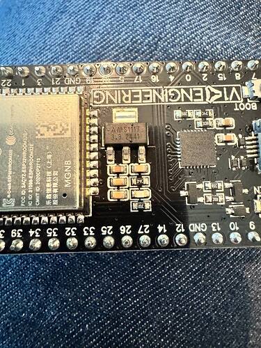

I’m stupid.
I just cooked it myself
inverted mount
Sorry Bryan I didn’t see the figure on the Jackpot
:rage: :rage: :rage:
I changed the regulator and now it works
Yeh, done that. Maybe we should get some sort of special ‘ goof’ forum achievement :smiley:
Hmm I just found some of those regulators in my collection of random components. Maybe I should give that a shot.
Burned my one as well :man_facepalming:
never looked at the jackpot marking. I’ve looked at the case and thought that the opening is for the antenna :rage: :man_facepalming:
esp32 chip survived but was not able to see the flash chip.
removed the metal shield and swapped the flash chip. still no luck
I’ve got the V1E one from elecrow with the jackpot and didn’t have any spare ones in the right shape. so had to unpack the hot air and swap the whole esp32 module from another board.
nothing better then creating problems and then fighting to resolve them
