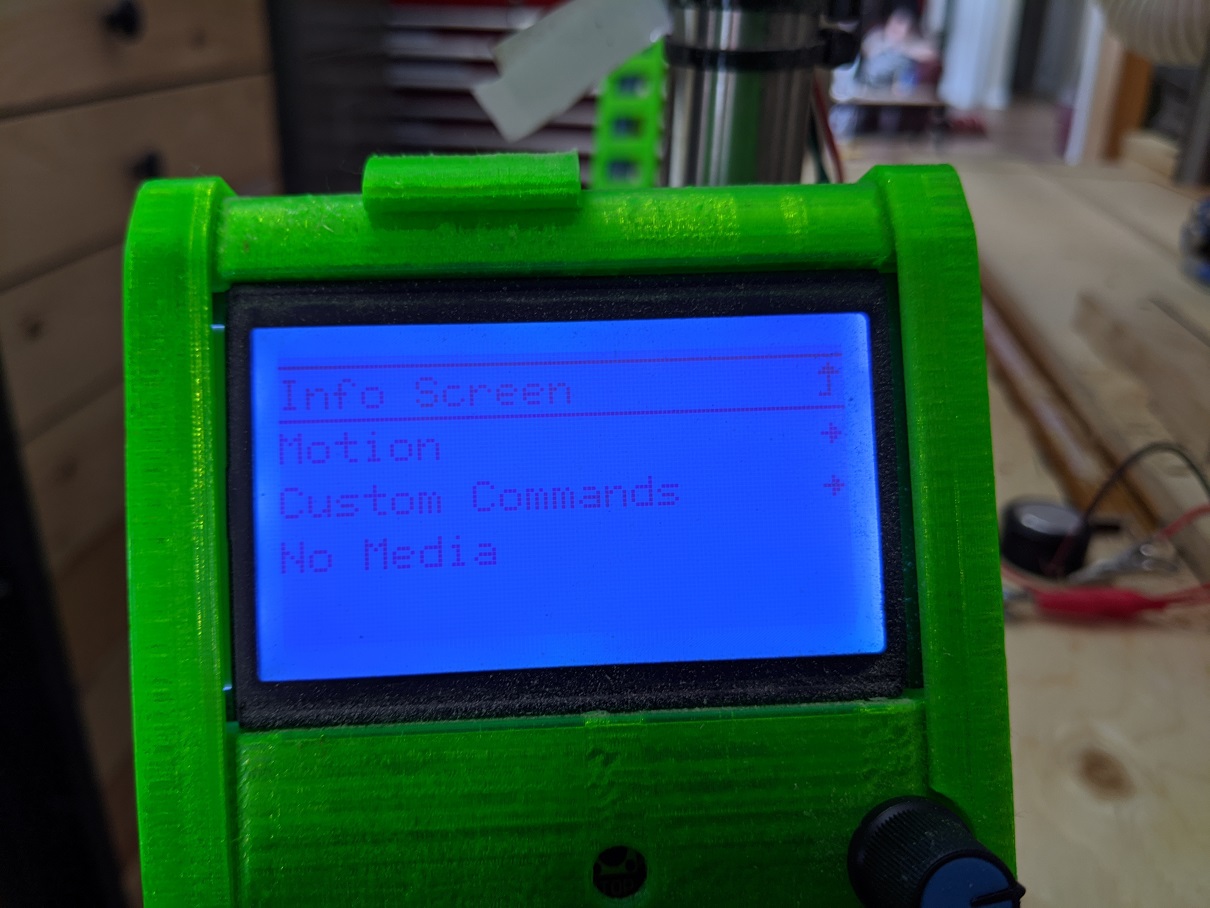

Just out of curiosity, how hard would it be to disable some of the menus?
I am thinking I want to turn off " Configuration, Temperature, load media, Run media"
since I do everything from OctoPrint. they seem pointless and take up UI space?
Sz
Dunno. Probably commenting out the appropriate code in the various Marlin/src/lcd/menu/*.cpp files… Can’t imagine that it would be hard, but it could be tedious and/or finicky.
thnks
I think I found it.
Please share what you found. Others might benefit from it. :wink:
Just be aware that, at this point, you are mucking about with the firmware sources. If you stay in /src/lcd/menu/ it’s doubtful you’ll break anything truly meaningful, but you could lose your LCD functionality. And if there are updates, you’ll have to re-apply any changes you’ve made. This is a bit deeper than tweaking the configs (although the code is pretty well structured to handle this sort of thing).
Thanks, I understand what your saying, But I am not a C++ Coder, though I know enough to be dangerous.
I am not going to change the menu’s persay, just turn them off to clean things up.
I was successful at turning off the Temperature and the Configuration menu. I can turn them back on if I need em :slight_smile:
\Marlin\src\lcd\menu menu_main.cpp
// SUBMENU(MSG_TEMPERATURE, menu_temperature);
// SUBMENU(MSG_CONFIGURATION, menu_configuration);
