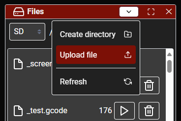

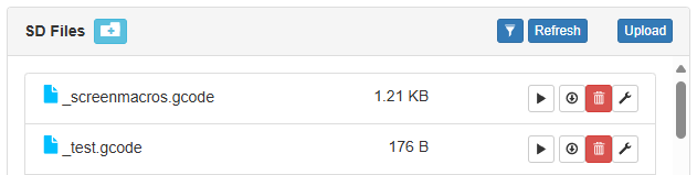

I opened: FluidNC.local and got the WEBUI with the interface is different from the one online, see picture the left side and right side. why so?
That’s WebUI v3. Same idea. You can also drag and drop from file explorer to that panel to upload.

in webui, I uploaded file, does it goes to flash? can’t find in SD card.
and not find a gcode editor, is there one or not?
You need to have SD selected in the dropdown when you upload. No, there isn’t a gcode editor. I just have my Jackpot configured in STA mode so it’s connected to my wifi network. I just edit gcode in Visual Studio Code and upload it.
