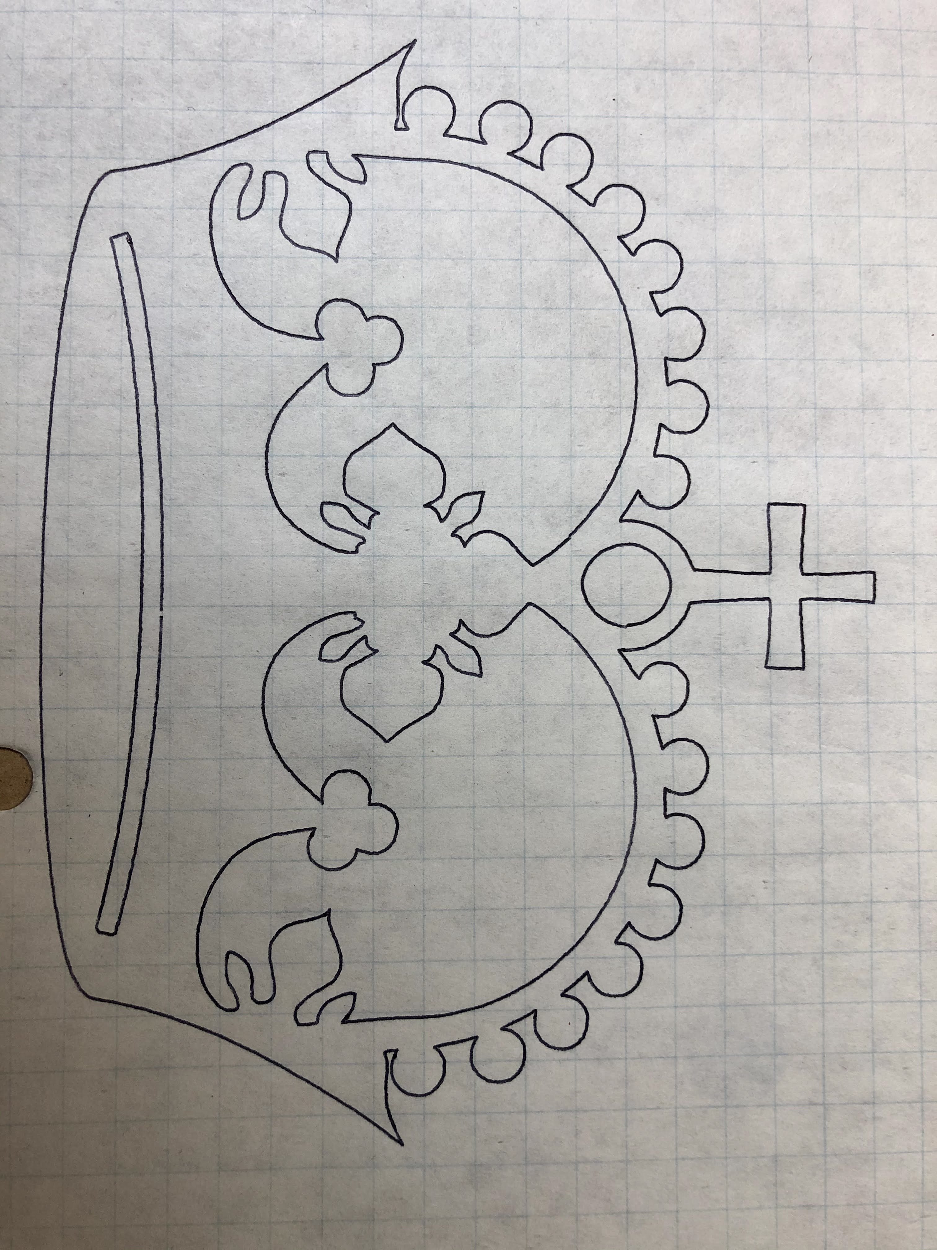

Here is a picture of the completed drawing. I think it looks pretty good.
Of course that’s with just initially connecting all the wiring, just to see it move. Now comes the hard part of getting the wiring loom together an building a “real” system.

Using the screen controller I ran each axis out 300mm and measured the length with a steel rule: it looks like each axis is about 0.5mm short. I guess that’s not too bad, but you guys can tell me if that is something I need to correct.
I spend a while today getting more familiar with EstlCAM and did a bunch of “air milling” with the pen holder installed. Tomorrow I hope to really make some dust, and cut the parts for the upgraded MP3D printer.
