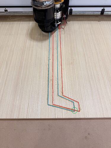

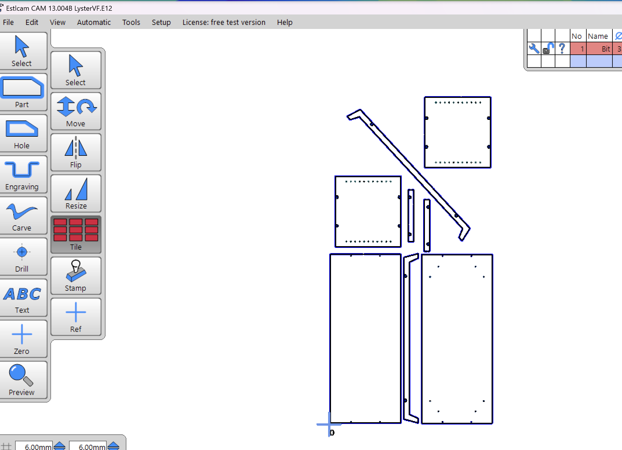

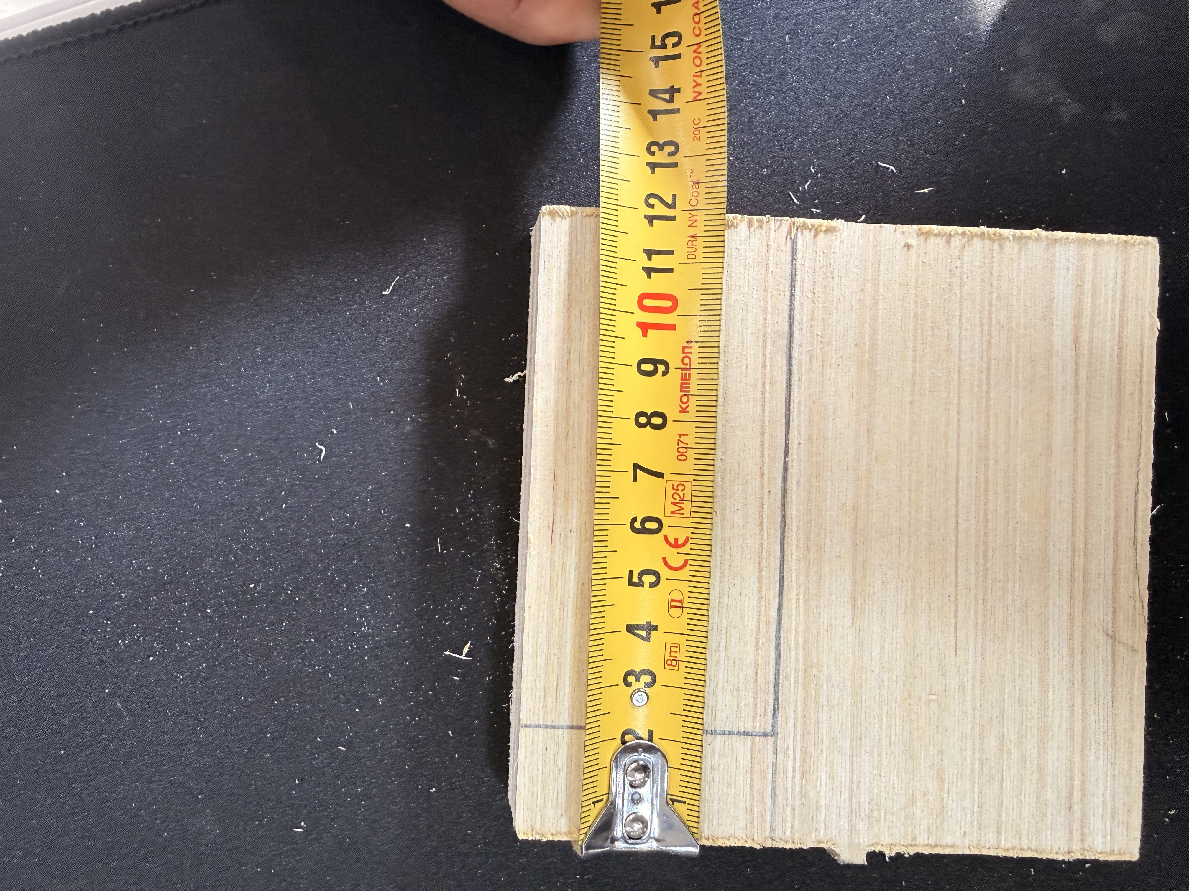

Hello, I’m still very early on my CNC journey and have encountered a new issue with my tool path. Each pass is offset on the x axis by about 16mm from the previous pass, please see the image below (I’ve also included a screenshot of the Estlcam project and the Gcode file).I reinstalled Estlcam and set the settings per the V1E guide. Do I have an incorrect setting somewhere? Many thanks in advance.

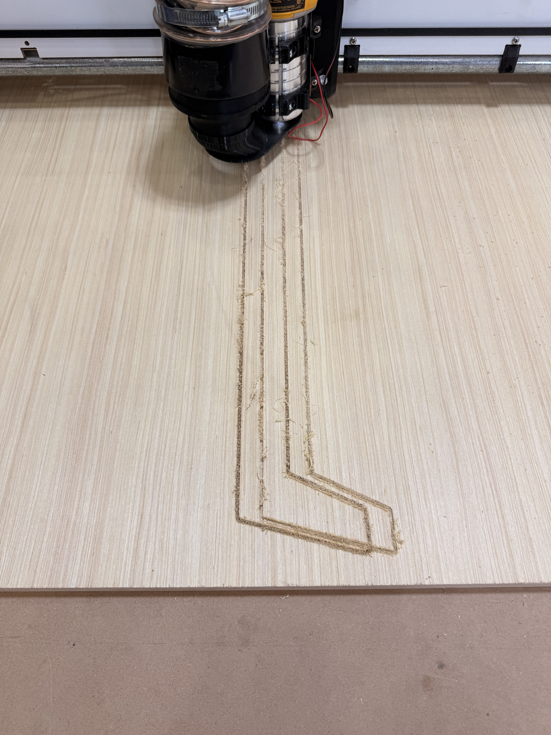

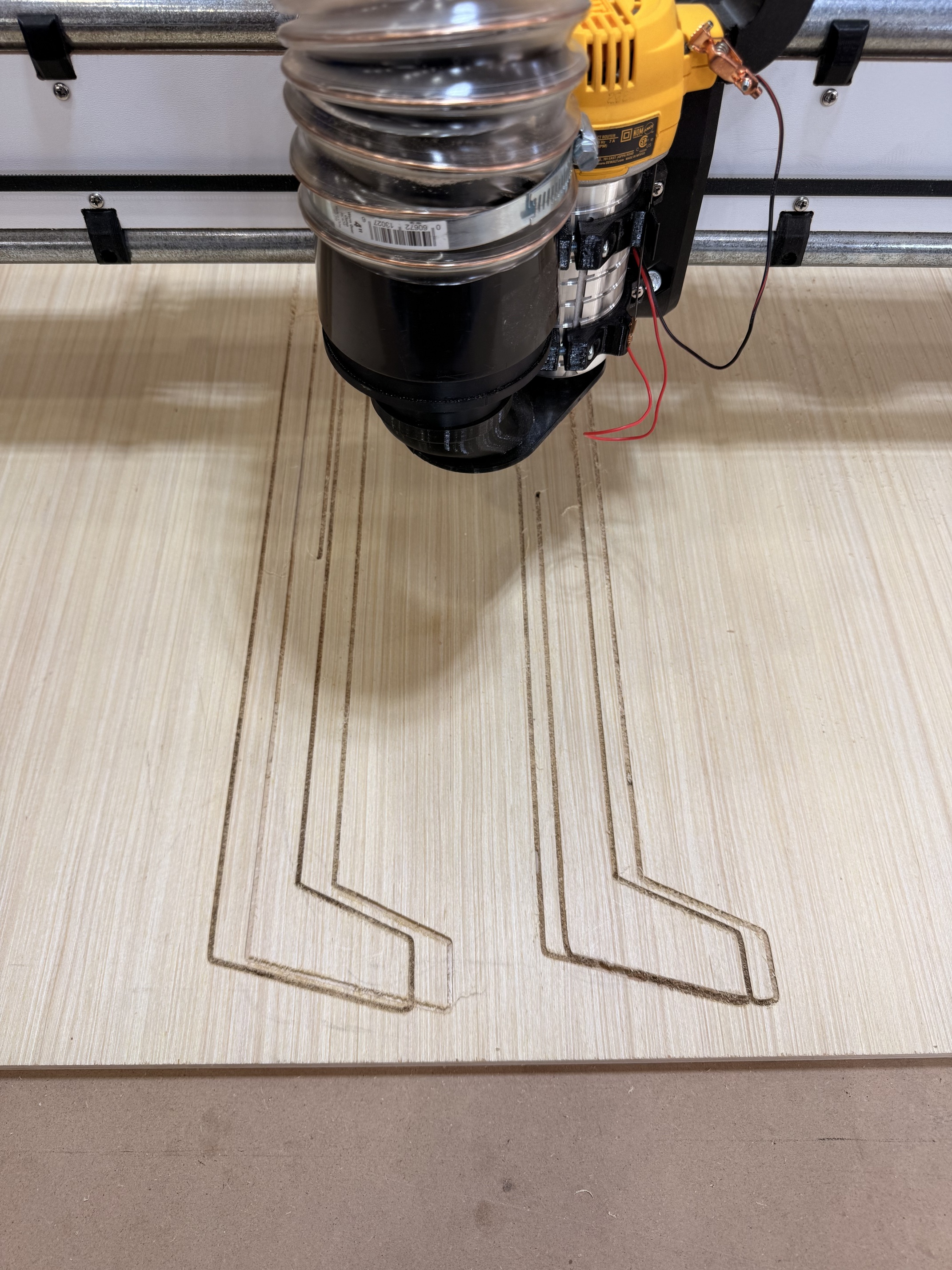

Also, I didn’t move the workpiece and ran the same file but this time it started quite a bit further away than the first time. Please see image below:
Do you have endstops? If so run, “home” your axis. Then run the program, then when the issue happens, home your axis again. It should tell you how much you are out of line. If it says anything more than 0,5 mm then something is moving that should not be moving (or something that should be moving isn’t moving)

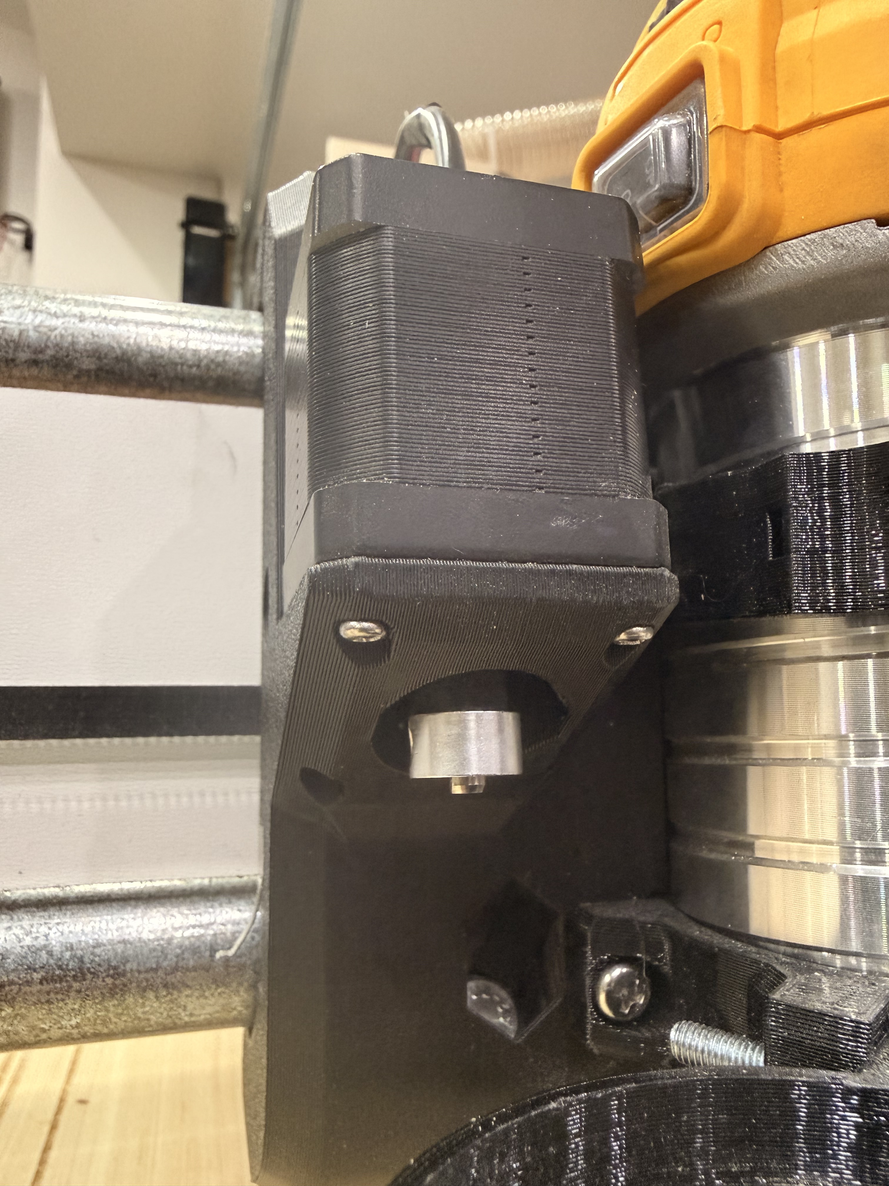

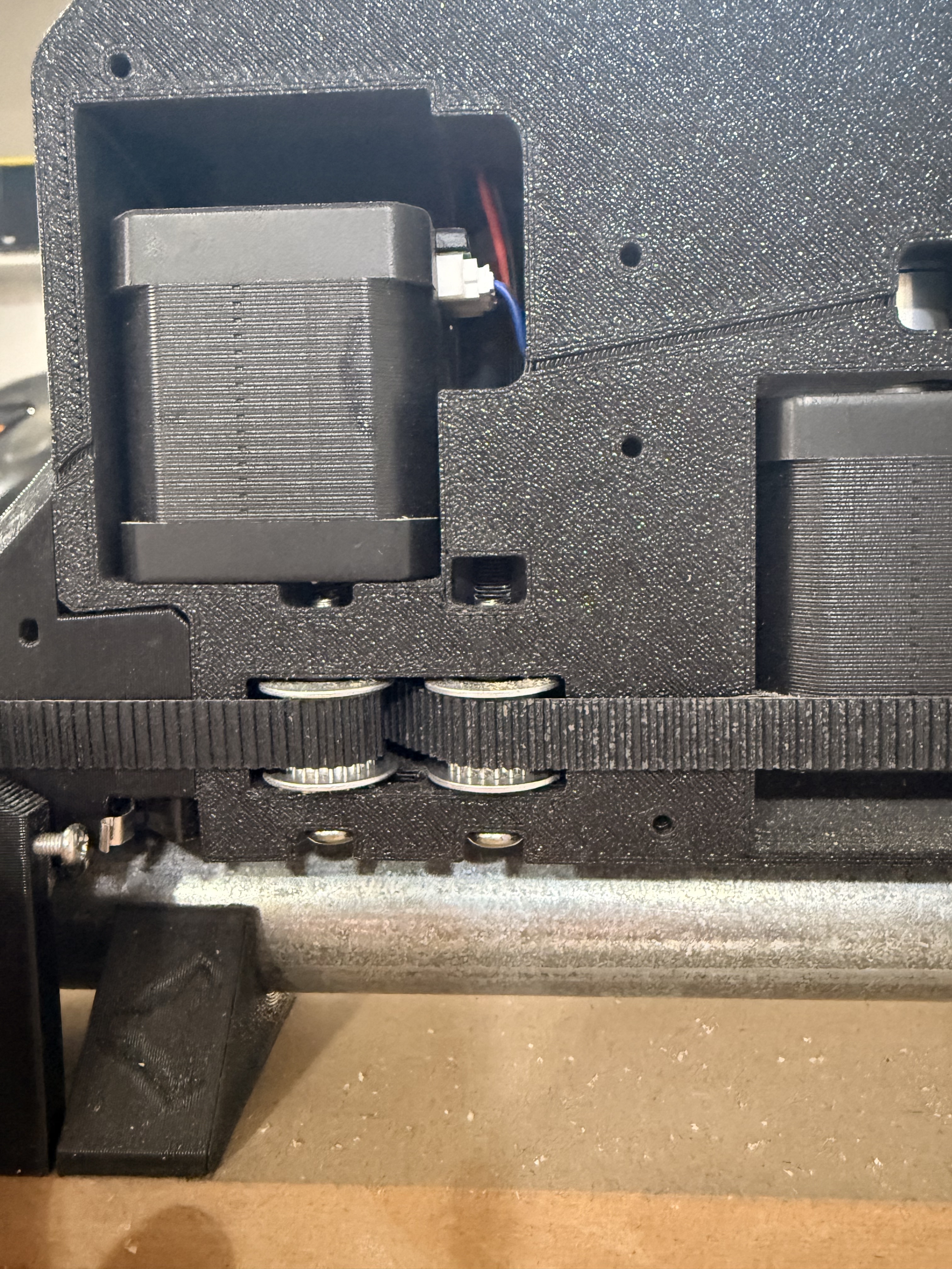

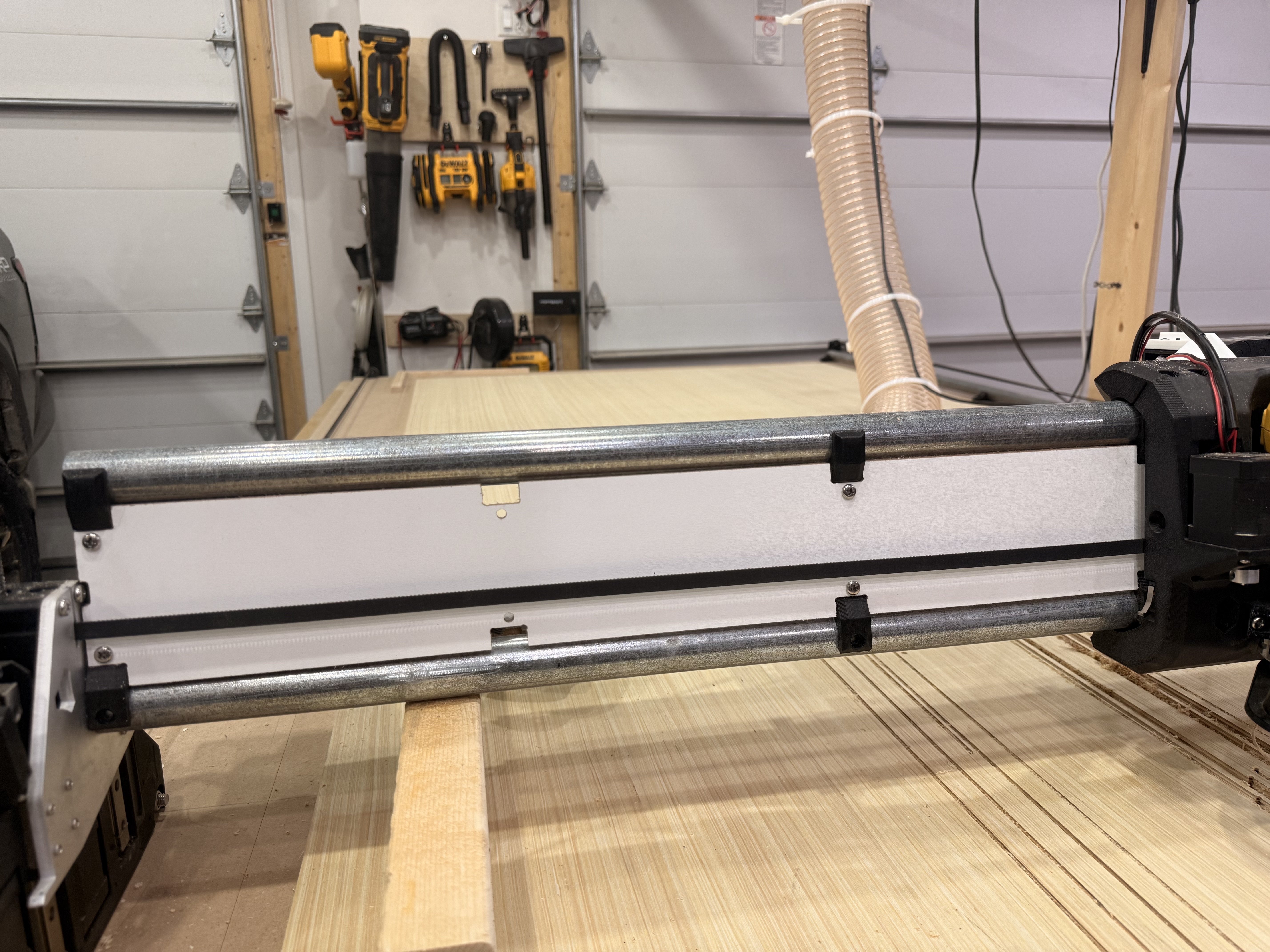

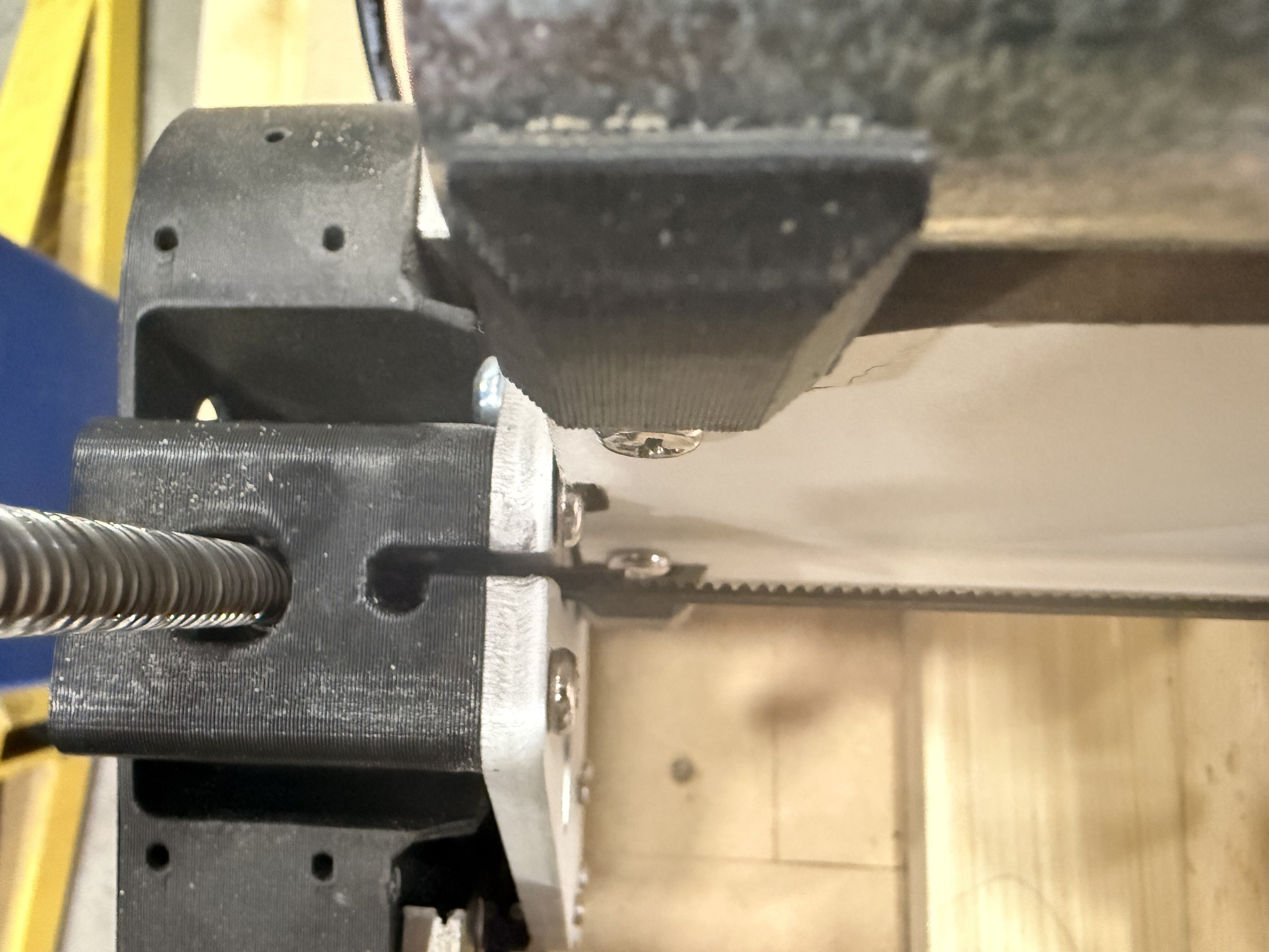

We see the front, can u please take pics of the belt, stepper, etc?

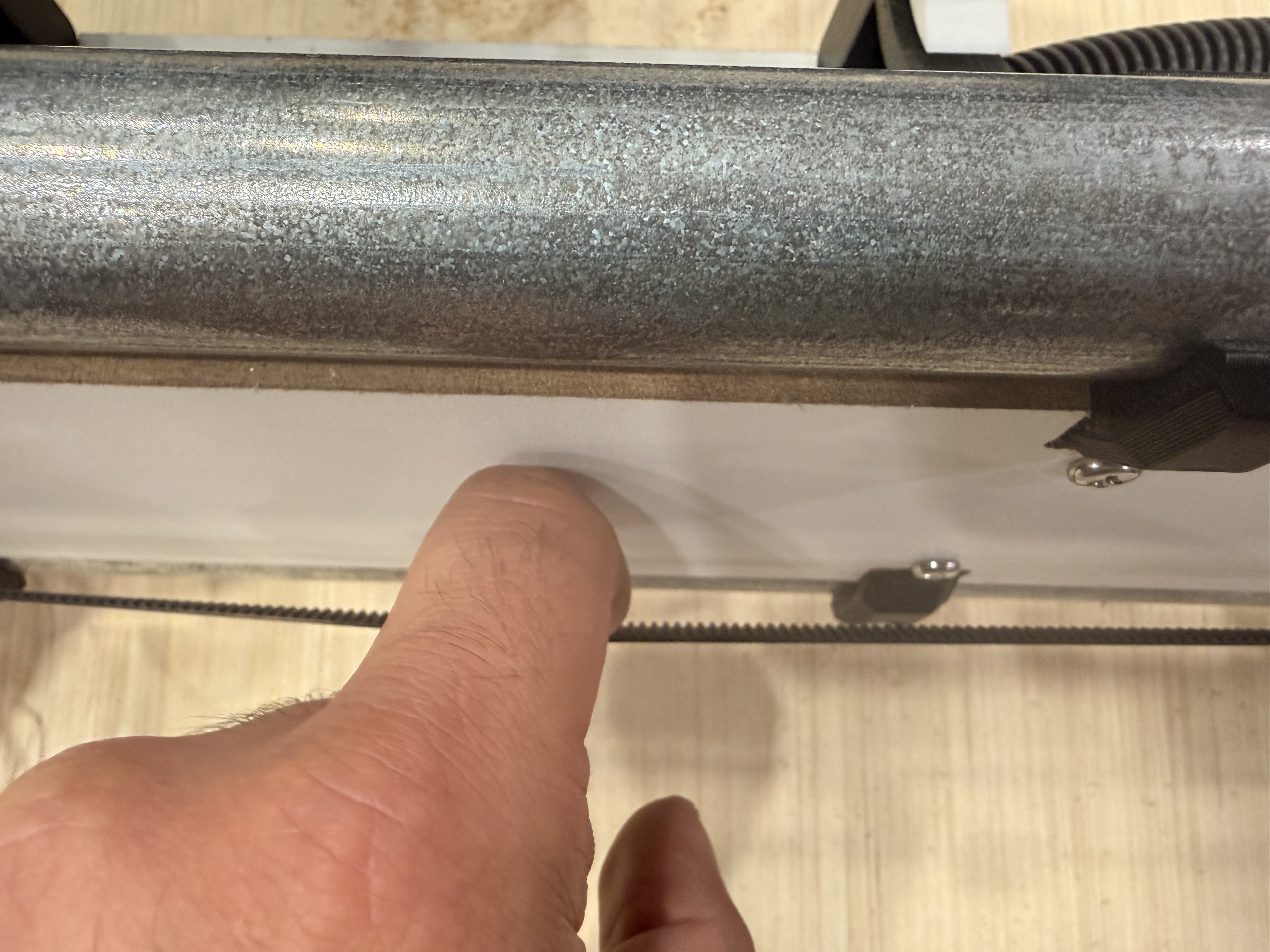

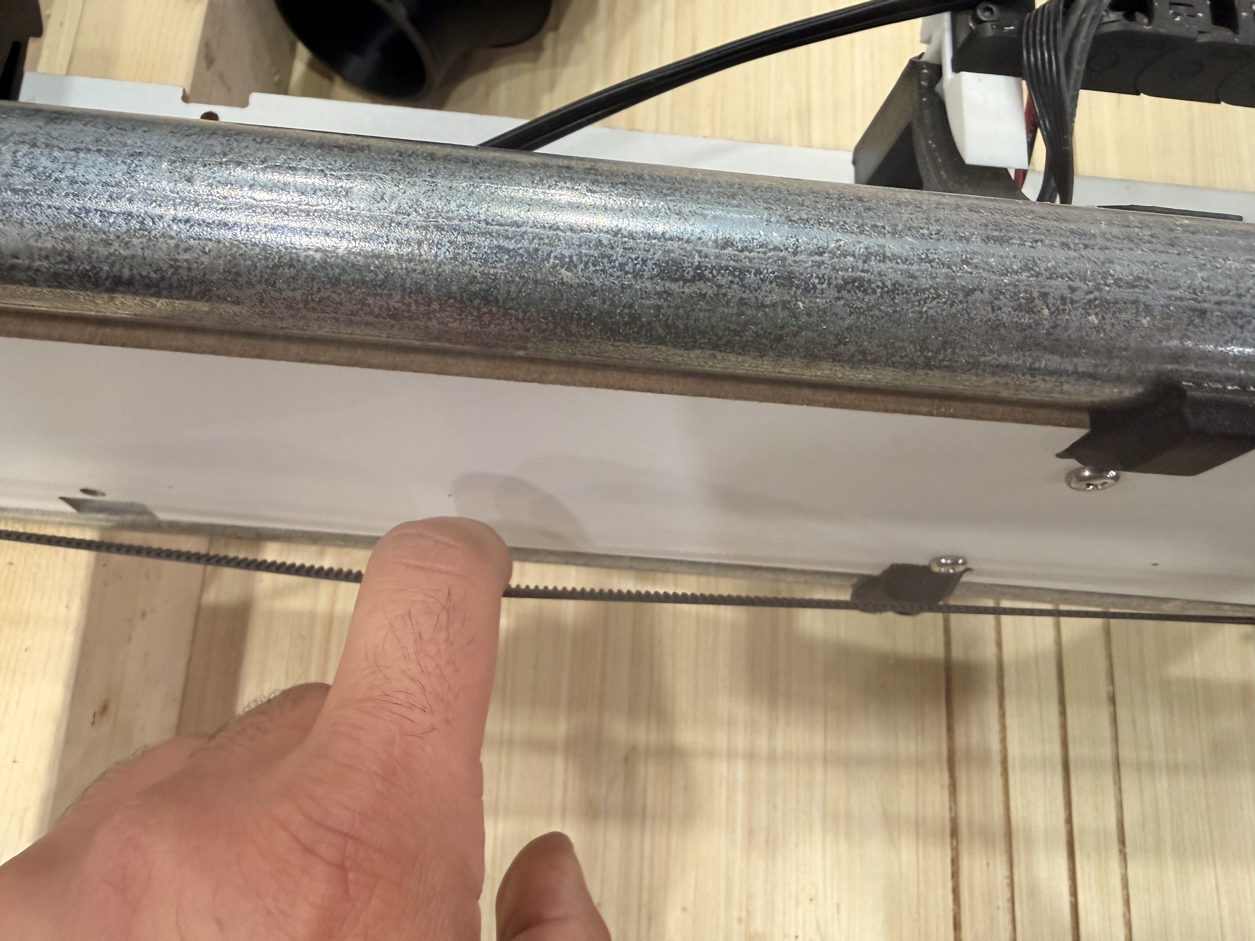

I appreciate you taking the time to help with this, many thanks in advance! Please see some photos below:
The photos with my fingers show how much slack is in the belt currently. I tightened the slack to this amount at the same time as tightening the grub screws, and the shifting reduced significantly, although it’s still there.
Please let me know if there’s anything else I can capture (either photo or video) to help diagnose.
First off, I agree with Riley. The X axis should not be more difficult to move in one direction vs the other. Something is amiss.
It may be worth double-checking that there’s not something wrong with the belt routing through the idlers and across the geared pulley. The picture shows the bottom of the belt riding on the pulley, so there’s a chance it’s dragging or misaligned on the way through.

Double check the idler pulleys . I suspect that the belt is routed on the wrong side of the idler pulley,most likey on the side of the direction of the side that pulls hard.

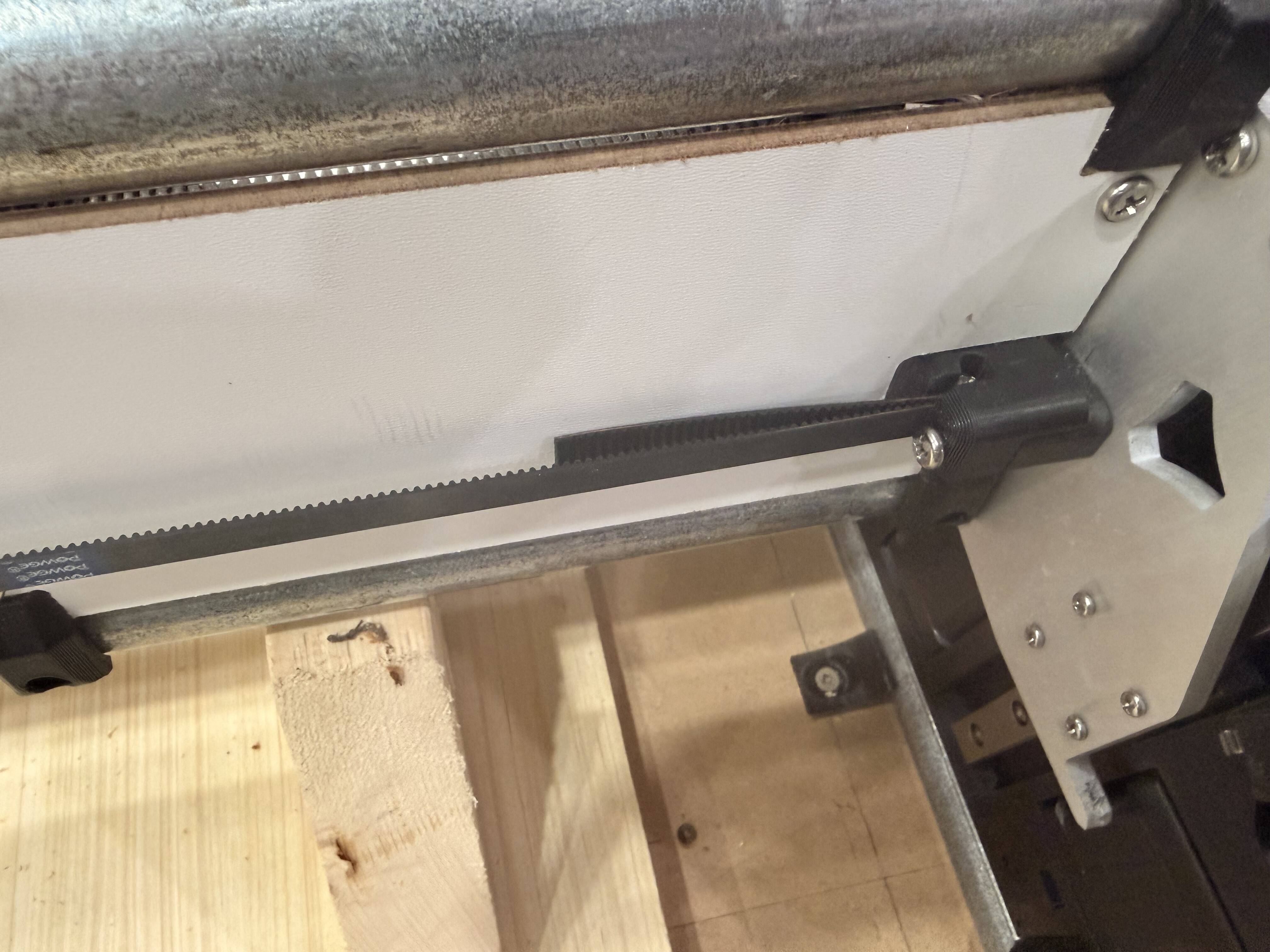

Here is a photo of my Y axis belt going through the pulleys, does it look correct? I don’t think it’s wrong since I was able to cut the “crown” and the strut plates without issues when I first got the machine.
I don’t know anything about that machine, but shouldn’t those be smooth pulleys and are there smooth pulleys where those toothed pulleys should be?
Yes but that would not cause a problem, may wear belt but not cause a problem, my MPCNC had them by accident.

Another thing I noticed, it seems the whole shape is offset? When each pass happens normally it should trace the outline, then step down as it gets back to the beginning and continue. Is it lifting and then starting another whole new cut or is it continuing the current cut but just moving early? In the image below, does it cut red, then lift and move and cut blue completely offset? If so what depth is it cutting to (measured depth not programmed depth). Or is it cutting red and then steps down when it gets to the intersection in green and starts moving along Y so the cut is fully offset?
Have you let the program continue to see if it offsets on the next pass if there is one?

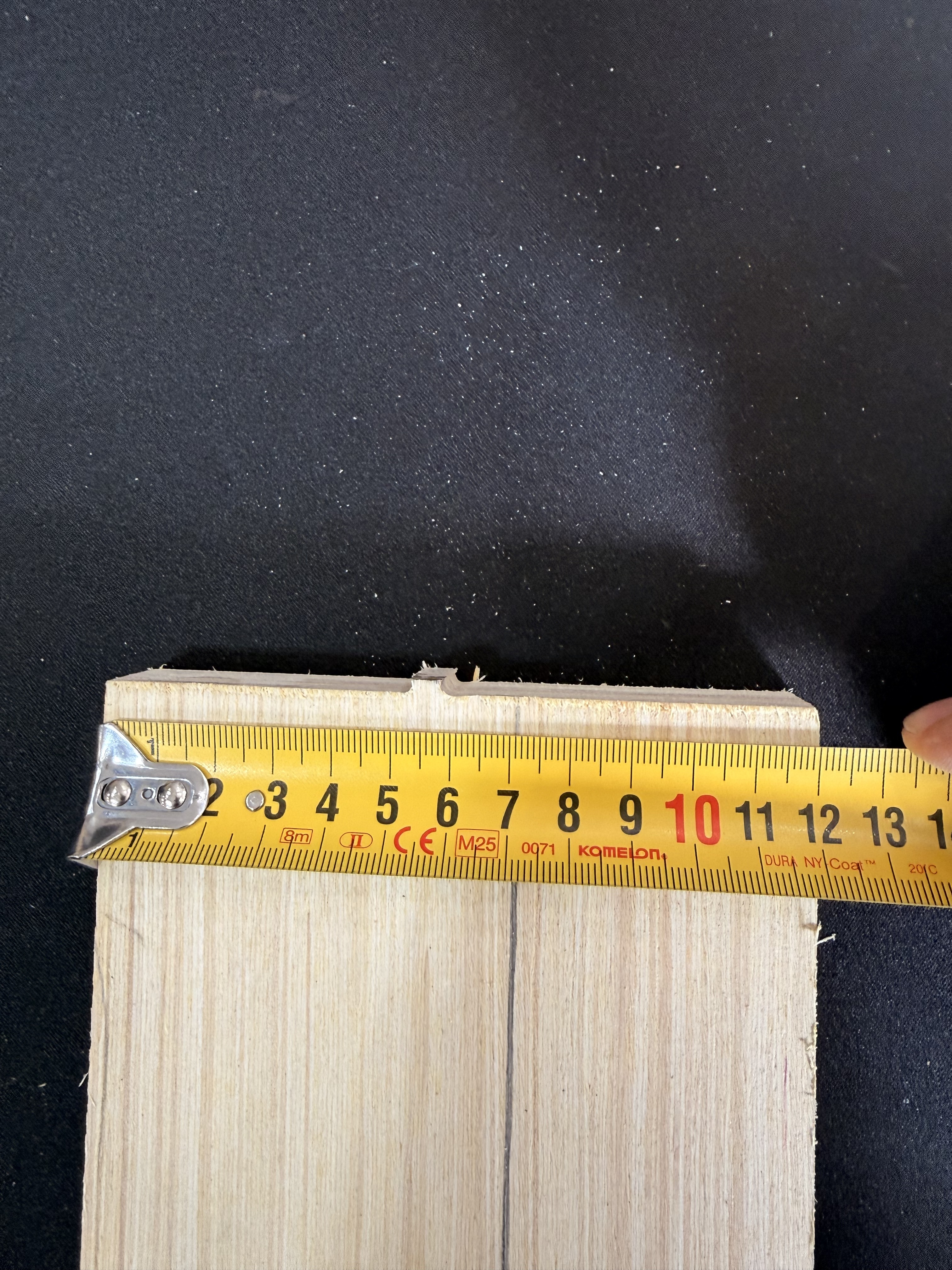

I took your note on wiring causing issues, so I decided to remove the IOT relay (I added a very long wire between it and the controller to facilitate a clean install), and the machine worked perfectly on a test cut. I made. 120mm x 120mm square and it’s perfect:
