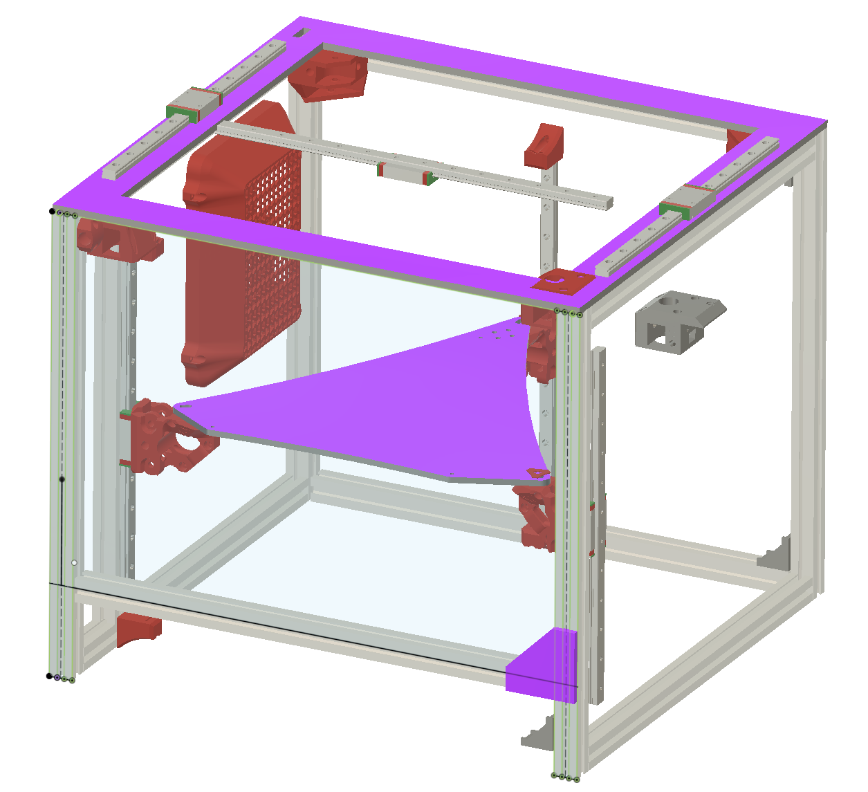

Incomplete, one level up from mspaint, visual mockup of the reference XY plate and other CNC’d flat parts idea…

I’m not a new voice…but after thinking more about bed crashing vs expensive parts on gantry crashing…I lean more towards bed moving, even though I know there are some out there like the Voron 2.4 where the bed is stationary.
I haven’t looked that closely at it. I don’t know how the 2.4 deals with gantry drop or whether theirs is even belt driven…
We need a brake either way. I think a brake is less expensive and more parametric than leadscrews and anti-screw wobble connections.
But how does that change if the gantry moves up and down…I see V wheels doing the work and that plate non-existent.
As for the brackets, heck yeah. 3D printed ones even work well.
It is belt driven, with geared down stepper motors to make it hold without a needed outside break source.

Linear rails are ~$15 for what we use per stepper. Two v-wheels are about $0.80 per stepper. We’ll have to get into that later, though I added it to the list. I am pretty sure the V wheel will win if we stick with an extrusion/hybrid frame.
Tensioning them though, that is tricky. Anything eccentric might add some cost. Surely there is a printable way to do it.
