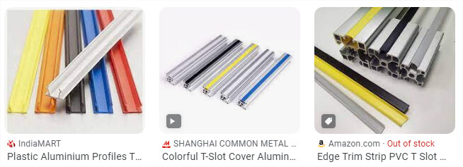

The wiring can be tucked into the slots in the t-slot members. I use foam backer rod to hold the wiring in the slots in Arrakis. It’s dirt cheap and does the job well, and can be easily removed and put back if you need to work on the wiring. It comes in many sizes to fit whatever t-slot you’re using.

I suggest using these instead, as they allow to fit a lot more wires into the slots. They can be easily cut to size and they can be removed and put back super easily.
I use them on all my machines:
