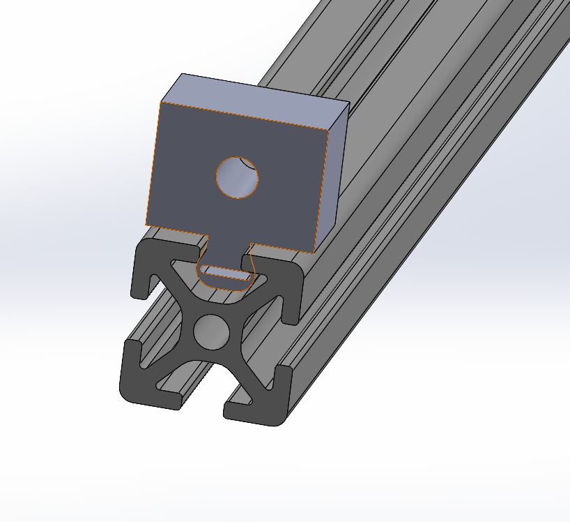

Excuse my very basic modeling here. If you went with 6mm belt and wanted it embedded inside, then can’t you design up a part that sticks a tongue into the extrusion groove to grab onto the belt?
This may not work for the application, but it came to mind and I wanted to present it in case it does spark an idea some how.

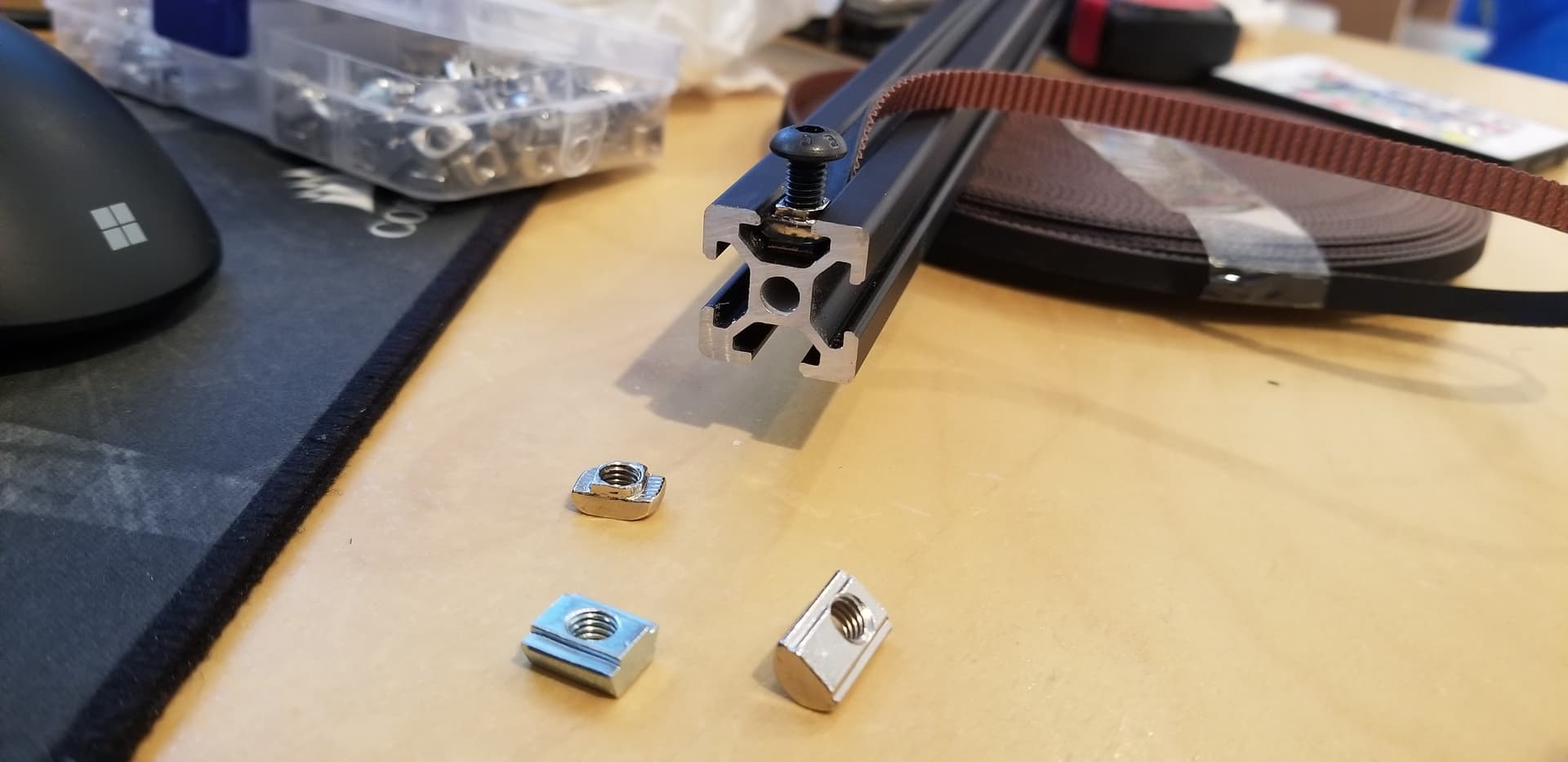

IF considering Z axis with 6mm belt…
My slot nuts are too thick, but something like this with nuts or tapped-square-washer thin enough (~2.5mm) to allow belt to slip between nut and extrusion?
If thinner nuts not possible, then CNC, Dremel or chopsaw extrusion channel deeper where belt terminates? Carve out a 1mm deep well in channel near belt termination for slot nut and belt to fit.
Maybe with 3D printed part similar to Matt’s that loops back belt before securing part and belt with same M5 bolt… Similar to existing Z endstop

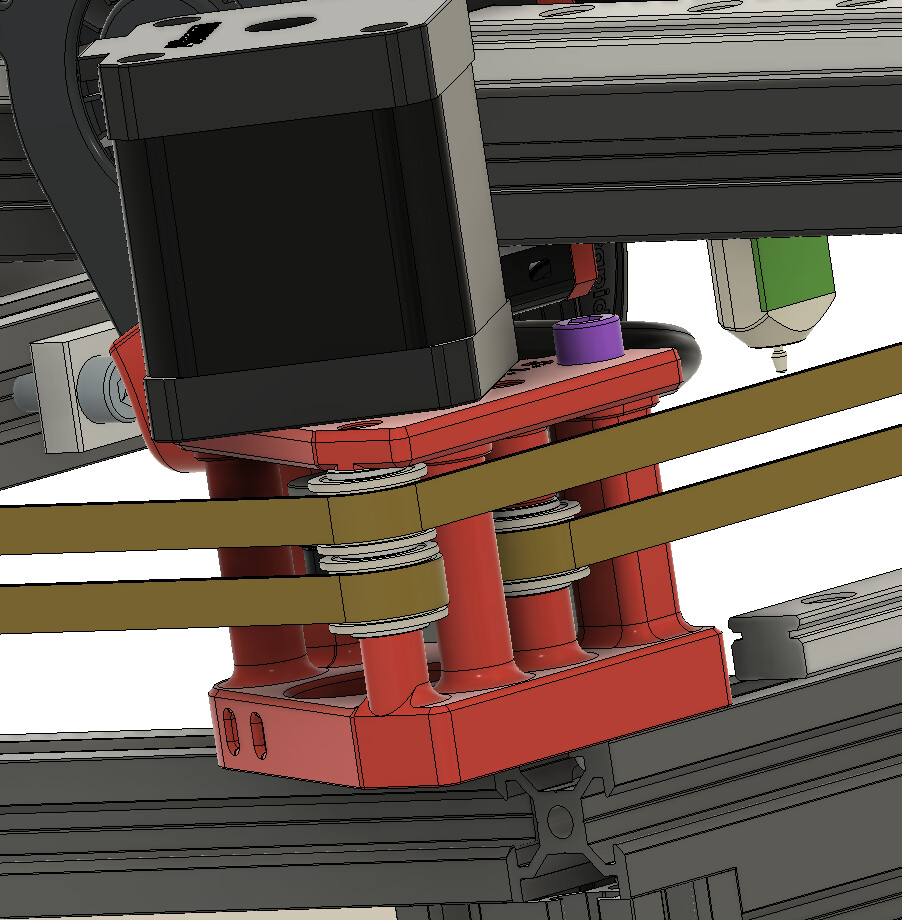

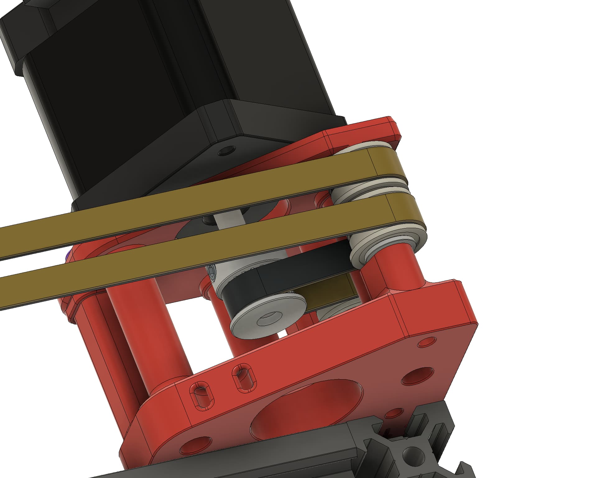

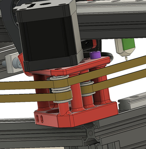

Stepper position AB
*The blue side shows the current setup. Downside, a slightly more cluttered front face. Upside more belt contact with drive teeth.
This also takes a bit more room (yellow circle is not needed if we just use an idler on that side)…but that room is wasted anyway shown with the front of the extruder fan already poking out the front.
*Green shows the stepper in the back corner. Downside, less drive teeth contact unless we add idlers and hardware to wrap it more, larger rear corner parts to accomodate. Upside, it looks cleaner, slightly closer wires.
*This is the same if we have a top plate or not, we can talk about top plate next.
I vote keep them up front for less hardware, more pulley contact.
This is something I personally wouldn’t mind. It would be a lot cleaner look and the wiring would be a ton easier, much less need for extending wires if putting electronics on the back. I do think the added idler to get full teeth contact is a good thing and at the cost of those I cant see it adding enough to really make a huge difference.
