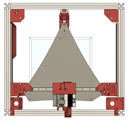

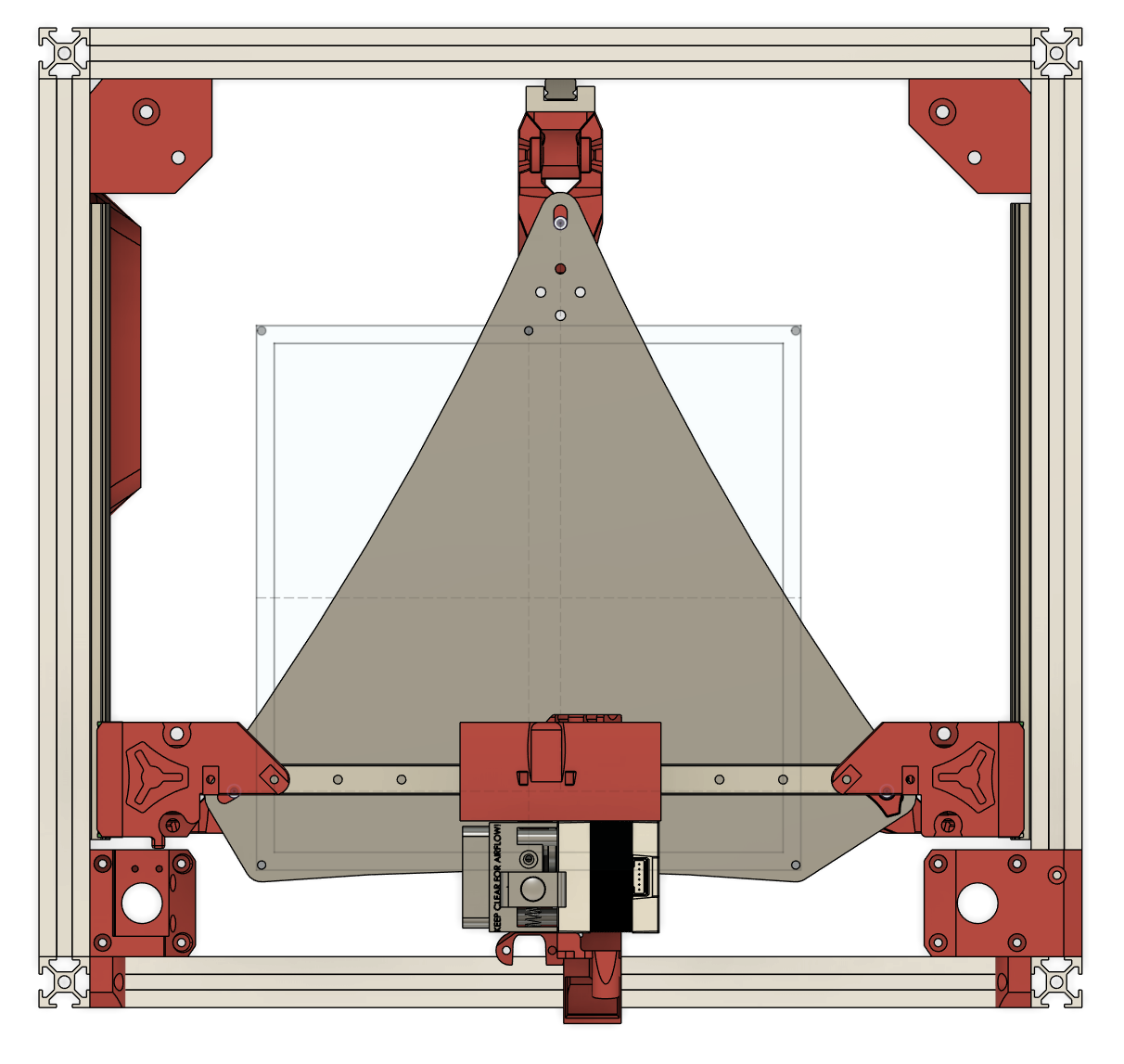

You have to figure, you have the size of the bearing block to work with. Anything over that is waste. The current Z and Y axis are that exact size, The X though…bigger to fit the old hemera. I do not want to ditch a old hemera, but that is the only reason it is that wide. I think we can do better with any other extruder.
My original plan was to mount the hemera on top of the bearing block. That did not work out. Whoops we will get there. Let’s finish up with belts first.
In case anyone want a good visual of what we are working with in terms of XY.

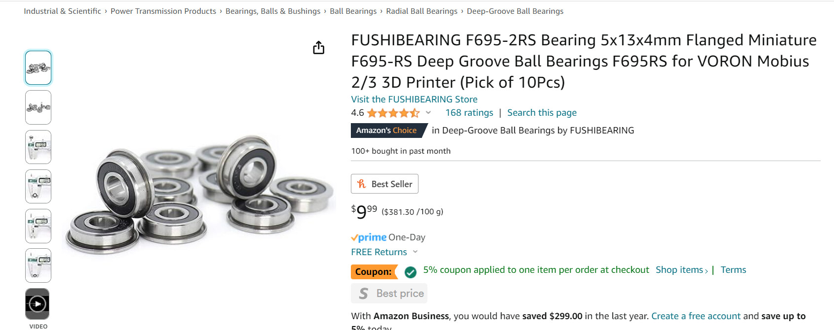

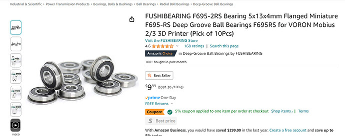

I think the big thing now is can we find bearings worth having in the 6/9mm range. They all run the flanged bearings but that will only work for the smooth side, what about the toothed side?
Toothed or smooth should be available. If the bore is the same the outer diameter will be the same so for your concern we are back to +/- 3mm.

I mean a bearing like this is what they use, and not just voron…

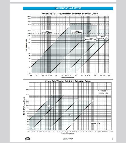

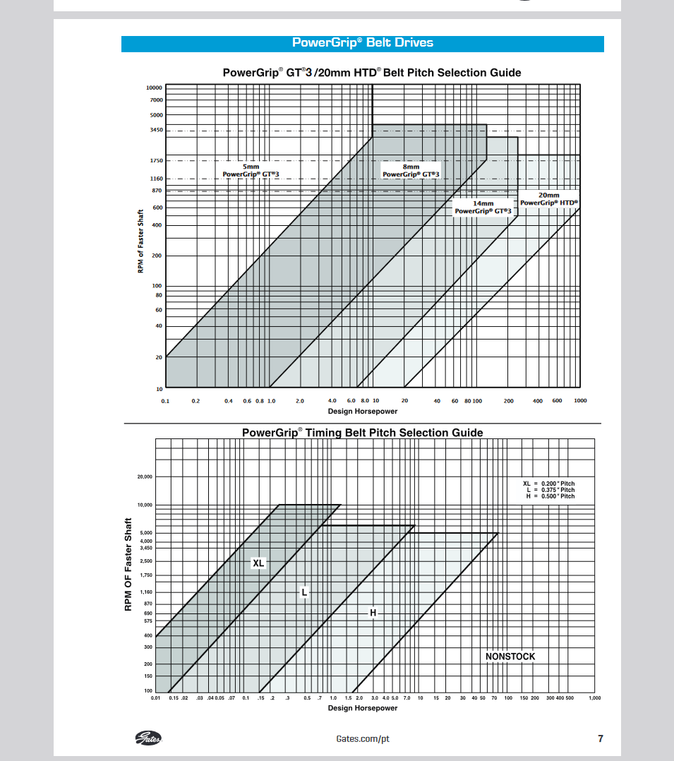

Lets just say we are aiming for 225rpm (120mm/s), that puts us at 1hp rating that takes us from 5mm, to 8mm.
Since that is a different chart and we are not using real gates belts we should derate that a bit. In my mind we are nowhere near 1hp but with all the accelerations I would assume we actually do hit it at some point so 9mm plays it safe, meaning longer life since we do not drive it to the end of it rated constantly.

I think, Assume, wider belt requires slightly more tension to run well. That means harder on the constraining parts. In my mind it makes more sense, you have to bend more material around more parts. Since the belt are rated for a specific tension, no matter the width, that means you can handle a higher load but have to move is slower. If you look at that table for a given load and increase the speed you decrease the belt width. So because tension is set to equal for all widths, narrower delivers more pulley contact (bends further around and makes slightly more contact with more teeth) so you can maintain contact at a higher speed as the forces are trying to fling the belt away from the drive teeth.
