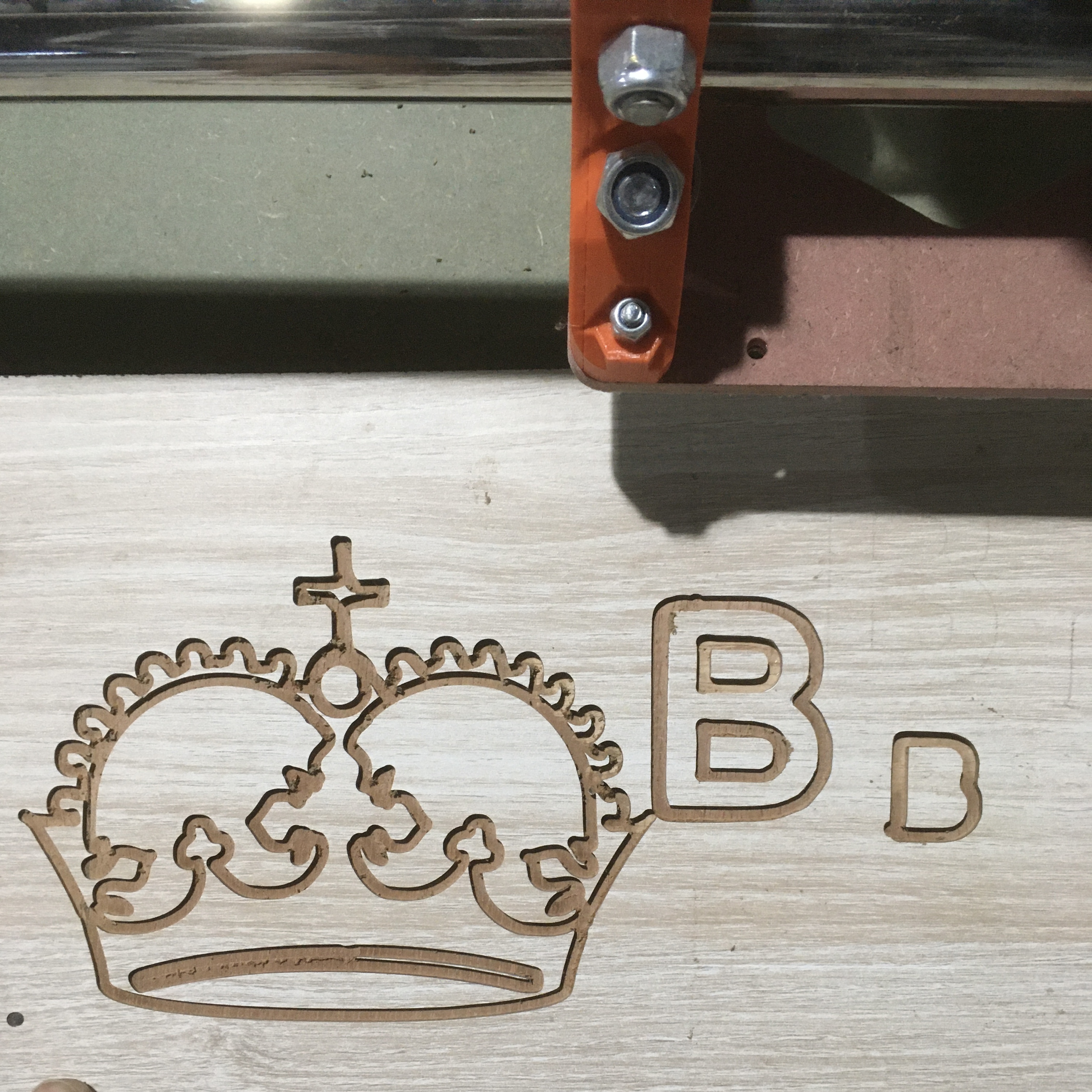

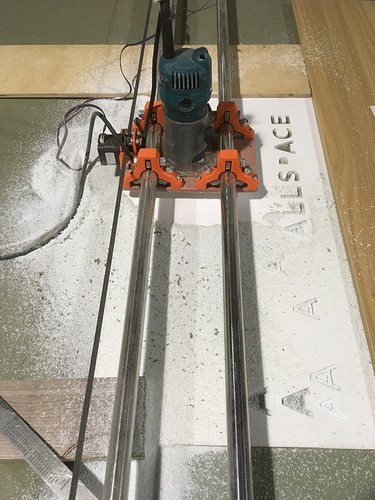

Hey, so I got the machine to work but there are certain quality issues. As you can see I have attached the test file, the crown is the same premade file that Ryan has uploaded, I ran it with a router, it has quality issues. Also, I tried to mill a letter but at times the curves mill as lines and even the lines are not straight. Is this a build issue or software issue? I used martin’s post processor in fusion 360 for the gcode and Guffy’s post processor shows invalid in fusion 360. Maybe an update issue.
Congrsts on getting it going, now on to the next learning and tweaking phase. Don’t worry though it’s all part of the process for most of us.
This is a build issue. Could be squareness, might be slipping grub screws too but start with checks of the build and bolts and things.
A picture of your complete build is super helpful so we can look for common build issues.
The crown looks pretty good but there is definitely something off a bit. Your left right axis seems to be the problem area. So loose or tight belt, most likely loose pulley grub screw.
