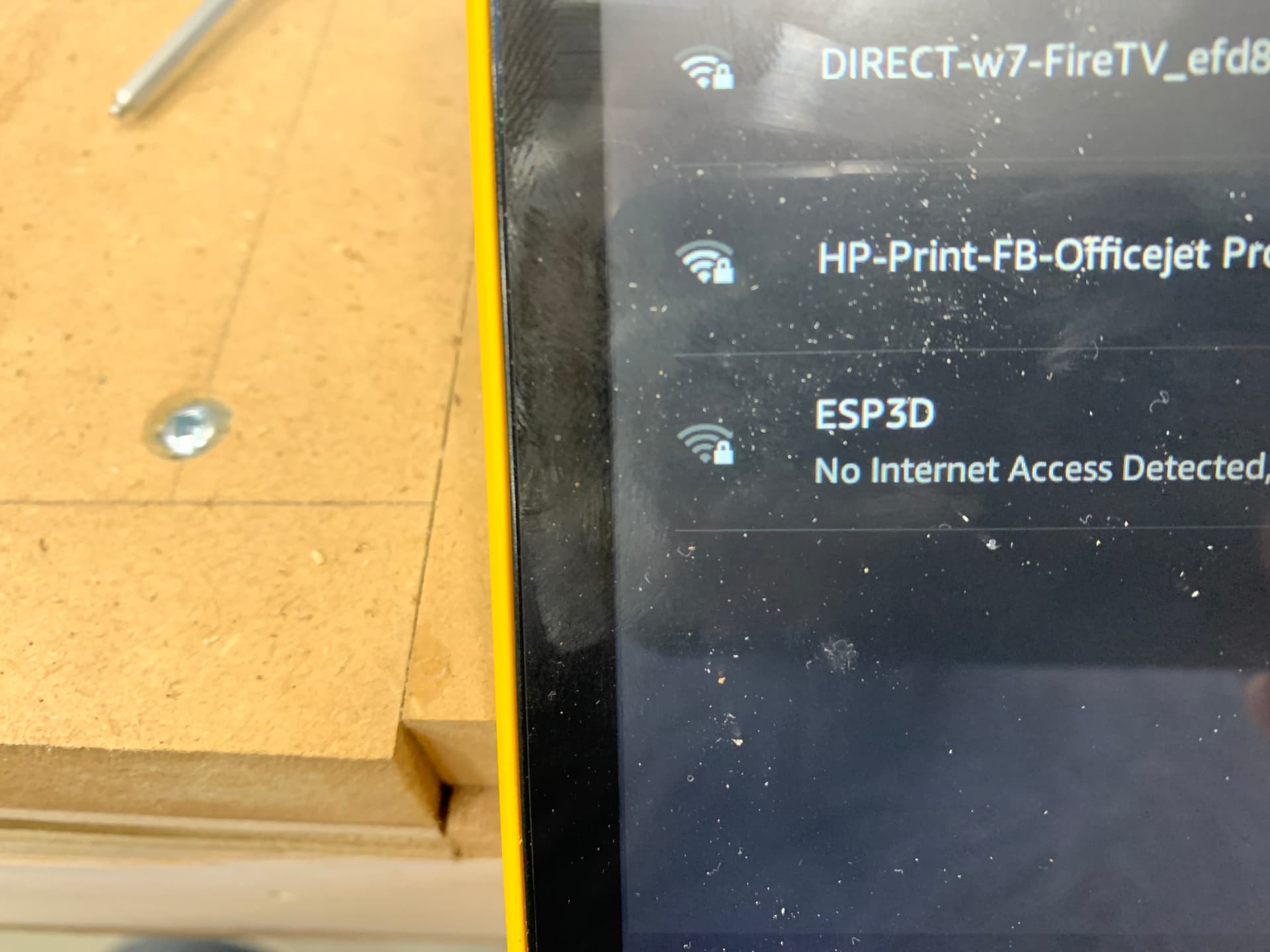

So I upgraded to 515 firmware, and installed the chip. Checked for SSID, and It came up as ESP3D.
I was expecting the V1 CNC Control SSID
Password 12345678
I get the interface, but zero control of the LR3
I can still control it using the TFT (black cable only, greys still unplugged)
Any ideas?
And for some reason, it’s no longer broadcasting wifi
It is broadcasting ESP3D ssid but it doesn’t route any internet access, this is normal.
You can also configure your router wifi so it will be part of your usual network, when doing that ESP3D ssid will disapear as it only serves/appears when it is not joined to an existing wifi.
Once joined you might need to discover its IP address to connect to it, your router admin page/cx listing should help you for that.
I would advise you to create a permanente dhcp reservation for it so it can always retrieve the same IP address or try with http://esp3d.local/ (only work if mDNS is available)
For machine control, try to get reconnect then check for bauds rate, maybe 250000
I could connect to the ESP3D SSID and saw the page, but yes- machine control didn’t work
Now- I can’t even see the wifi. Been trying for 45 minutes, several power cycles in both the board and my tablet. Nothing
The second picture is the wifi connections that were available on my tablet, but ESP3D no longer comes up in ‘active connections’
Is there a way to reset these to default- bridging pins or something?
I just edited my post, it might means your esp01 joined well your usual wifi if you provide its correct ssid and password
I didn’t, but it did, lol
Thanks for the help!
I went into the settings and changed the client wifi mode to a static IP and changed baud rate to 250000
Works perfectly.

Baud rate was set to 115200
But I set it to 25000 and now it’s running perfectly

No worries- it’s all sorted. I left it broadcasting as ESP3D, but added my SSID and put it in client mode. I then assigned a static IP to that network and can now log into it via browser from my home wifi.
Changing the baud to 25250 fixed up the controls, and I even threw a webcam on there and was able to watch the lr3 move using keyboard command (arrow keys) from my office 2 floors up.
