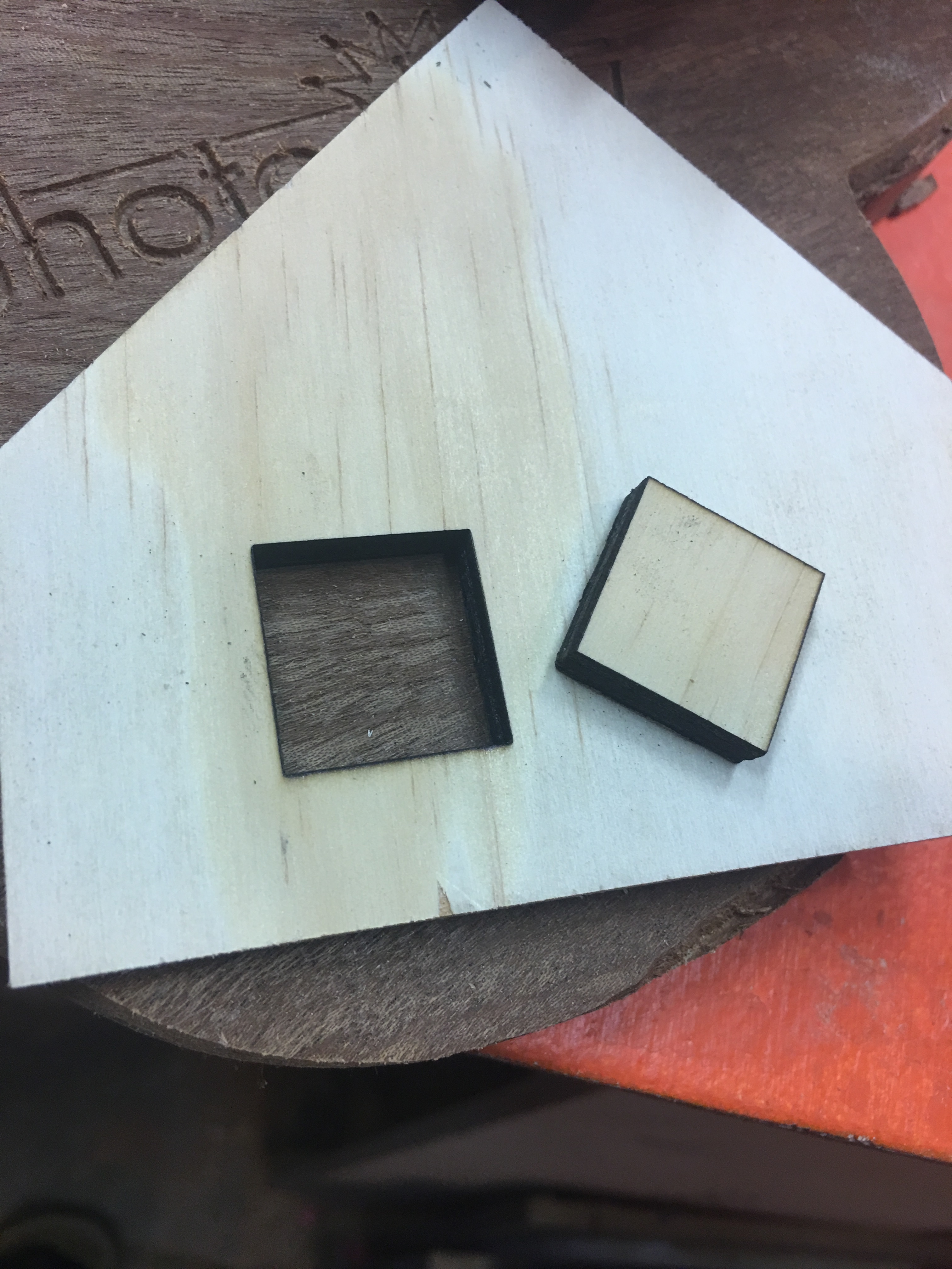

What’s the material? Is that plywood? What’s the thickness?
I really need to do more work with my little diode laser. So far I’ve gotten a few good etches, but haven’t tried cutting anything.

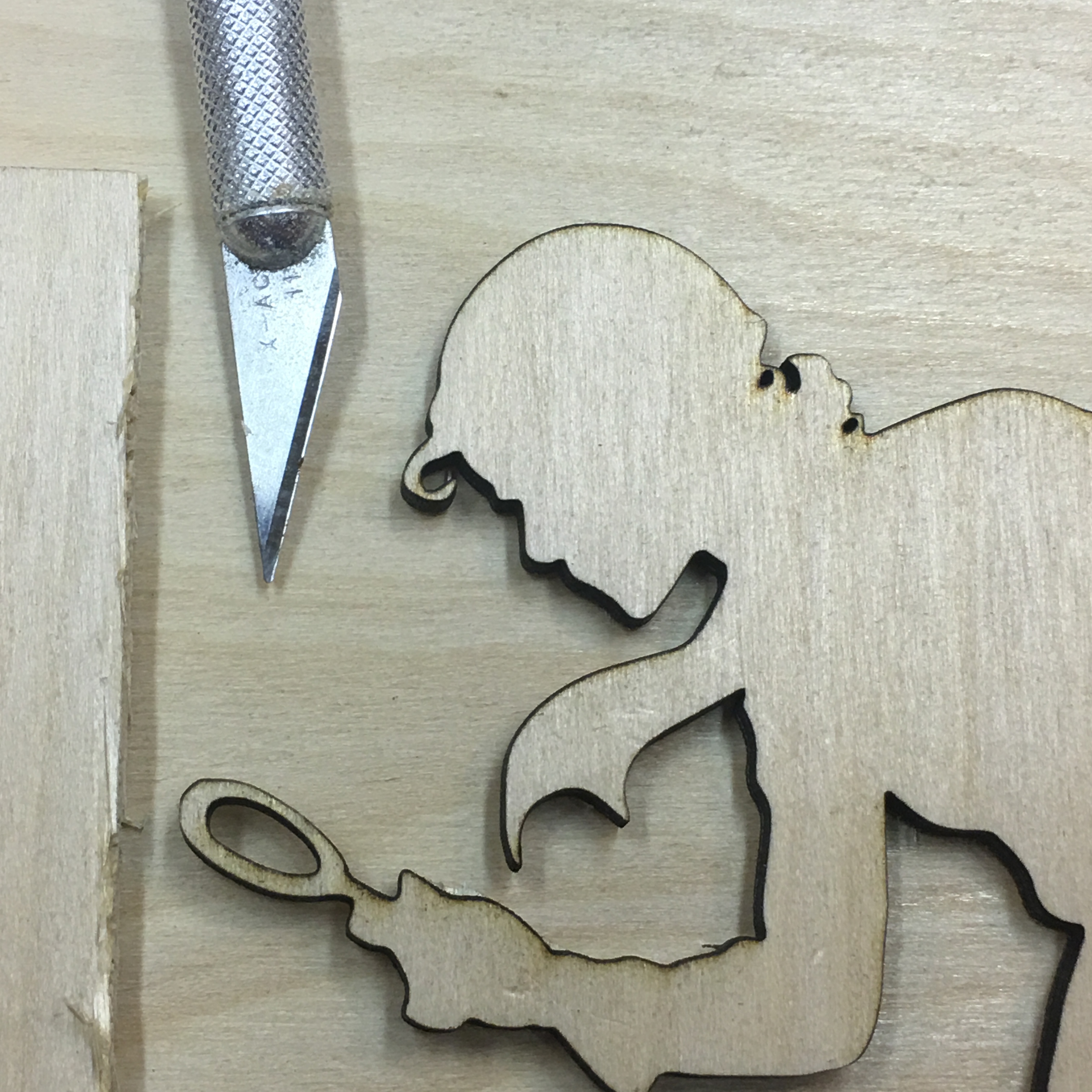

Up here (Canada) they call it rotary mahogany. It’s got thin veneer plys on the outside and some core inside. I’ve been meaning to delaminate a piece to see if the core is a natural wood core or some sort of man made particle core. In any case it 1/8 thick. I also had some birch ply laying around. It’s the same makeup - three plys with a thicker core than outer layers. Cut through in about 17-20 passes at 2mm/s!
The Nancy Drew pieces are the 1/8 material and it took six tries to get two clean cuts. Seems the woods have variance understandably. Or maybe it is where the laser couldn’t pass clear through because of the supports I had under the materials (fender washers).
Ok. We have similar plywood around here too. 1/8" thick is pretty good for the smaller diode lasers from what I’ve read. I’ll have to give it another shot, although I doubt my Chineese 3.3 laser really puts out a full 3.3.
Nancy Drew? That first image had me thinking Fred from Scooby Doo, complete with ascot… But then the last image is certainly more Daphne, ergo: Nancy Drew. :smiley:

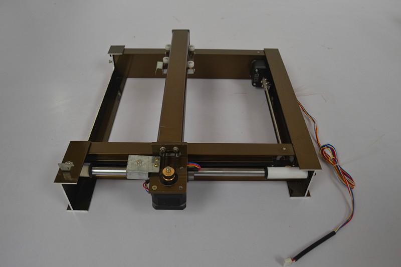

I’m back in laser dreaming over here. I just saw a multi purpose carriage assembly on AliExpress that used one of those steppers with a through-axle. I’m not sure what the proper term is. Anyway - wouldn’t this solve the fear of having two steppers on the y axis? I imagine I need to make sure it’s a stronger stepper?
Seems like a winning discovery to me, no? See the stepper setup on the right side in the pic.
This looks exactly like the frame inside my K40 40w laser, so yup :wink:
So you have only one stepper driving each axis then? (Just confirming).
What size steppers are in there, do you happen to know?
