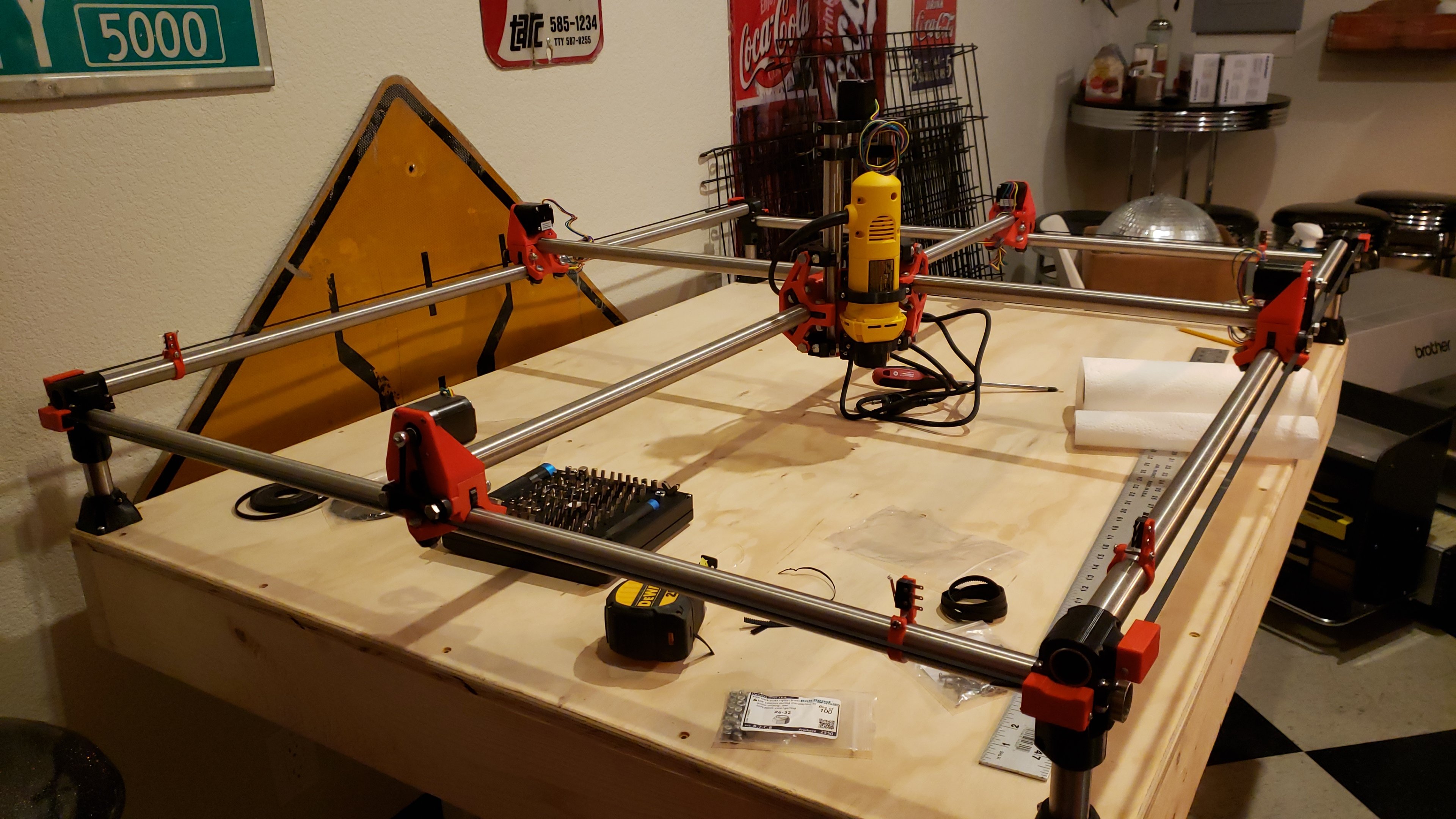

Started a new build a few weeks back. Going well. About ready to hook up and test electronics. A Big thanks to Ryan and his design. Building with 1" stsinless tubing and is working great…
That’s a big build, can’t wait to see some projects coming off of it!

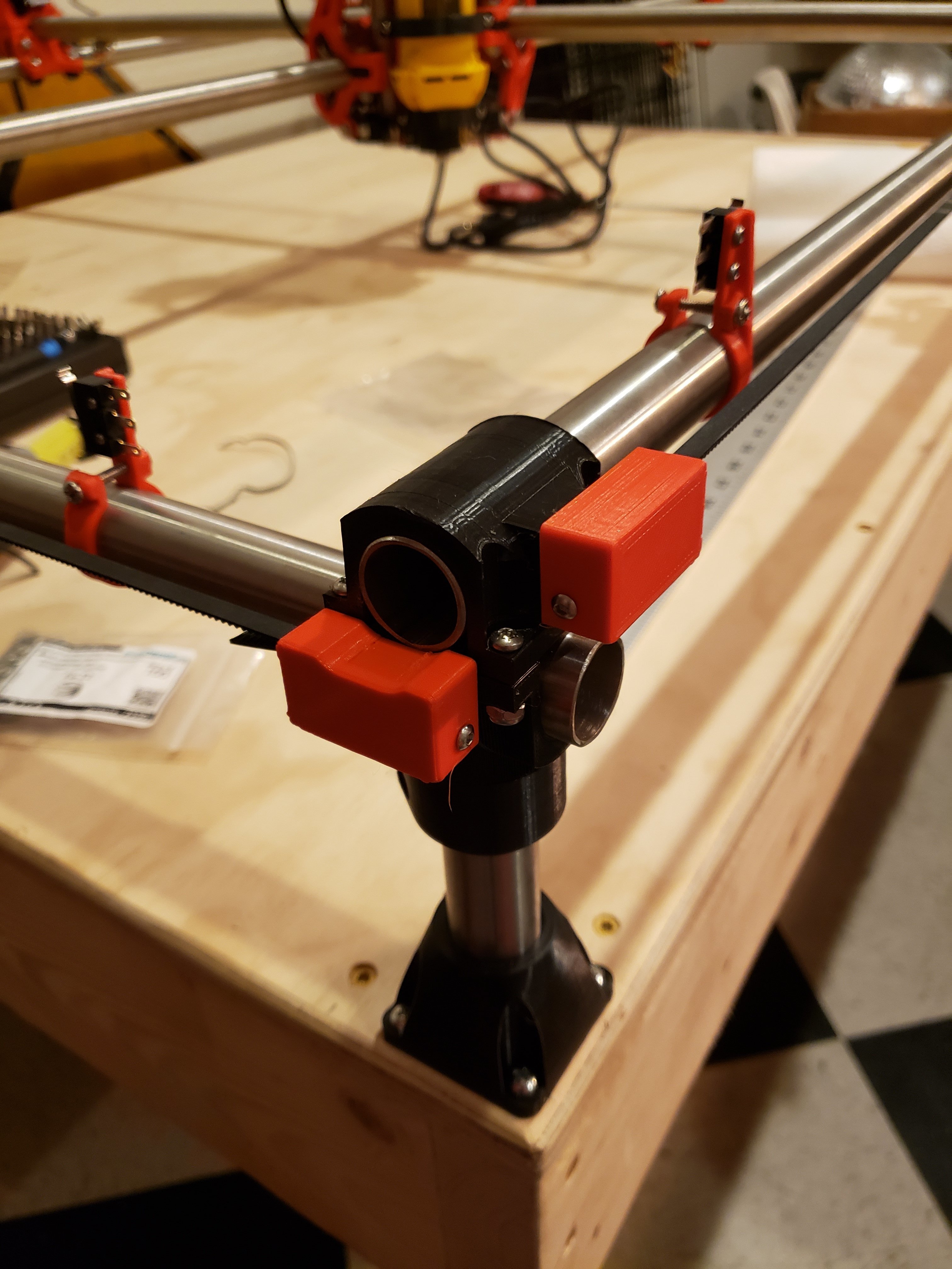

3x4 printed using PLA+ No reprints and everything fits like a glove so far… about to go down and test fire the controller and see if its going to move under it’s own power. still planning supports on the long axis and waiting on a superPID to get here this week.
only thing left is to get the t-tracks installed and waste boards mounted. then dial in the Laser raster “nonsense” everything else is running good! The superPID is running good and the JTech laser is mounted via the magnet mount so it can be removed during CNC operation.
I’ve started a 3’x3’ build with 1" SS tube…man, it’s hard to drill thru. :hole:
Do you mind sharing the links for the control box and the belt tensioners?
Sorry Missed this,
Control box - https://www.thingiverse.com/thing:3400866
Tensioners - https://www.thingiverse.com/thing:3358973
