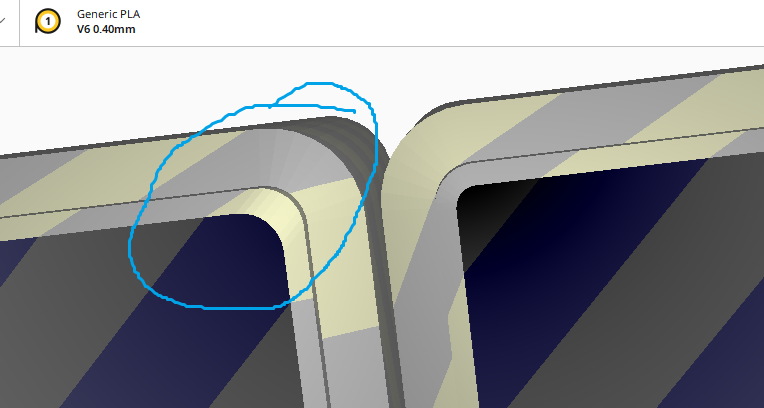

Thoughts on minor edit to make gridfinity printed parts more compatible with base plates that are CNC pocket milled using 1/4" bit? This small deviation from the official Zack design would allow base plates to be milled faster/cleaner than using 1/8" bits currently needed.
e.g. Round the base pad’s lowest corners slightly to 3.175mm radius instead of 1.6mm…
Submitted rough pull request conveying jist. Cheers!
