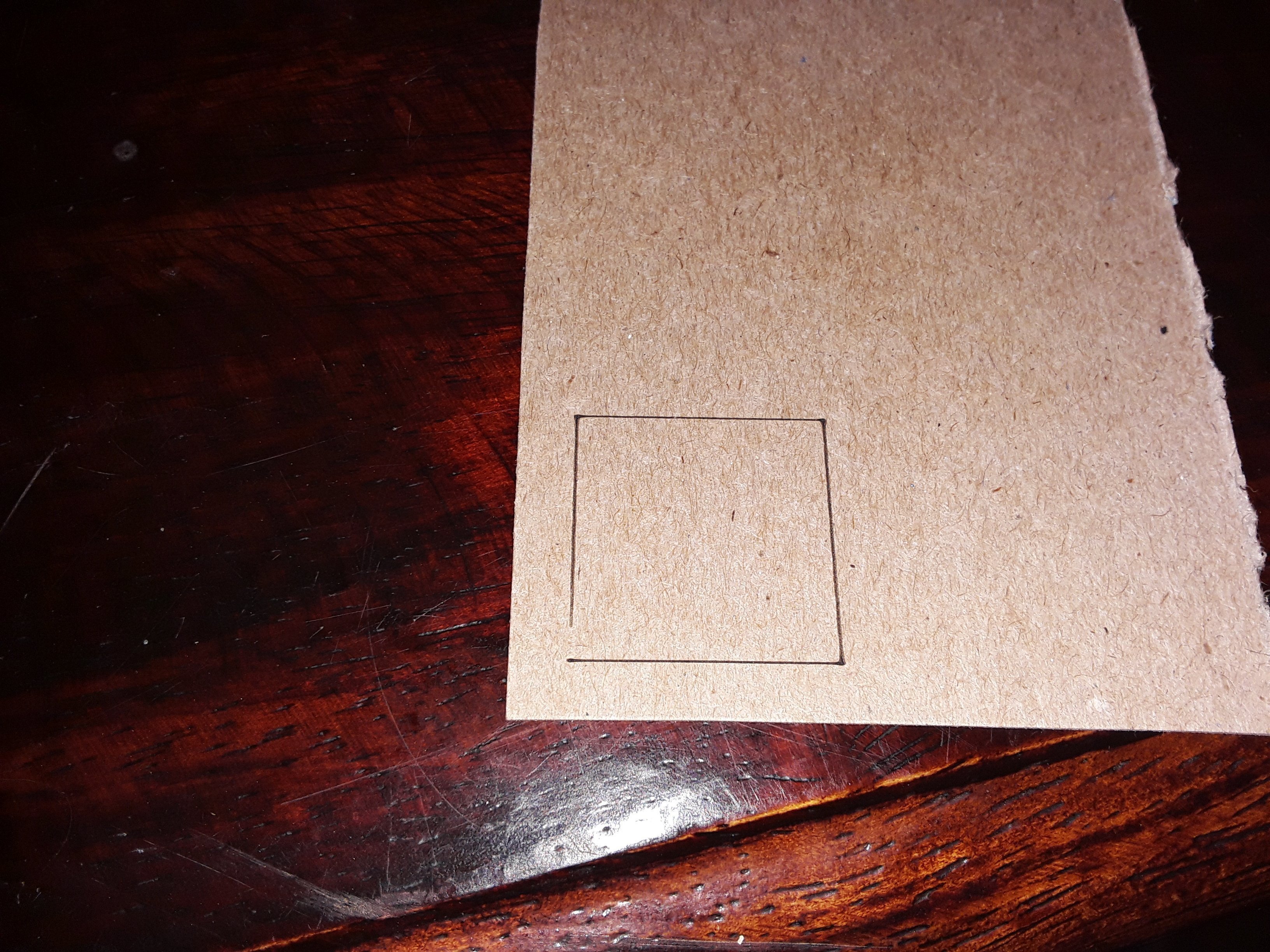

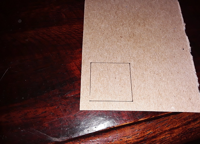

OK… just got back from spending a few quality hours with my daughter… what fun! We’ve been learning how to design and engrave/cut custom designed earrings and pendants. The CNC stuff is all new to her but she’s picked up on it all very quickly :slight_smile:
As expected, the burns from that simple 25mm square gcode file were bad on the little Grbl machine.
[attachment file=120323]
The problem, I believe, is with the beginning of the burn… the 3 leftmost squares are burned in one orientation, the rightmost with the workpiece flipped. The cut starts in bottom-left corner and proceed “north” with a delay before burning actually starts. It then continues clock-wise and terminates with full burn right up to bottom corner, where the cut began.

Whatever it is, it’s extremely consistent.
Based on the images, it’s off for about 15% of the length of one side. The feed rate is 1000mm/min, and the length of the side is 25mm.
So my guess is you need to dwell for close to 0.2s. I think that’s a G4 P200, but it should be easy to tell if that’s way more than 0.2s.

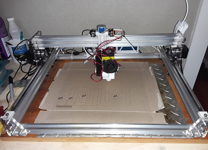

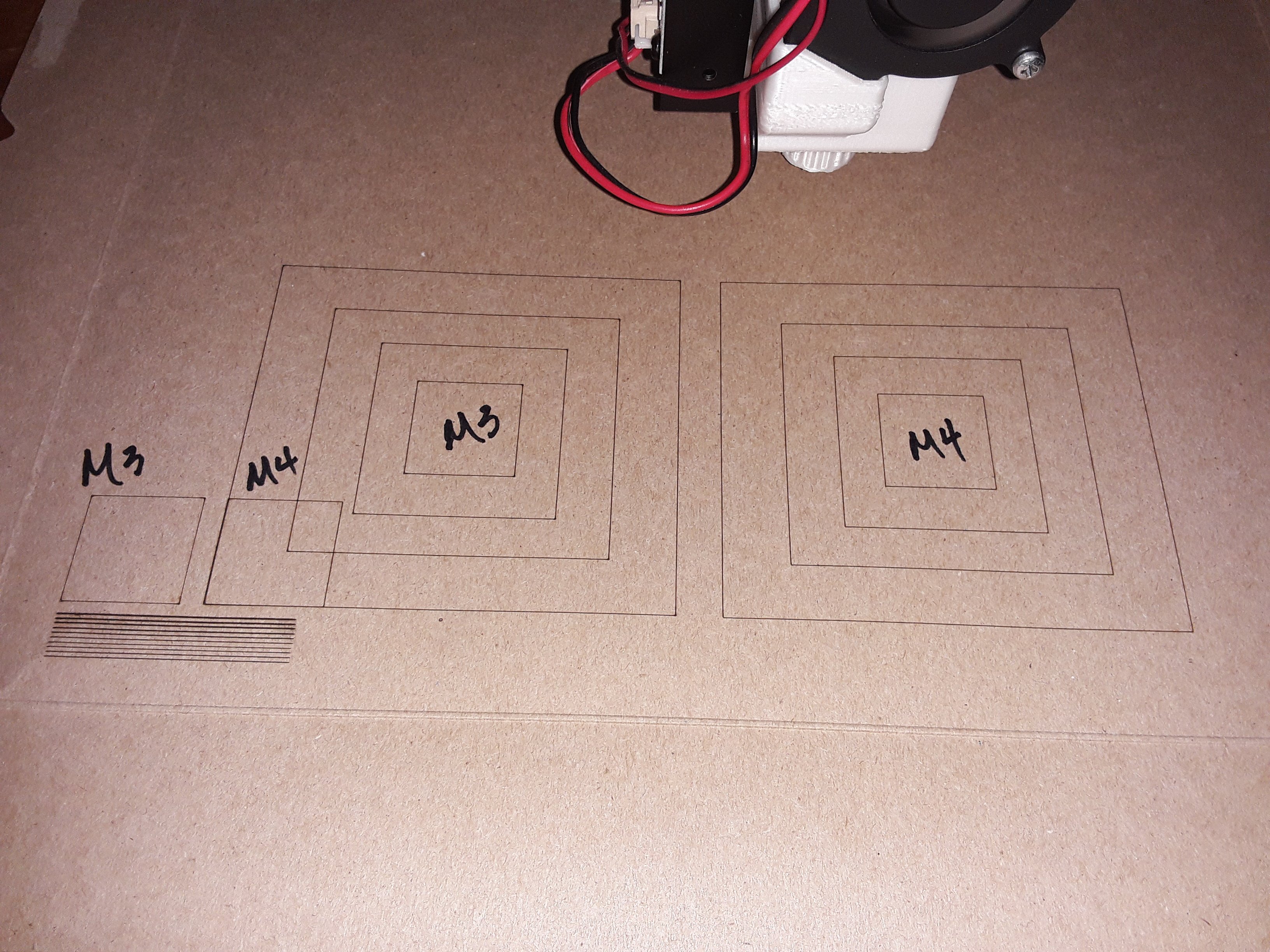

NOW I’m really confused. I went to the Openbuilds site and used their online OpenbuildsCAM to create some gcode for the same 25mm square… and got the same crappy result.
[attachment file=120338]
Don’t remember how to insert inline code, so have attached the file. It can’t get any simpler.
[attachment file=120339]
It’s easy to believe that my little machine could be at fault… but the LB developer would never have seen cause to add an “Overcut” feature if it hasn’t been observed elsewhere. So I really don’t know what’s going on…
I’m pretty sure the “cut-through” function adds in the delay you are advocating trying… and I’ve tried that. And I think that is primarily to allow time for the burn to propagate all the way to the bottom of thicker material before moving forward. But here we’re really not interested in burning through the material… we’re only asking the beam to get started before movement begins. And it’s not…
I was starting to think LB was at fault… but now I don’t think they are. And I don’t think Grbl is at fault… using 0.9j version. And Marlin doesn’t have a problem with it at all. So, as I said… NOW I AM REALLY CONFUSED :wink:

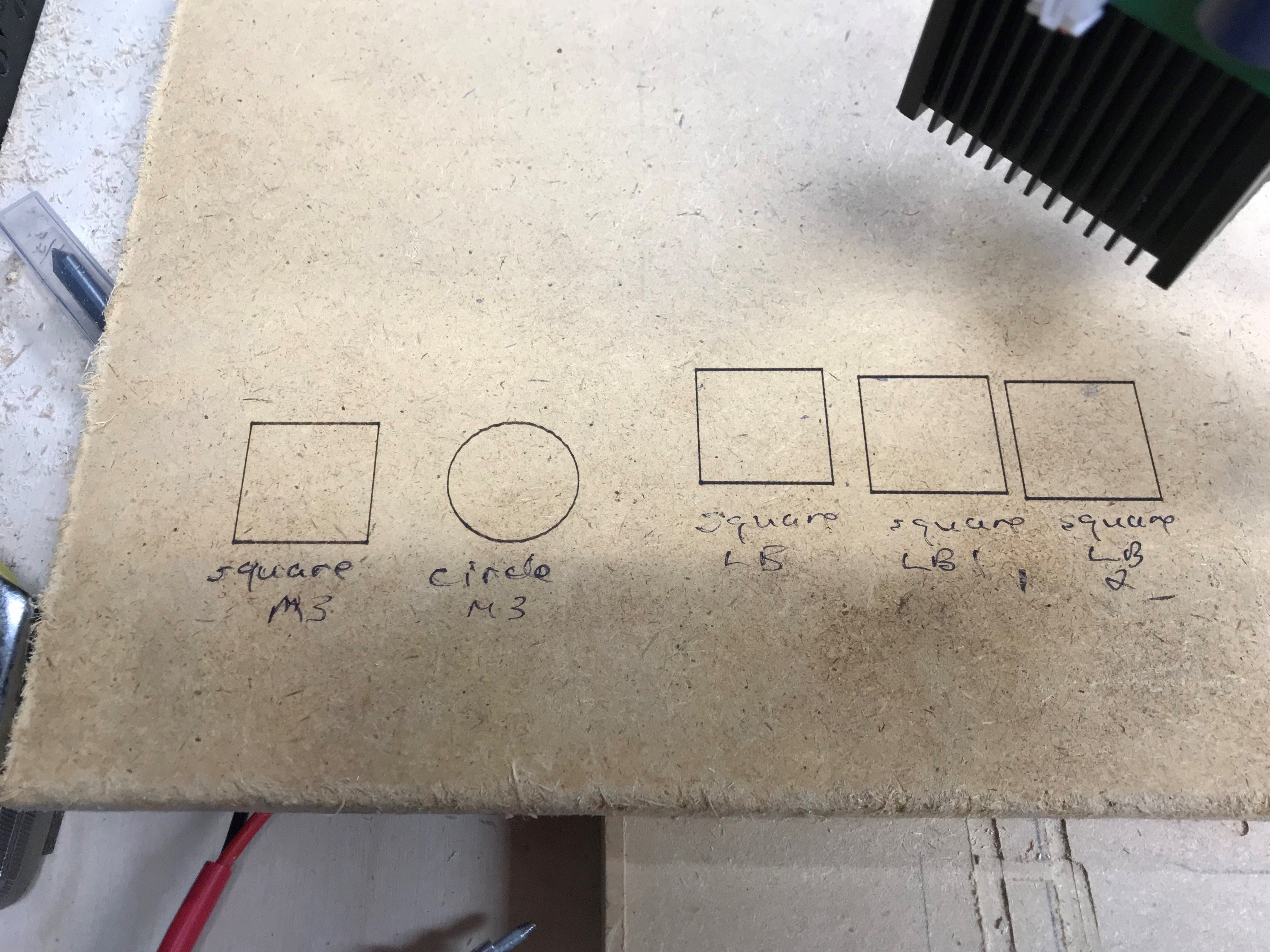

Alright… sucked it up and trudged back up the hill to my daughter’s house. Intended to just run two quick tests… wound up staying a while and trying many more things… enough that I’m getting the sequence of things all mixed up in my head… and having a hard time remembering what I did to what…
In short, your code works… with an appropriate delay. I think you had G4 P200… I think I shortened it to G4 P2.00 and it worked better. Those runs are the 2 on the far right…
[attachment file=120395]

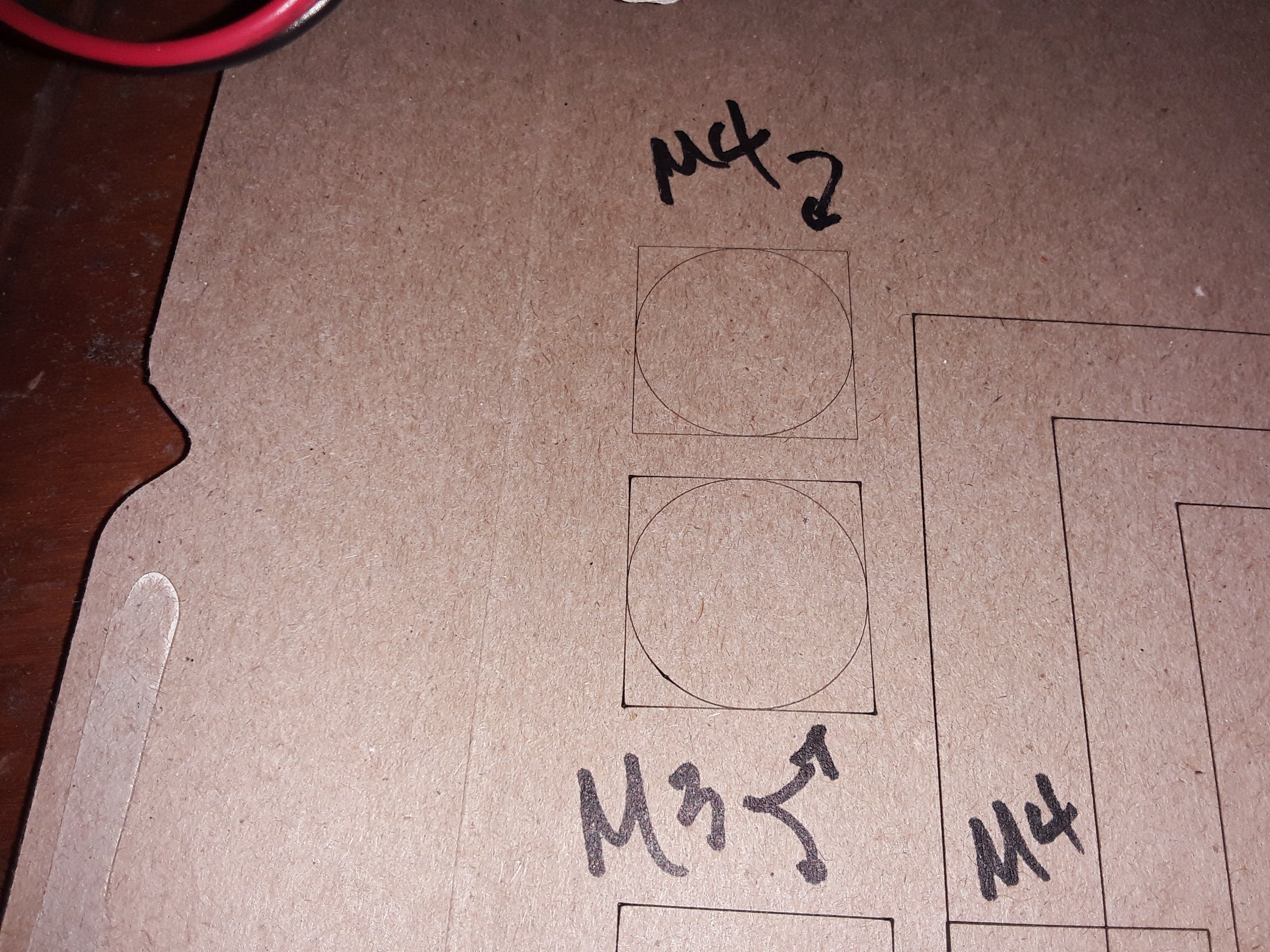

I also remembered trying the cut-through mode and different start pauses… with no success. So looked at the “cut-through” gcode again from earlier in this thread and thought there needed to be an M3 prior to all the cut-through delays. So I edited in that file that first M5 (which really isn’t necessary for this simple test) to be M3… and that worked… those are the left upper-most 2 runs… after that I don’t remember what I did…
But I think we know the required sequence of things… turn on laser, dwell/pause for a time, and then move. But I think LB’s generated gcode is so muddled up and it appears all the G4 dwells put in for cut-through purposes are occurring before the M3 commands they’re supposed to effect… and as a result it doesn’t work.
BTW I did edit the Openbuilds code to change M4 to M3 (grbl 0.9j doesn’t have M4 dynamic laser mode) and remove any/all Z moves (I don’t move Z while lasering…) and it simplified things quite a bit. Also the 4 G1 lines all specified all axes (X, Y, and Z) and I removed the redundant values… leaving only the one changing. So it would up looking much neater and cleaner than it did before the edits… but even the unedited OB code was far cleaner than the LB code. The comments in the OB code were there in the original gcode however… so good on them.
[attachment file=120399]

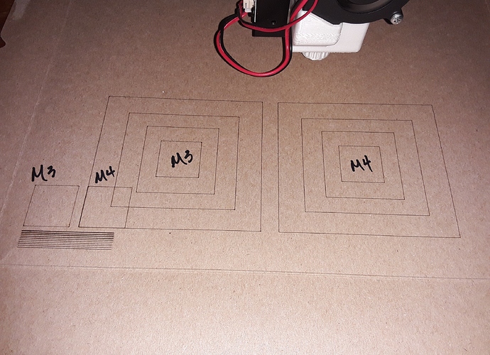

I really don’t know why I’ve been so brain-dead over the past couple of days…
For some reason I didn’t think about seeing what the Jtech laser plugin and Inkscape would do… and I’ve only been using it, almost exclusively, for the past couple of years to generate Marlin gcode. Go figure…
Anyway, fired up Inkscape, drew my rectangle, changed it to “path” type, and called up the JTech extension. Put the M3 and M5 codes for laser start and stop. Initially, added 0 for PowerOn Delay, and generated the gcode. Took a look with text editor… very straightforward and, interestingly, contained “placeholder” G4 P0 statement before and after each M3.
[attachment file=120514]
Tested with 0 delay, same unclosed figure we’ve seen before. Added a 0.2 second delay (JTech site says it’s seconds for Grbl, ms for 3dprinter) and ran fine.
[attachment file=120515]
As this code seems cleaner and works great with the delay, I’m giving in to using Inkscape and laser plugin for now.

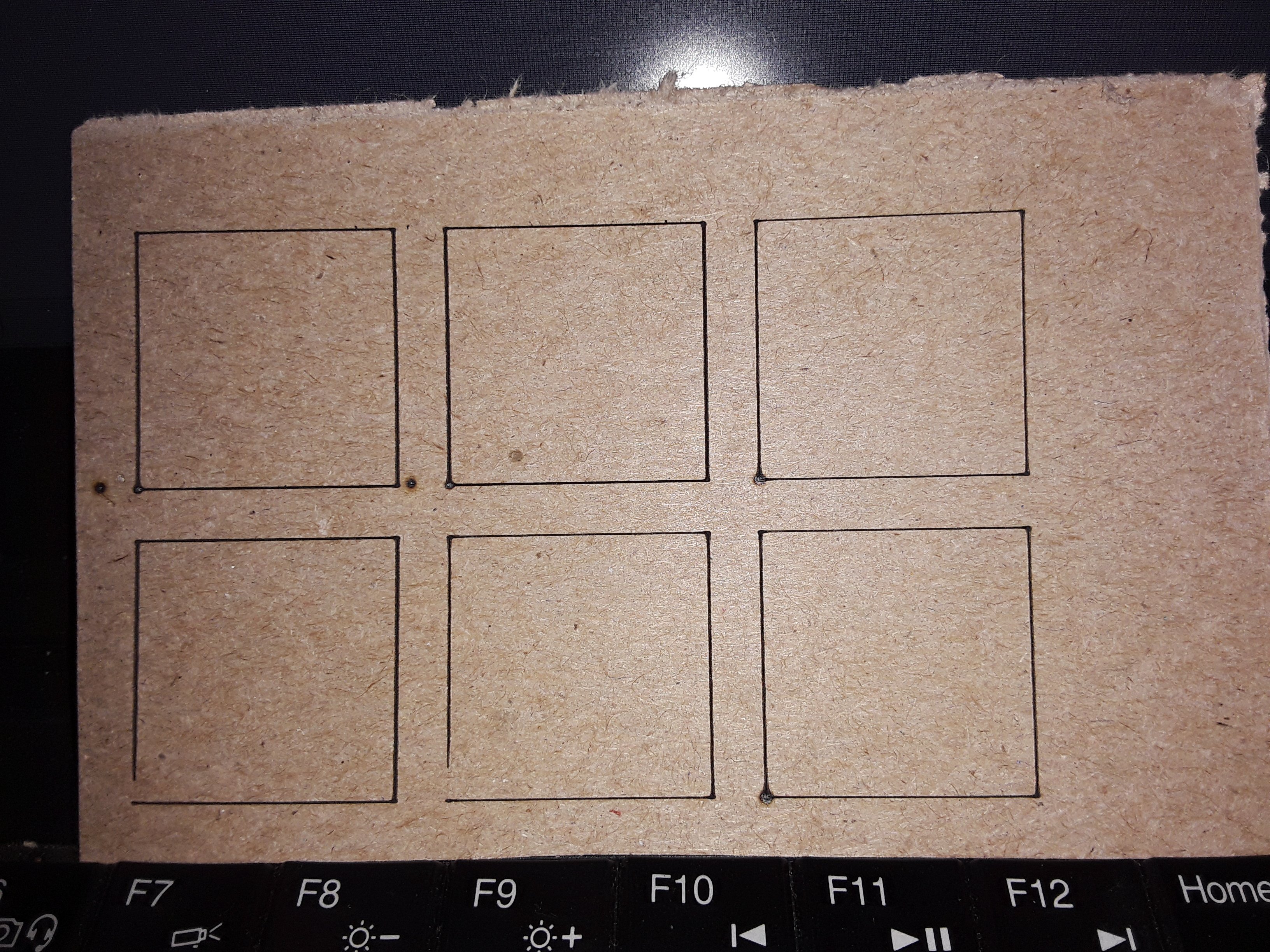

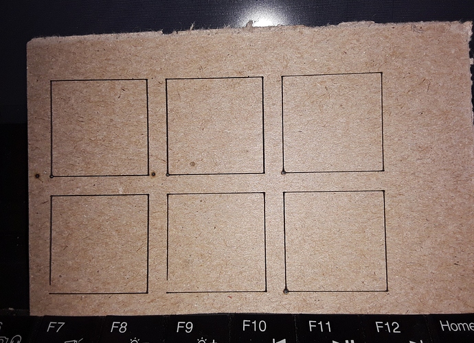

OK. Another data point…
Once I delivered my daughter’s laser engraver… dragged out an Eleksmaker A3 3.5 watt laser machine I had built up before. Got it set up and running with Mega/RAMPS/Marlin – as before – and then went to my stash and found a Uno/CNCshieldV3 board set to play with. Converted the Eleksmaker to a Grbl v1.1h set up… and hooked up the 3.5 watt Banggood laser it had mounted.
What do you know? Confirming JeffH’s findings, this unit seems to handle every test case presented in this thread without difficulty! Not a problem at all with unclosed shapes. Lightburn is fine… Grbl is fine. Apparently the CNC processor/controller and/or laser driver are the culprit(s). Note also the M3 and M4 labels… in Grbl 1.1h laser mode, M3 is the CONSTANT power mode and M4 is the newer DYNAMIC power mode. Look closely at the corners… and note the darker M3 burns whereas the M4 burns are beautiful.
[attachment file=120850]
[attachment file=120851]
[attachment file=120852]
[attachment file=120853]
[attachment file=120854]
I think I’m going to tidy this machine up and swap out my daughter’s machine. She said she prefers Lightburn’s all-in-one, ease of use, features over Inkscape/Jtech and is looking forward to the larger work area of the Eleksmaker machine.
All is right in my world again… and I am at peace :wink:
