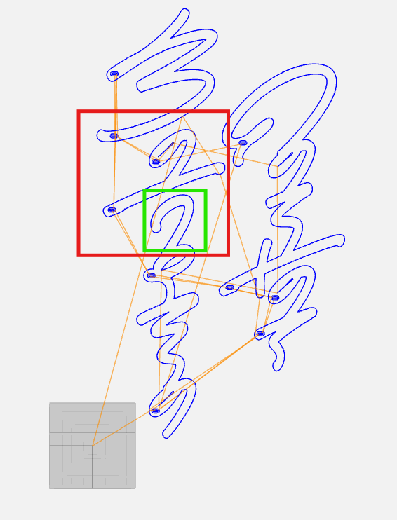

Same project but a different problem now. Have arcs turned off because they were giving me trouble. Added some slots that I needed, redid the CNC program in Estlcam, and ran it.

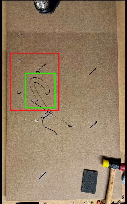

New problem(s): in the middle of the program, the gantry did not lift, skipped the next slots, and started doing the lettering. The real kicker is that it MIRRORED the lettering (see green box). How am I supposed to catch this on an air cut? Originally I thought maybe I was skipping steps but in this case the gcode was just plain wrong. Almost like it started running another program in the middle of this one. Starting to get pretty discouraged :frowning:
The red box is to show where those cuts are in relation to the program

Did it look right in the estlcam preview when you ran it there?
Yep, went over it in detail. No issues.

What makes me think now that it could be the SD card is:
  • it’s a cheap 128mb that came with a different board
  • it my latest gcode, I did “flip” the letters so they are now being cut face down and it’s almost like the card started reading bits from the old program
  • it would explain some of the randomness
I think you were able to repeat my other issue because it was related to poor path tracing and large I and J values. I’ll try getting a new card and running the same exact gcode and see if the problem happens again.

Ran the same exact file again on a known good micro SD card, went without a hitch. 99% sure that my old card was the source of all my weirdness (that and my Inkscape paths). Tossing it in the trash. Thanks all for the help!
