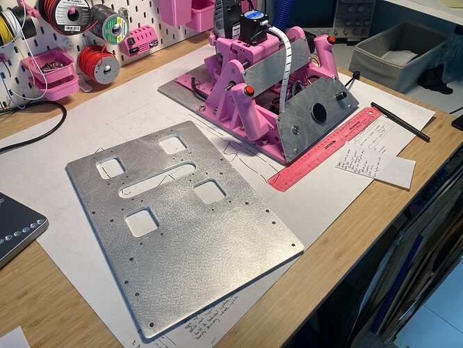

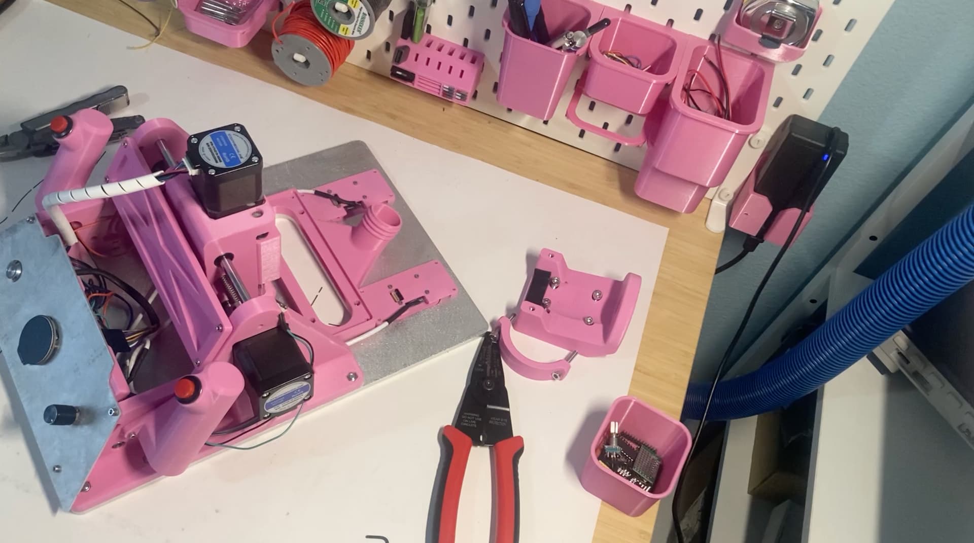

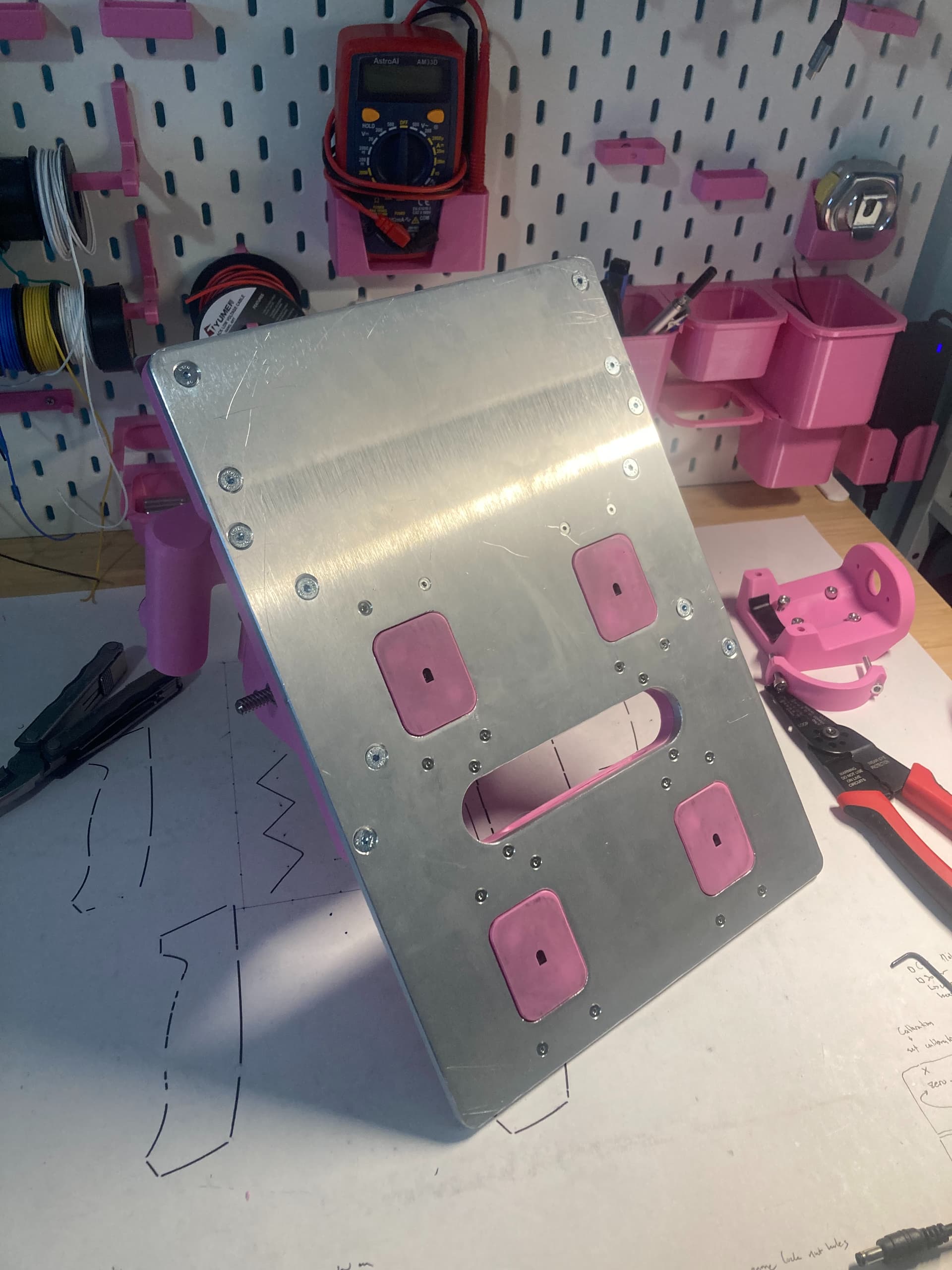

Beta unit looking and feeling a lot better. Countersinks, flat head screws, new PCBs, and a few new printed parts.
