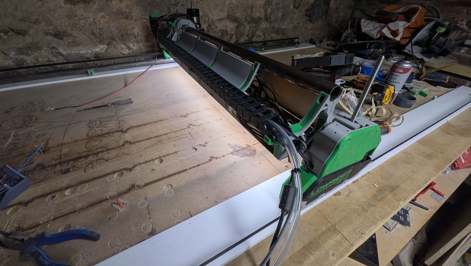

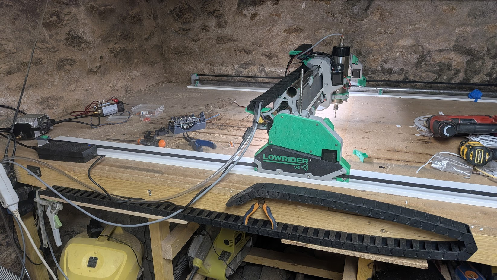

Ok… so I lengthened the drag chain just a bit… feels a lot cleaner now… (xmin cover still printing right now)
Now… How do you guys manage the power cord?
Up until now I had it vaguley bundled and hanging on the side of the table but it kept dragging on the floor and catching things… not great…
How do we feel about a side mounted drag-chain? Doesn’t look too good to me but I’m taking suggestions…
Keeping in mind I have AC power cord, spindle cable, and laser air assist tube to get through…
I’d like to have ceiling-mounted VAC too.. If anyone has good references/topics to share…
Maybe have the cables hang from the ceiling too? kind of like a pulley system with weights?

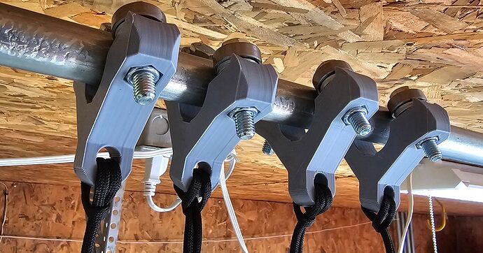

I like @Sascha007 system alot… I have 25mm tube left from the LR3 so it might be a good option
But do Iinstall 2 rails? one for the vac and another one for the cables?
Or a single rail? and route the power cord and all cables from the core back to the controller through the drag chain?
