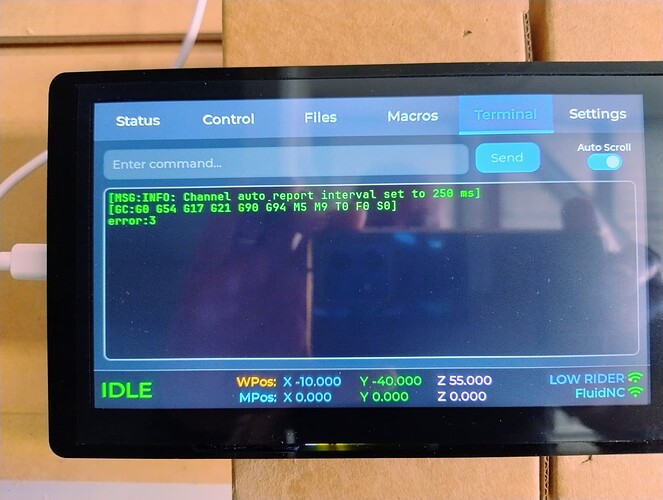

Hi Jason,
Love the concept of this pendant but still having some issues seeing and running cut files on the Jackpot SD card. I have tried the following which may be useful feedback:
  1. Reloaded the pendant with the latest FluidTouch firmware. After doing this the pendant connects to the Jackpot and behaves as before. Unfortunately I still can’t see files on the Jackpot SD card.
  2. I tied moving the pendant right next to the Jackpot in case the signal was weak. This seemed to make no difference.
  3. As you can see in the photo I noticed this error:3 message in the Terminal tab. Perhaps a clue?
  4. Checked the Jackpot SD is working ok by using my laptop to connect to FluidNC. Using this method the files on the SD card are easily visible and operatational.
  5. My final thought (perhaps a silly one?) is my wifi modem shares the same IP address 192.168.0.1 as FluidNC. Could this cause problems?
Sorry to be a pain in the arse!
I was waiting to see your response to this as well. This would have shown exactly what is happening when it tries to load the files.
Error 3 is ā€œInvalid $ statementā€. What version of FluidNC do you have? It is using the $Files/ListGcode command to get the file list. I think you might need at least v3.9.1. It’s not clear to me when that command was added but changes were made during v3.8 (which was not stable for other reasons).
What happens if you run this in the terminal in the WebUI?
$Files/ListGcode=/sd/
I have FluidNC version 3.7.8 so this could be the problem.
After typing $Files/ListGcode=/sd/ in the WebUI terminal I got:
ERROR:3
Grbl ā€˜$’ system command not recognised
Seems I should update my FluidNC to the latest v3.9? If so is there a suggested version that is considered the most stable? At one stage it was suggested here that v3.7.8 was the most stable and recommended version.
Cheers
3.9.9 is the latest suggested version

Hi Jason
Today I built up the courage to upgrade my FluidNC software from v3.7.8 to the recommended 3.9.9.
This solved my files access problem completely. 100% satisfied with the FluidTouch now.
Cheers Andrew
