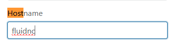

The settings page still shows that it thinks the hostname should be fluidnc

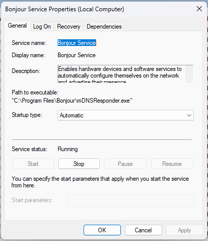

I’m not sure I completely understand this but I think this works via mDNS and Windows has a Bonjour service to handle this:

The dot local address uses mDNS/avahi/bonjour. You used to install it in windows via a mac printer driver. But I don’t know if that’s still the case. That kind of DNS happens between computers on the same network and doesn’t need a server/manager to do that work. The address is almost always <hostname>.local.
The hostname resolution is not done via mDNS. It is usually serviced by your local router. When FluidNC asks for a DHCP address, it also passes its hostname and asks for the DNS servers. The router then keeps a table of these for all the computers it has given addresses to and resolves the hostnames to IPs. If you are in AP mode, then FluidNC is doing all of this itself.
