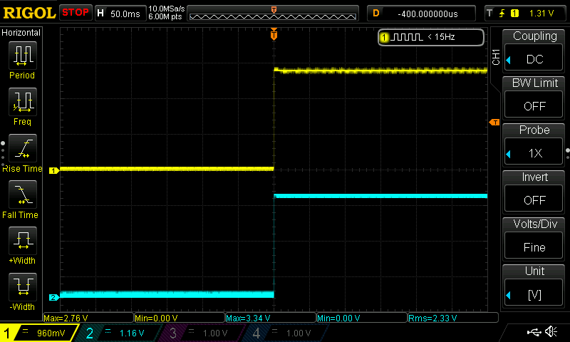

FluidNC not connecting automatically to network

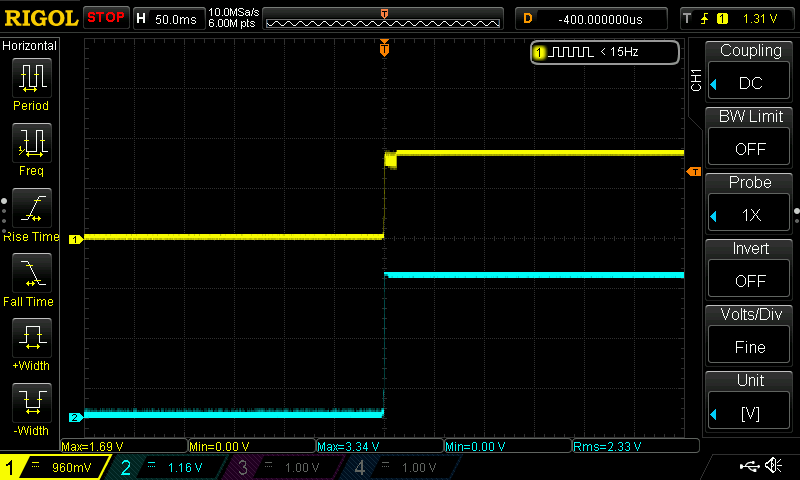

Yellow is the boot pin, Blue is the enable pin. Sorry I changed timescale but nothing interesting seems to be missed.

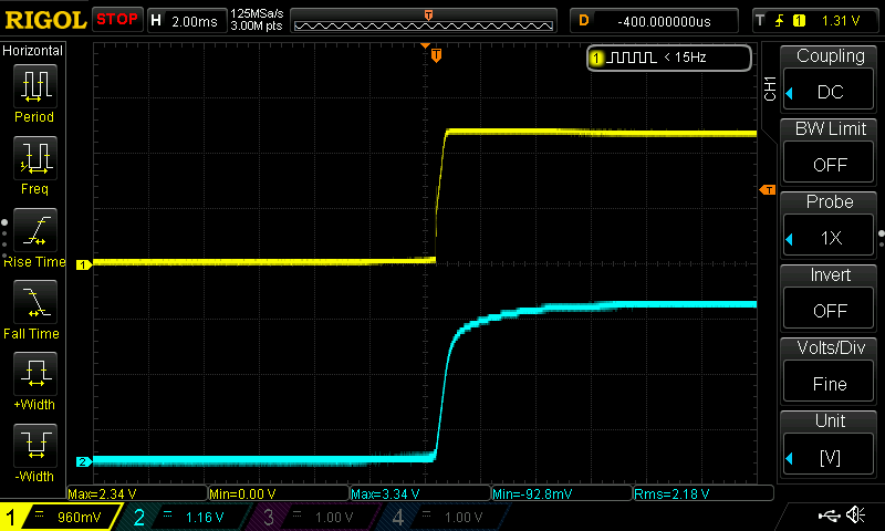

USBC no driver no cap

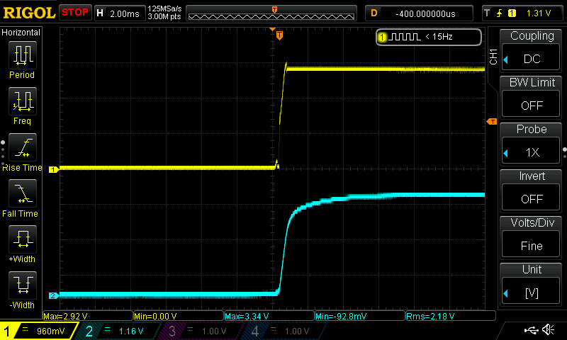

USBC with drivers…way less voltage, not over the threshold

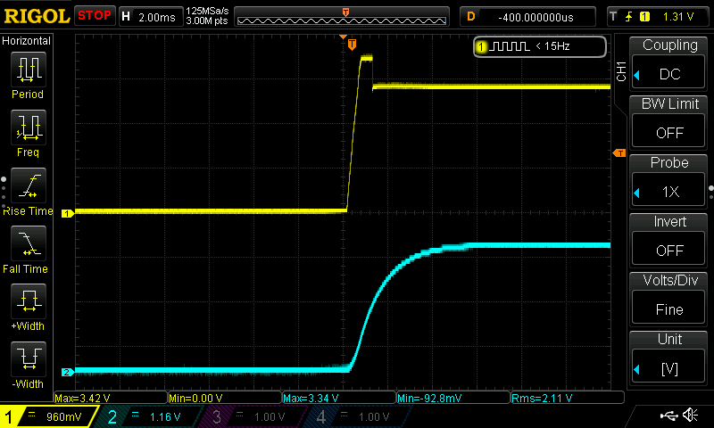

USBC w/cap no drivers. adds a little bump plenty of power.

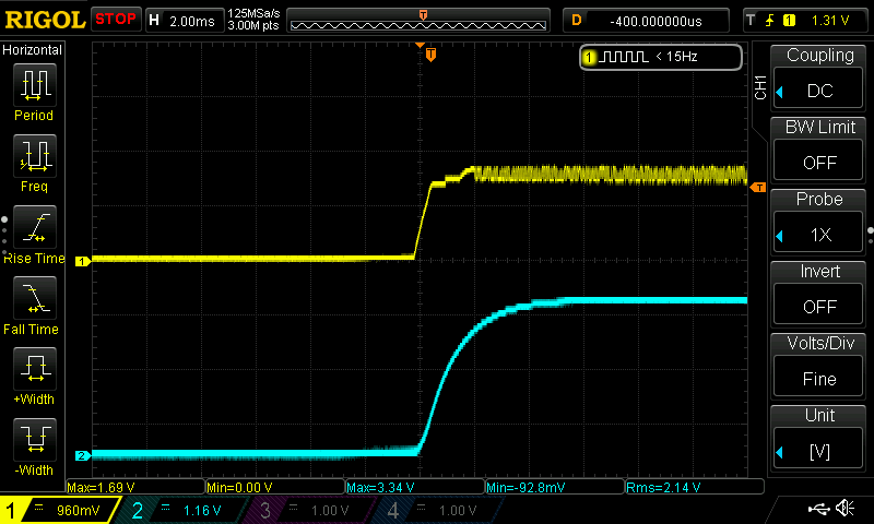

USBC w/cap and drivers, cap makes it worse!
MicroUSB No drivers
MicroUSB Drivers, still a voltage drop (.4v?) but not bad.

Not good! Is the pullup resistor not the correct value? Can you pop one off and measure it with the DMM?
Pullup on the esp32? They are not receptive to fixes so unfortunately it is a waste of time.
Bummer.
For completeness, what happens if you repeat the setup with USB-C, drivers installed, and USB-C cable connected to a host. Then hit reset a bunch of times and grab any reset after the first one.
I’m curious if the levels are different. I bet they are.
Edit to add: One thing I’ll be doing with one of these that I order from you will be mucking about with that resistor.
Edit 2 (Yell at me if this gets tedious :slight_smile: )
What if… Bart is on to something… Why did the ABC stepper drivers need to be behind that funky serial mux? What if, as you add drivers, there’s a cumulative impact that makes this problem worse?
I note that if you draw in the 3v3 pullup on the boot pin inside the ESP32, and added the UARTS on the TMC 2209s, you’d find that while the 2209s aren’t enabled they’re sinking current on those UART pins, acting as a pulldown. The more you have, the more the effect. If your ESP32 has a weak 3v3 power supply and/or a crappy pullup resistor value… no boot. The more drivers you have in parallel, the worse this problem becomes.
The series resistor in the jackpot then is an attempt to kludge that by limiting the pulldown effect while still leaving sufficient drive for the UARTs to work when not at boot time and the BOOT0 GPIO is back to being a UART pin?
That explains it. It just doesn’t explain why it works when fluid term is connected for Keith. I was expecting to see something temporary from the drivers and then have it normalize back above 2.5V.
It doesn’t really matter though, if this fixes it.
I would really rather see that boot pin up much closer to 3.3V. But I haven’t probed those pins. Maybe I flirt with disaster all the time and I never look closely enough.
Can you make the resistor between pin 0 and ST_UART on the JP bigger, so it pulls it down less?
